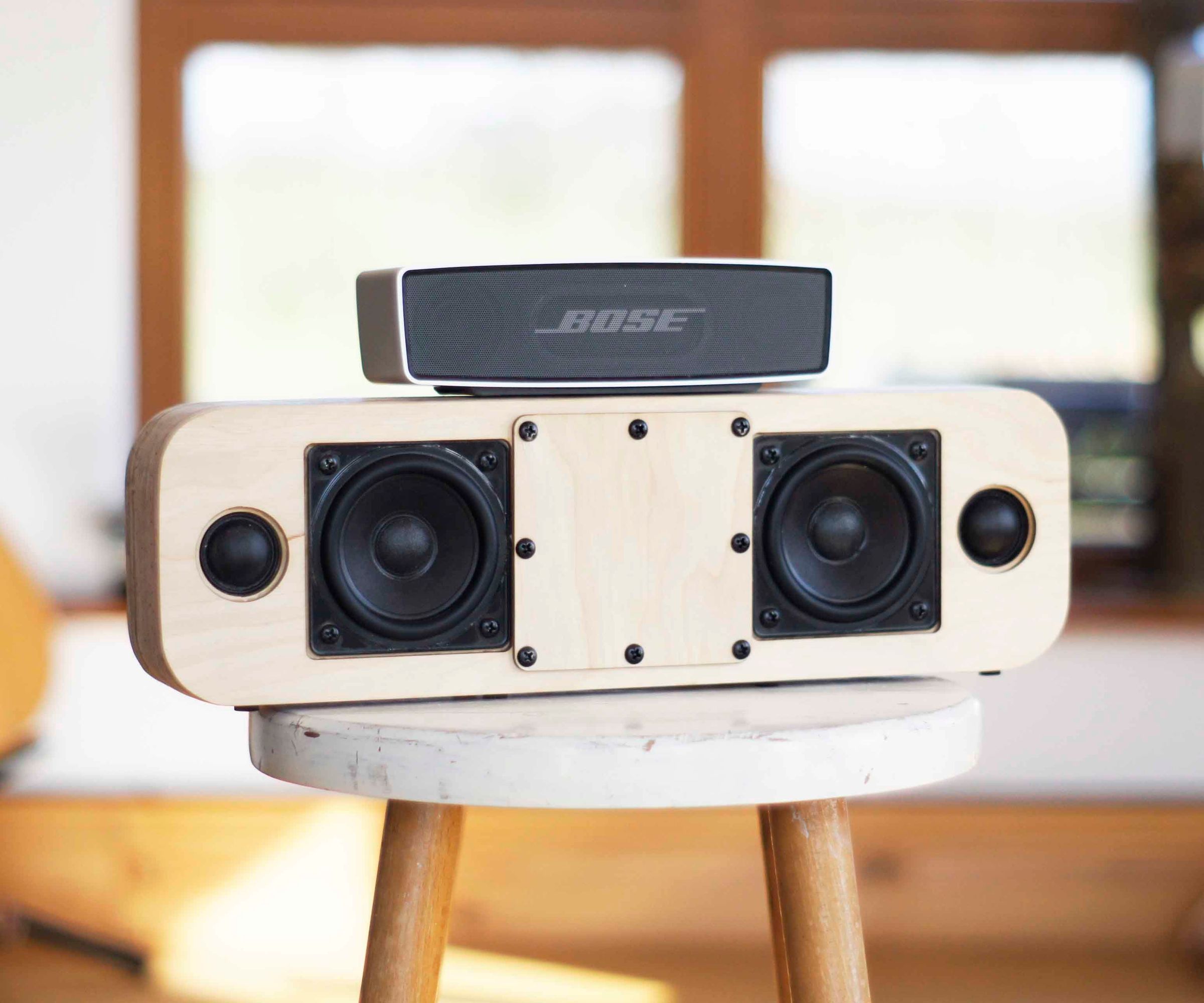

Overall I think this is a great speaker. By using a pre made enclosure (lunch box) you save time and internal space. The shape also looks very professionally done and people often ask me about how on earth I made those perfect curves! It's also a very practical speaker. It fits great in the hand and can resist water quite well compared to some of my other creations.
In terms of sound quality, I think its quite good. It has an insane power output of 30 watts, and the passive radiator really helps extend the lower frequencies. On the other hand, the bass often isn't boomy enough for my liking. An equaliser on your phone helps greatly with this issue. Playing around with different sized lunch boxes would change the sound significantly, so I may have a few more shots at it at a later stage.

Just finishing off this speaker at the moment. Making a clear perspex cover for the front with holes in it as well as finishing off the clear coat on top of the wood. Don't be fooled by the crazy amount of speakers on it, its actually just as small as the blue speaker in this Instructable!
