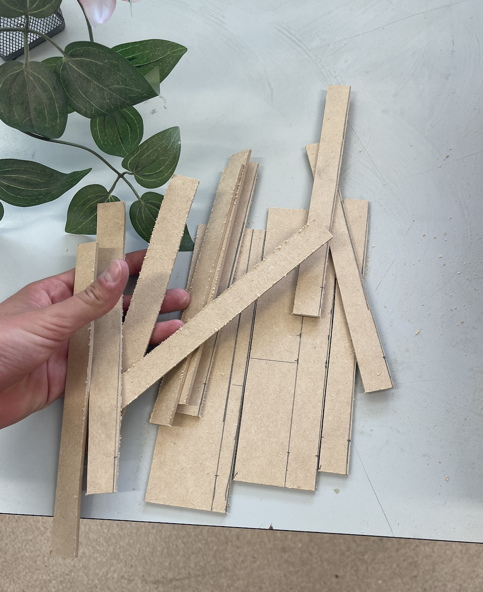

Step 2: Building the Parts (MDF)
This step will guide you through cutting and preparing all the pieces required to assemble the frame for the project.
  1. To start, I transferred my measurements onto MDF and carefully cut out each piece using a scroll saw. Once the rough shapes were ready, I refined them with an oscillating spindle sander to get clean, precise edges. I also prepared two circular base pieces, which serve as the foundation for gluing all the smaller components onto later on.
  2. Make sure to create 3–4 larger blocks in total. Two of these should be sized to hold the speakers securely, and another should be reserved for the switch. These don’t need to be huge, just larger than the thinner blocks that form the ring around the base. I decided to make 20 small pieces in total. These pieces are skinny and are meant to be glued to the circular base.
  3. When drilling the holes for the speakers, measure the speaker’s radius to determine the area to drill so the right portion of the speaker is visible and sits correctly.
  4. Cut three equal-sized MDF pieces and drill a snug circular hole in the center. This will later be used to hold the motor head upright so the top stand can spin smoothly. Ensure the motor mount wood pieces are slightly shorter than the smaller blocks so the stand stays level and doesn’t rise too high when everything is assembled.

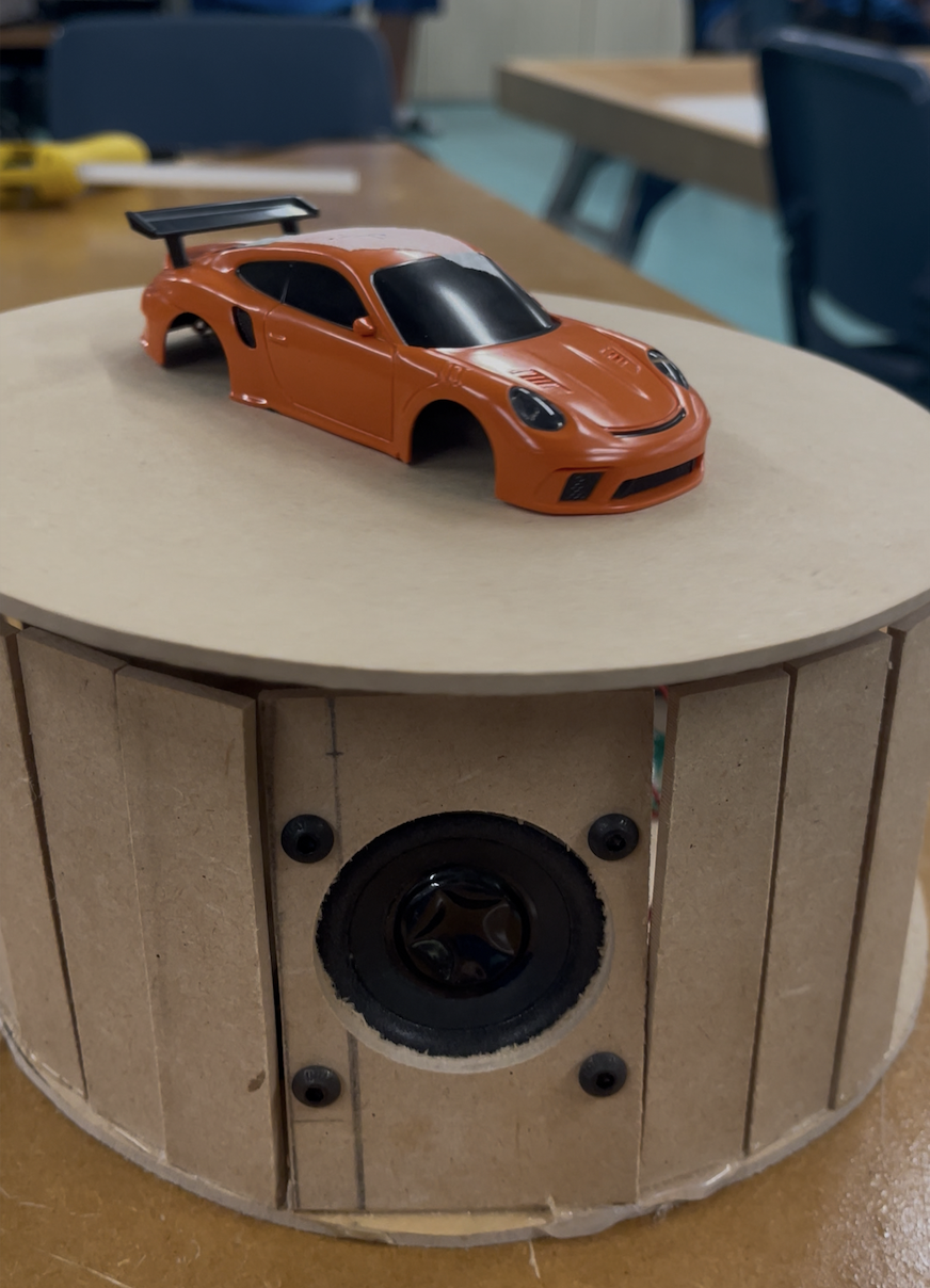

  1. In my design, I used 20 small pieces along with 4 larger blocks. I placed one large block for every five small blocks, which gave the stand a more balanced and aesthetic look. I also positioned the speakers on opposite sides so the sound could project both forward and backward at the same time.
  2. To mount the speakers, take two of the large blocks. Place your speaker on top of the blocks to mark where the screw holes should go. Once you’ve marked the spots, drill four holes in total — aligned with the speaker’s mounting holes. Screw in the screws to ensure that the speakers don't move anymore and are in a fixed position.
  3. Use a hot glue gun (or another strong adhesive) to attach the MDF pieces securely to the circular base at the bottom.
  4. Find the center point of the circular base and place the rotating motor shaft in the center, place the motor mount wood pieces accordingly to assure the rotating motor shaft is centered. Once you have this center point, glue the motor mount pieces to the circular base to secure this position.
  5. Adjust the potentiometer to ensure that the voltage coming through is not too high. To know this, play around with it until the rotating motor shaft spins slowly.
  6. Glue the 3D printed piece to the remaining circle piece, making sure to glue it in the middle.
  7. Place the 3D printed piece onto the rotating motor shaft; it should fit snugly and not wiggle a lot.
Turn on the circuit and enjoy watching your toys spin while listening to your favorite music!
