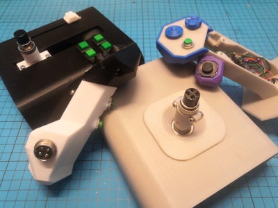

In the first picture you can see some of the basic controls you might use, along with the Arduino Pro Micro microcontroller in the middle. In the bottom right is the ESP32 Dev Kit that you can use if you want bluetooth rather than USB connection while playing.

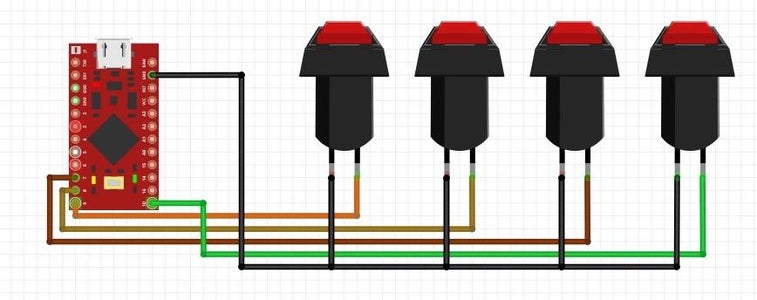

The second picture shows how you would connect momentary switches, of the two pins one will always go to a GND pin on your microcontroller while the other will go to an available numbered pin on your microcontroller. The ground wires all go to the same place so can be daisy chained or each go directly to their destination.

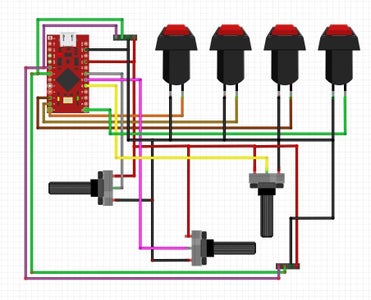

The third picture also shows the connections of 3-pin potentiometers. The two outer pins go to vcc (5v) and GND, it doesn't really matter which way, and the center pin gives the signal which will go to an analog capable pin on the microcontroller. On the Arduino Pro Micro these are pins [4, 6, 8, 9, 10, A0, A1, A2, A3].
