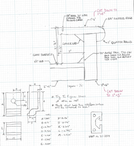

Step 1: Planning
This was my first piece of furniture I made that I did not have some type of Ana White plan to use as a rough guide, so planning was key. I first did many sketches and played with several designs and table top sizes. Once I had a general idea in place, I put those ideas into Revit (an Autodesk 3D design software). From there I was able to create the steps and plans that helped me through the building process.

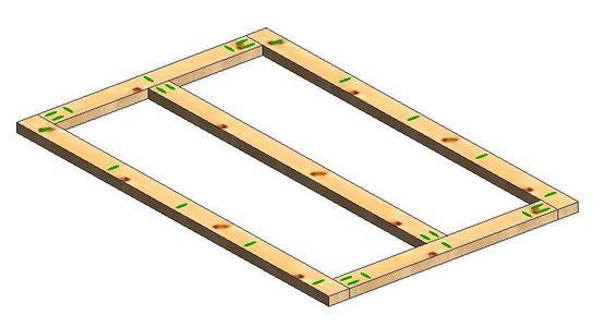

Step 3: Building the Base
After the side rails were constructed, measurements were taken to verify the dimensions of the 2x4s for the base. In running the side rails through the wood planer, the 2x4 dimensions increased slightly (1/16" to 1/8").
First the 2x4 wood was cut down as indicated in the dimensioned plan view (again, + 1/16" to 1/8" as needed). Then the wood was dry-fit in the constructed side rails to ensure there was a good fit
Next, a kreg jig was used at a 1-1/2" setting to place pocket holes as indicated in the plan view for attaching the base pieces together and attaching the base to the side rail.
Finally, the base pieces were screwed together using 2-1/2" pocket hole screws.

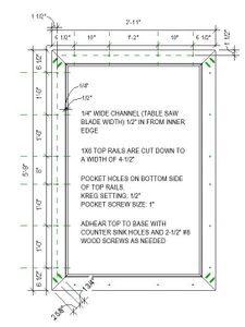

Step 5: Building the Top Rail
Building the top rail was the next step
First, I took the 1x6 pieces of wood for the top rail and ripped down the 6" width (5-1/2") to an actual 4-1/2" width using the table saw.
Next, the table saw blade was lowered to only cut roughly 3/8" into the top rail about 1/2" from the inner side. This relief cut will be for holding cards in the top rail.
The top rails were then cut down to size indicated in the plan view and used miter cuts for joining.
A kreg jig was used at the mitered ends with a 1/2" setting for putting the top rail together.
The top rail was put together using 1" pocket hole screws.
