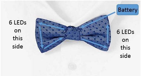

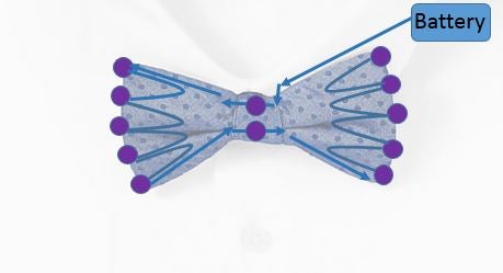

Feed the LED strand through the top of the knot in the center of the bowtie from right to left leaving 6 LEDs on the left side. Feed the remaining 6 LEDs through the bottom of the knot from left to right until all 6 of these LEDs are on the right side. Please see the image below for reference. Once this is complete, slide the LEDs and the wire strands to the inside of the bowtie so they are hidden.
Step 3: Adjust the LED Placement

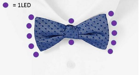

Adjust the LEDs so that the first and seventh LEDs in the strand are placed inside the knot of the bowtie. LEDs 2 through 6 should be placed on the left side and LEDs 8-12 should be placed on the right side.
Step 4: Wire Management
Twist the excess wire between each of the five LEDs on both the left and right side and tuck them into the inside of the bowtie.
