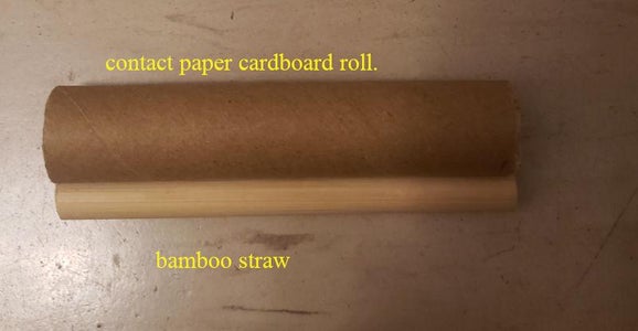

I used some rubber caps from bicycle handlebar cover ends, which I bought from Dollarama, and cardboard tubes left over from contact papers as handles. I really think you should come up with a better idea to make your own handle and head. ;)

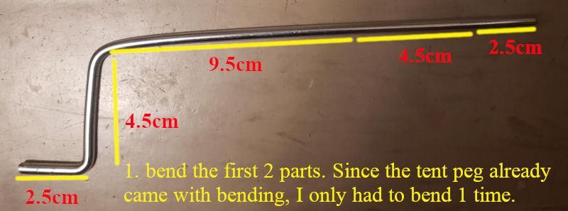

First, mark the steel rod with a marker pen. The Dollarama rod has a length of 23.5 cm. My marks were around 2.5 cm, 4.5 cm, 9.5 cm, 4.5 cm, and 2.5 cm. You can try different ratios to fit your design.
Second, bend the first two parts. Since the tent peg from Dollarama was already bent once, I only had to bend the second part.
In my opinion, bending is the hardest part. Just make sure you bend it as straight as possible. A metal vise is highly suggested. I do not have a metal vise so I bent the the rods between the gaps of balcony walls, I also use a bar clamp for bending some area.

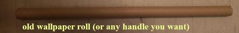

Step 2: Handle

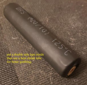

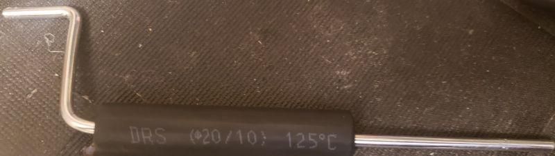

In this step, you will have to create your own handle. Because I do not have the skills and tools to make a nice wooden handle, I made one with a contact paper roll and a bamboo straw. The straw has a 5mm inner diameter and acts like the core, while the roll allows me to grab it. I used hot glue to fix the two ends of the straw to the center of the roll. I did not fill the inside with hot glue.

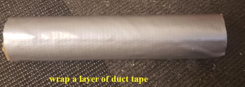

When it cooled down, I added a layer of duct tape to the handle to make it more durable. I then added some double-sided tape, followed by a heat shrink tube for better grip.
Lastly, I inserted the handle onto the steel rod. Just make sure the length of the handle is correct, or you might have problems bending it later.

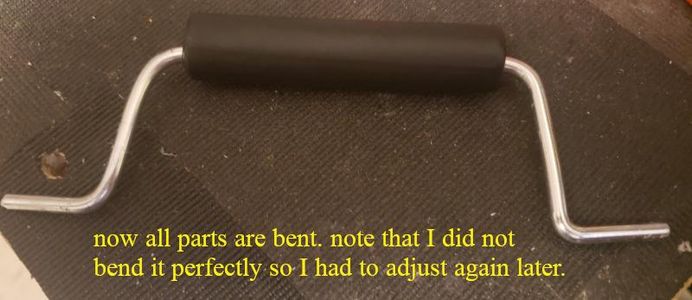

Step 3: Finishing the Bending.
Now finishing the bending. Note that if you did not bend it correctly, you will have to adjust it later.

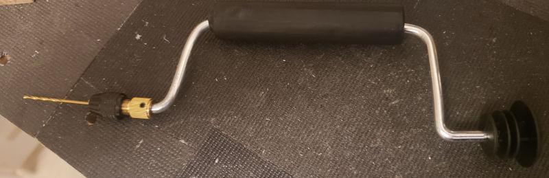

Step 4: Installing the Chuck and the Head

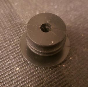

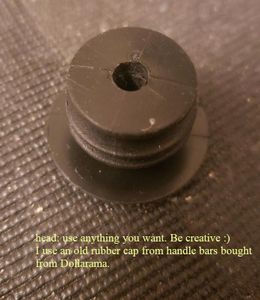

You can install the chuck and head now. If you do not have a head yet, you should create one. I do not have the knowledge to make brace bit head, so I simply used a rubber cap I found on a bicycle handlebar cover I bought from Dollarama. I drilled a 5mm hole in the center and stuck the end in. It's not perfect, but it works okay. ;P
Step 5: Test Drill and Adjust the Bending

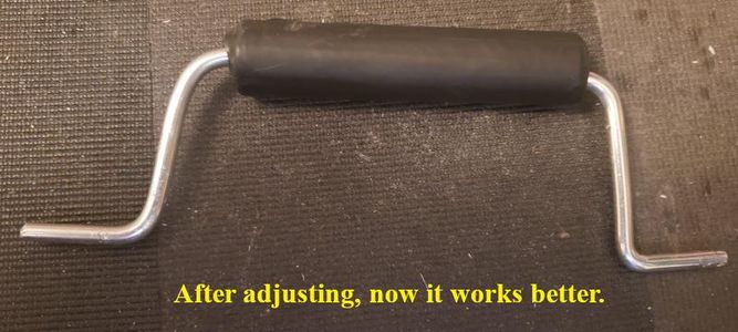

This is the last step. You will need to test drilling and see if it works okay. If not, you will have to check the bending. Make sure both ends are straight. Keep adjusting by micro-bending using your common sense until it works okay for you.

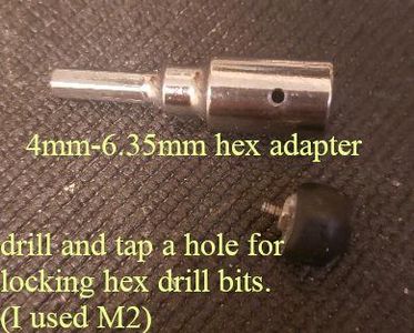

Step 6: Optional: 4mm to Hex Adapter
The drill chucks in this project can only hold up to 4mm. If you wish to be able to use normal hex shank bits, you can buy the 4mm to 6.35mm adapter. This is an uncommon item, and I found maybe two sellers who offer this product. I posted a link for the seller I bought from at the top.
Like all magnetic adapters, the drill bit will come out quite often when you pull. To fix this, I drilled and tapped an M2 hole and then used an M2 screw to lock the bit. The metal is not very hard, so it is simple to drill and tap. Using a drill guide is suggested to keep the drill straight.
I made three brace bits, each with a slightly different handle and head design. I actually use them more often than my 10" brace bit. They are very good at countersinking. For drilling and screw driving, you have to make sure the rod is aligned straight or it may have some problem.
I am glad I did not buy a 6". These 4" DIY brace bits are much cheaper and work better for my tasks. :)
