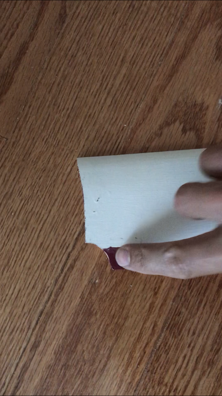

After sanding and painting the trim that I kept, it was time for reinstallation. This involves several tiny tiny cuts on the miter saw in order to get them to line up and fit just right. Especially the one where the baseboard needed a “lip“ to fit over the base that wasn’t removed. See pic 1 & 2

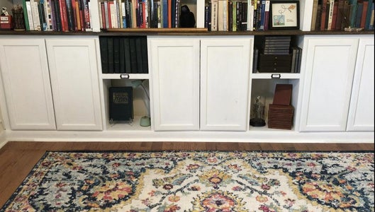

Once all of our books were on the shelves, we bought book ends to keep them in place and some antique library label holders. This helped for maintaining space for all of our knickknacks and knowing what style book was where i.e. fiction, non-fiction, anthology, etc.
We finally have a place for all of our books to rest nicely, as opposed to boxes/stacks on the floor! I also like that my wife maintained space to put our cool collectibles. (PS if you like that skeleton key cloche in picture 2, I have an instructable about it)
