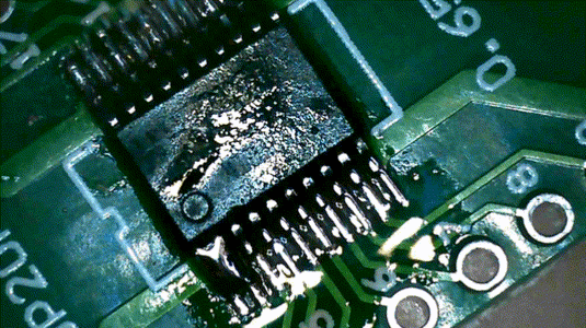

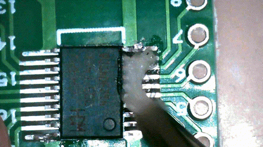

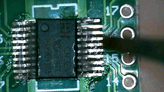

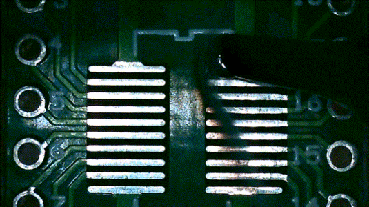

Step 1: Install the Microcontroller
First, fix two opposite corner pins. Apply some soldering flux and solder the remaining pins. The TSSOP20 package is pretty small for hand soldering, so it might be tricky. Use copper wick with flux to remove unwanted solder.

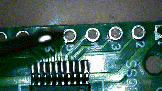

Step 2: Test the Connections
Use your multimeter's continuity mode to check out that everything is connected properly and there are no shorts.

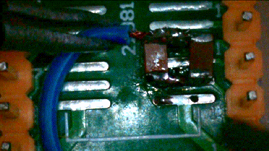

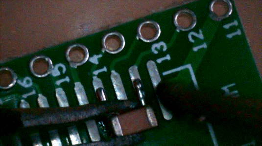

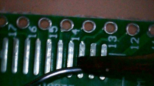

Step 3: Install Power Capacitors
On the opposite side of the board install two capacitors (10uF and 100nF) between pins 7 and 9 on the MCU (they correspond to pins 12 and 14 on the opposite side of the PCB).

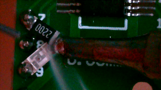

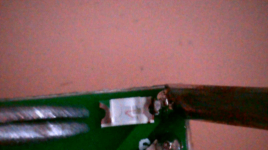

Step 5: Install Power LED
Note that SMD LEDs have marks on the bottom. You could also use your multimeter to determine anode and cathode. Solder power indicator LED with a resistor between pins 7 and 9.

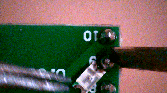

Step 6: Install PC0 LED
Optionally you might want to attach a programmable LED to one of the pins. I used pin 10 which corresponds to PC0, but it's up to you to decide. I routed the ground wire through the mounting hole beneath the board.

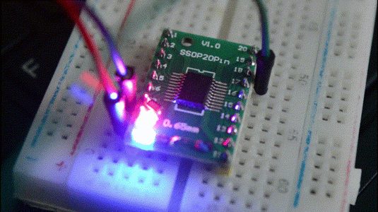

Step 7: Upload Your First Project

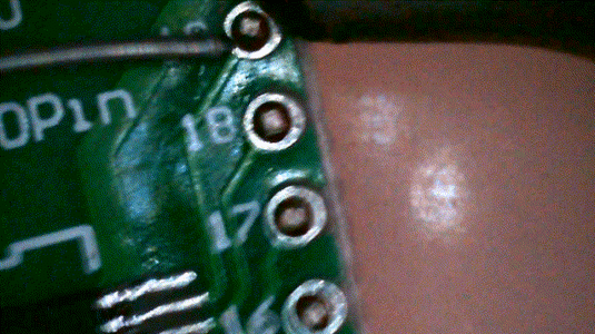

I prefer to use ch32v003fun, which is an open source toolkit for this microcontroller. It has a tool named minichlink for firmware uploading. You'll only need to connect three lines of WCH-Link:
3v3 WCH-Link - pin 9 devboard
GND WCH-Link - pin 7 devboard
SWDIO WCH-Link - pin 18 devboard
Go to ch32v003fun/exampes/blink directory and run the following command to upload the firmware:
make flash
