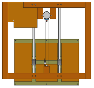

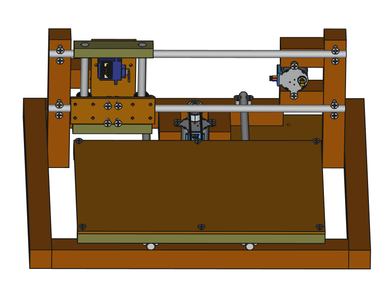

Step 1: Understanding the Design (CAD Model Overview)
Before we start building, let's break down the mechanical design of our pen plotter. Refer to the attached images to visualize these components.
Key Components
  1. Gantry: This is the main frame of the plotter, providing structural support. It consists of two primary sub-parts: the gantry base and the X-axis support.
  2. Axes: These are the rails along which the pen moves to create drawings.
  3. X-axis: Controls the horizontal movement (left and right) of the pen lifter, driven by a stepper motor and a timing belt.
  4. Y-axis: Controls the forward and backward movement of the entire print bed (the paper surface), also driven by a stepper motor and a timing belt.
  5. Z-axis: Manages the vertical movement of the pen (lifting it up or pressing it down), actuated by a small servo motor.
How it Works: Mechanical Movement
A pen plotter precisely draws images or text by coordinating the movement of a pen across three axes:
  1. X-axis (Horizontal Movement): A stepper motor, fitted with a driving pulley, pulls a timing belt. This belt is connected to the pen lifter, which holds the pen. As the motor rotates, the pen carriage slides horizontally along smooth linear rods (supported by linear bearings for minimal friction), moving the pen left or right across the paper.
  2. Y-axis (Print Bed Movement): A second stepper motor, located at the back of the plotter, drives another timing belt. This belt is attached to the print bed (the platform that holds the paper). When this motor operates, the print bed slides forward or backward along its own set of smooth linear rods and bearings.
  3. Z-axis (Pen Lift/Drop): A small servo motor is mounted on the pen carriage. A thin string mechanism connects the servo horn to the pen holder. Rotating the servo either lifts the pen off the paper (for non-drawing movements) or lowers it onto the paper to begin drawing a line.
Overall Operation
The magic happens when an Arduino microcontroller takes G-code commands from your computer. It translates these commands into precise electrical pulses that tell each stepper motor how many "steps" to take and the exact angle for the servo. By coordinating the simultaneous movement of the X and Y axes and precisely controlling the Z-axis (pen up/down), the plotter can accurately replicate complex digital designs onto physical paper. Throughout the system, idler pulleys are used to maintain proper tension in the timing belts, ensuring smooth and consistent motion.
I put a lot of thought and effort into planning and designing this pen plotter. For precise dimensions for drilling holes, cutting, and more detailed information, please refer to the 3D model files:
  1. 3D model file (FreeCAD document): https://github.com/piyush-suteri/grbl2dcnc
  2. Pen plotter 3D model (.step): https://drive.google.com/file/d/1qWtGvi9CmnBxgtljN3fKdhSpOpWY80Oh/view?usp=sharing
While you're encouraged to customize this design based on your available materials and needs (the fundamental operation remains the same), I truly hope you don't just copy this project. Instead, learn from its principles to inspire and build your own unique pen plotter. This Instructable will, however, guide you through my specific design.

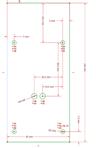

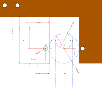

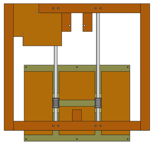

Step 2: Making the Gantry Base
The gantry base forms the fundamental structure, anchoring both the X-axis support and the Y-axis. This rectangular frame provides a stable foundation for the plotter's movement.
Materials Needed:
  1. 22 x 22 mm wooden strip
Instructions:

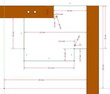

  1. Prepare the Top Piece: Cut one 240 mm piece. Drill holes as indicated in Image 2.
  2. Prepare the Bottom Piece: Cut one 300 mm piece. Drill holes as indicated in Image 3.
  3. Assemble the Frame: Using wood glue, carefully join the prepared top, bottom, and two 300 mm side pieces to form a rigid rectangular frame, as shown in Image 1.
(Note for attached images of each step: In the sketches, drilled holes are highlighted in green, while other colors are for representation.)

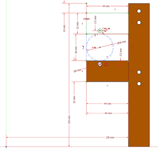

Step 4: Building Y-axis Stepper Motor Bracket
These small wooden blocks form a crucial bracket that securely mounts the 28BYJ-48 stepper motor, driving the Y-axis movement.
Materials Needed:
Instructions:
  1. Prepare the Blocks: Cut two pieces from the 22 x 22 mm wooden strip, each 44 mm long.
  2. Drill Mounting Holes: In each of these two blocks, drill a hole. Ensure these holes are precisely spaced to align with the mounting holes on the 28BYJ-48 stepper motor. Refer to Image 2 and Image 3 for drilling locations and spacing.
  3. Attach to Gantry Base: Use glue to securely attach the two drilled blocks to the inner side of the top piece of the gantry base. Position them carefully to create a stable mount for the Y-axis stepper motor. Place one block next to the electronics mount, and the second block will serve to complete the bracket for the stepper motor that will be added later between these blocks.

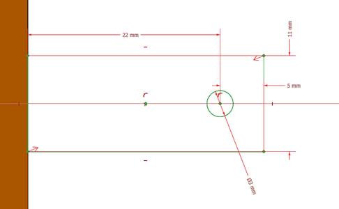

Step 5: Building Y-axis Idler Pulley Support
The support for the Y-axis idler pulley ensures smooth belt tension and precise movement for the plotter's Y-axis. The two-piece design allows for precise height alignment.
Materials Needed:
  2. 11 x 15 mm wooden strip
Instructions:
  1. Create the Main Support Block:
  2. Cut one 27 mm long piece from the 22 x 22 mm wooden strip.
  3. Securely attach this block to the inner side of the gantry base's bottom piece. This forms the primary support for the idler pulley. Refer to Image 1 and Image 2 for placement.
  4. Fabricate and Attach the Pulley Riser:
  5. Cut one 27 mm long piece from the 11 x 15 mm wooden strip. This piece will act as a riser to elevate the idler pulley by 15 mm, ensuring proper belt alignment with the stepper motor's pulley.
  6. Firmly glue this riser piece on top of the previously mounted 22 x 22 mm support block. See Image 3 and Image 4.
  7. Drill Pulley Mounting Hole: Drill a central hole through the newly attached pulley riser. This hole should be sized for an M5 bolt, which will be used to secure the idler pulley.

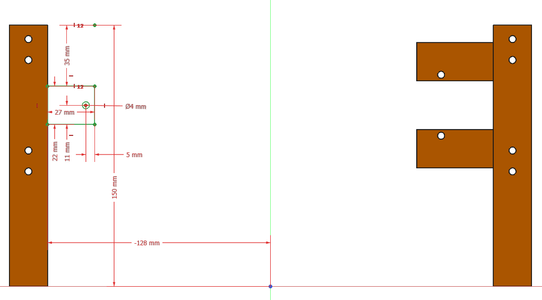

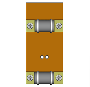

Step 6: Creating Linear Bearing Brackets
In this step, we will create the mounts for the LM8UU linear bearings. These bearings are designed to fit into smooth rods, which serve as tracks for carriages that move or slide along different axes. To attach the linear bearings, which can move freely within the smooth rods, to the carriages, we need to design a mount for them.
Materials Needed:

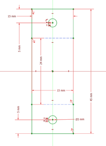

  1. 11 x 15 mm wooden strip
Instructions:
  1. Cut the Brackets: Cut four pieces, each 45 mm long, from the 11 x 15 mm wooden strip. These will serve as "Linear Bearing Brackets."
  2. Drill Mounting Holes: Drill holes on each of these four pieces as precisely indicated in the attached image. These holes are designed for mounting the brackets to the X and Y-axis carriage assemblies.
  3. Secure Linear Bearings: For each of the four wooden brackets:
  4. Place one LM8UU Linear Bearing onto the bracket.
  5. Securely fasten the bearing to the wooden block using two zip ties. Ensure the zip ties are pulled very tight to eliminate any play, which is vital for accurate plotting.
  6. Trim any excess zip tie material for a neat finish.

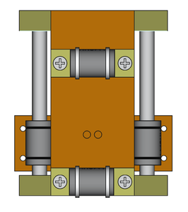

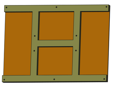

Step 7: Making the Print Bed Assembly
The print bed assembly is where the paper or drawing surface will sit. A stable and smooth print bed is crucial for accurate plotting.
Prepare the Print Bed
  1. Take a piece of cardboard measuring approximately 180 x 250 mm. Laminate it with tape for a smoother surface for quality print.
  2. Drill four small holes, one in each corner of the cardboard. These holes will be used to secure the print bed to its underlying support structure.
Build the Print Bed Support Structure
This rigid wooden frame provides the necessary support and attachment points for linear bearings, enabling smooth movement along the Y-axis.
Materials Needed:
  1. 11 x 15 mm wooden strips
Instructions:
  1. Cut the Support Strips: From the 11 x 15 mm wooden strips, cut the following pieces to form a frame:
  2. 2 longer pieces @ 250 mm
  3. 2 shorter pieces @ 150 mm
  4. 1 center piece @ 85 mm
  5. Refer to Image 1 and Image 2 for the layout of these pieces.
  6. Assemble the Frame as shown in the video.
  7. Drill Bearing Attachment Holes: Drill holes at specific locations on this wooden frame. These holes are critical for attaching the linear bearing brackets in a later step, as shown in Image 2.
  8. Place the prepared print bed on top of the print bed support structure. Align the pre-drilled holes in the print bed with the support structure. Secure the print bed to the support structure using small wood screws.

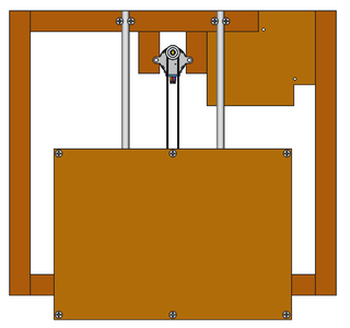

Step 10: Installing the Y-axis Stepper Motor and Pulley System
This crucial step involves setting up the Y-axis stepper motor, its driving pulley, and the timing belt system. Refer to the attached video for a comprehensive visual guide.
Y-Axis Stepper Motor and Drive Pulley Installation
  1. Mount the Stepper Motor:
  2. Position the 28BYJ-48 stepper motor onto the wooden brackets prepared in Step 4 on the gantry base.
  3. Securely fasten the motor using small screws, ensuring it is firmly seated and does not wobble.
  4. Also, its shaft should be in the direction of the back side of the plotter. This maximizes the reach of the print bed.
  5. Attach Drive Pulley:
  6. Carefully attach the GT2 20-tooth timing pulley to the shaft of the stepper motor.
  7. Ensure the grub screws on the pulley align with the flat side of the motor shaft and tighten them firmly to prevent slipping.
  8. Route and Attach Timing Belt:
  9. Cut a 500 mm piece of the timing belt. Take two screws and wrap the end of timing belt around each screw. To secure the wrap, use zip ties along the width of the timing belt to ensure it is tightly sandwiched.
  10. Route one end of the GT2 timing belt around the newly installed drive pulley.
  11. Place the belt over the Y-axis print bed assembly and firmly secure both ends to the print bed using the small screws already attached to the belt ends. This forms the closed-loop drive system that converts motor rotation into linear motion for the Y-axis.

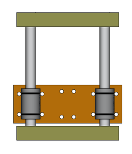

Step 11: Preparing the Z-Axis Carriage (Pen Holder)
This step focuses on creating the Z-axis carriage, which holds the pen. This component slides vertically on the Z-axis, allowing movement of the pen to move up and down to make contact with the drawing surface.
Materials Needed:
  1. 1 piece of cardboard or wood (approximately 30 x 85 mm)
  2. 2 x LM8UU linear bearings
  3. Cable ties
Instructions:
  1. Cut the Carriage Piece: Take your chosen material (cardboard or wood) and cut it to the dimensions of 30 x 85 mm.
  2. Drill Mounting Holes: Precisely drill holes on this carriage piece, specifically spaced for mounting the LM8UU linear bearings and pen in the middle as shown in the accompanying image.
  3. Mount the Linear Bearings:

Step 13: Crafting the X-Axis Carriage
This component serves as the central part of the X-axis carriage assembly or pen lifter assembly. Its critical role is to connect the X-axis linear motion system at the back while providing a stable anchor point for the Z-axis rails at the front.
Materials Needed:
  1. 1 piece of plywood or thick cardboard (100 x 45 mm)
  2. Screws (for attaching linear bearing brackets)
Instructions:
  1. Cut the Carriage Piece: Cut plywood or cardboard to 100 x 45 mm.
  2. Drill Mounting Holes: Drill holes on this piece precisely as shown in Image 2. These holes are specifically for securely mounting the linear bearing brackets and attaching the X-axis timing belt.
  3. Install Linear Bearing Brackets: Attach the previously prepared linear bearing brackets to the X-axis carriage using screws, fastening them into the drilled holes.
Step 14: Assembling the Pen Lifter (Z-Axis Rails to X-Axis Carriage)
This step integrates the Z-axis rail assembly from step 12 with the X-axis carriage from step 13.
Instructions:
  1. Mount Z-Axis Rails Assembly to X-Axis Carriage: Securely attach the Z-axis rail assembly (completed in Step 12) onto the top surface of the X-axis carriage (from Step 13) using glue.

Step 16: Building X-axis Support
The X-axis support assembly is a critical sub-component that attaches to the gantry base. Its purpose is to securely hold and provide guidance for the entire X-axis system, which includes the X-axis stepper motor and idler pulley.
Materials Needed:
Instructions:
  1. Prepare X-Axis Support Pieces:
  2. Cut two 150 mm pieces from the 22 x 22 mm wooden strip.
  3. Drill holes in these two pieces as indicated in Image 2. These will serve as your main left and right supports for the X-axis.
  4. Fabricate Idler Pulley Support:
  5. Cut one 27 mm piece from the 22 x 22 mm wooden strip.
  6. Drill a hole in this piece for the idler pulley, as shown in Image 3.
  7. Create Stepper Motor Bracket:
  8. Cut two 44 mm pieces from the 22 x 22 mm wooden strip.
  9. Drill holes in these two pieces, spaced to firmly hold the X-axis stepper motor between them. Refer to Image 4 for hole placement.
  10. Assemble the X-Axis Support Pieces:
  11. Securely glue the idler pulley support (27 mm piece) onto the left 150 mm X-axis support piece.
  12. Similarly, glue the two stepper motor bracket pieces (44 mm pieces) onto the right 150 mm X-axis support piece, creating the mount for the stepper motor.
  13. Refer to the attached images for the precise positioning of these components.

Step 18: Installing the X-Axis Support to the Gantry Base
This step involves integrating the complete X-axis assembly (including its motor, rails, and pen lifter) with the main gantry base.
Materials Needed:
  1. GT2 timing belt
  2. Small screws (for belt attachment)
  3. Wood glue
Instructions:
  1. Route and Attach X-Axis Timing Belt:
  2. Cut the timing belt into a 500 mm piece. Like we did for the Y-axis belt, take two screws and attach them to each end of this belt.
  3. Route your GT2 timing belt around the GT2 driving pulley.
  4. Securely attach both ends of the timing belt to the pen lifter assembly using small screws, as demonstrated in the attached video. This creates the critical closed-loop drive system that will move the pen lifter along the X-axis.
  5. Position X-Axis Support in Gantry Base:
  6. Carefully slide the assembled X-axis support into the gantry base. The two 150 mm side pieces of the X-axis support will fit against the inner sides of the gantry base's left and right parts.
  7. Crucially, position the X-axis support precisely 78 mm below the outer edge of the gantry's top piece. Refer to Image 2 for this exact measurement and positioning within the gantry base. Precision here is vital for the plotter's alignment. In our case, the right X-axis support fits just next to the electronics mount at its bottom-right corner.
  8. Secure X-Axis Support:
  9. Once correctly positioned, use wood glue to firmly secure the X-axis support to the gantry base.
  10. Allow the glue to dry completely and properly cure before proceeding to the next steps.

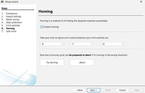

Before continuing further, we need to first understand what is homing, which is crucial for further steps. Homing in CNC is like telling the machine where its "home" is. When you turn on a CNC machine, it doesn't know its exact position. It could be anywhere within its working area. Without knowing its starting point, it wouldn't be able to accurately move to the coordinates you give it.
How it works?
  1. Reference Points: The CNC machine has "limit switches", at the very end of each axis. Each axis typically has one limit switch. In our case, we used two limit switches per axis. One limit switch will act as the home position and the other as the terminal position. Whenever carriage of any axis accidentally hits any of the limit switches, the pen plotter immediately enters an alarming mode and stops all its operations for safety purposes.
  2. Moving to Home: When you initiate the "homing" sequence or simply send a command for homing from UGS, the machine starts slowly moving each of its carriages towards these switches.
  3. Finding Zero: When an axis hits its home switch, the machine knows it has reached that specific reference point. It then records this position as its "zero" or "home" position for that axis.
  4. Repeating for all Axes: This process is repeated for all the axes of the machine.
  5. Once the machine has homed all its axes, it knows its absolute position. From this "home" or "zero" point, it can then precisely move to any other coordinate you program your CNC.
  6. Homing is done before starting any work in CNC. Homing will return each carriage to its start position.
  7. GRBL's default expectation for homing is towards the negative end of both axes, i.e., when homed pen will be near to top-right corner of the paper in the print bed. Here's how this translates to our plotter:
  8. X-axis: The left side is the negative direction.
  9. Y-axis: The front side of our pen plotter is the negative direction.
  10. This setup mirrors the standard Cartesian coordinate system you're familiar with from your math studies. Therefore, in the home position, the print bed will be at its frontmost point, and the pen lifter will be at its leftmost point.
  11. If your plotter homes to a different direction, it indicates an incorrect motor rotation direction. We'll cover how to correct this in a later step.

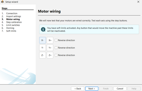

Step 25: Motor Wiring Settings
  1. From the top menu bar, navigate to "Machine" -> "Setup wizard".
  2. When the setup wizard pops up, click Next two times to enter the motor wiring section. It is recommended that you carefully read and understand the information written in each section of UI.
  3. You should now be in the motor wiring section. These settings allow you to directly control stepper motors. Clicking on the + and - movement buttons for the X and Y axes should move the carriages in those axes, respectively.
  4. You might observe that carriages on their axis might not move in the intended direction (i.e., positive or negative direction) as labeled in the button you click. If this happens, check the reverse directioncheckbox next to the axis control buttons.
  5. Finally, confirm that both axes' movement is in the right direction and both carriages have full reach. You might need to confirm that no carriage is physically blocked in any position in their axis. If this is the case, try to rebuild that axis properly.

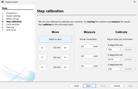

Step 26: Calibrating Steps
This is the most crucial step for your pen plotter's accuracy!
Your Arduino controls the stepper motors by sending signals for them to rotate in tiny steps. These rotational steps are then translated into linear motion by the plotter. However, the Arduino doesn't inherently know how many of these steps correspond to a specific physical distance (in millimeters) the pen moves.
There isn't a fixed value for "steps per millimeter" because it depends entirely on your plotter's mechanical setup. To determine this, we'll use a trial-and-error method, which involves:
  1. Using the pen plotter to draw several lines on paper.
  2. Precisely measuring the actual length of each line using a scale.
  3. Comparing the number of steps the motor moved to the actual distance the pen traveled. This allows us to calculate and calibrate the "steps per mm" value. This involves repeated experimentation to fine-tune the setting.
When we use the setup wizard, this value will be automatically calculated for us, based on a formula working behind the scenes.
Follow these steps to properly calibrate your plotter:
  1. From the previous step, click Next to enter the Step Calibration section.
  2. Attach the paper to the print bed using clips on each side of the paper and print bed.
  3. Physically adjust the pen to move it down: Unscrew and re-screw the pen in a lowered position so it properly touches the paper. This ensures your drawings will be produced correctly.
  4. Once everything is ready, in the wizard under the Move label, use the + and - buttons to move each axis one by one.
  5. Start with the first axis. The pen will move and draw a small line on the page. Measure the length of this line and enter it under the ActualMovement label for that axis.
  6. The wizard's right panel displays the estimated "steps per mm" for the axis you just manipulated. Input this value into the designated text box and click on update.
  7. Repeat this process until you achieve the correct length drawn by the pen for that axis.
  8. Repeat these steps for the remaining axes.
  9. Once all axes are calibrated, click Next.
Initially, UGS aims for a 1 mm movement by instructing the Arduino to rotate the motor using the current "steps per mm" setting. This first value won't be perfectly accurate. As you provide the actual measured length of the line, the underlying algorithm refines the "steps per mm" by dividing the commanded steps by the real distance traveled. This iterative process of measuring and adjusting leads to a precise "steps per mm" calibration.

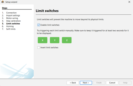

Step 27: Enabling Limit Switches
In the setup wizard, you should currently be in the limit switches section. Please check the box to enable limit switches. Then, click the Next button.
Step 28: Enabling Homing
Check the "Enable Homing" checkbox. Below it, you'll find options for the default homing direction. I recommend leaving these settings as they are initially. If your pen plotter homes in the wrong direction, go back to the Motor Wiring section and reverse the motor's polarity there.
Once you're confident the homing direction is correct, click "Try Homing." This should home your machine. If anything goes wrong, or if any carriage reaches an axis end and doesn't stop, immediately click "Abort" or turn off the power supply to prevent damage to your plotter.
If everything works as expected, click Next.

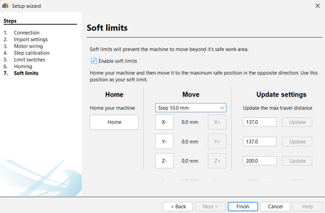

Step 29: Enabling Soft Limits
Soft limits define the maximum safe distance the plotter's carriage assemblies can move from their home positions without hitting the physical end of an axis. While we have physical limit switches at the ends, soft limits are crucial because they prevent the carriages from ever reaching these switches.
When a carriage hits a limit switch, the plotter immediately stops all action and enters an "alarm" state. It's always better to avoid this alarm state by ensuring the carriages don't reach the limit switches. However, limit switches still play a vital role as a safety backup. If the "steps per mm" calibration isn't perfectly accurate, the carriage might accumulate a small error, potentially causing it to travel further than expected and trigger a limit switch. This "extra" unmeasured distance is precisely why the physical limit switches are necessary even with soft limits enabled.
To set the soft limits:
  1. From the left panel, first home the machine.
  2. Then, using the + and - buttons in the middle panel, move each carriage away from its home position.
  3. Continue moving the carriage in one direction until it's about a few millimeters (this distance is left to create space for error distance accumulation) away to trigger the limit switch at the other end of the axis.
  4. Record the distance traveled from the home position (this distance will be displayed in the middle panel as the carriage moves).
  5. Enter these recorded distances for each axis under "Max Travel Distance" in the right panel.
  6. Click Update.
Note: This "Max Travel Distance" might not be the same as the total length of the axis because the carriage's physical size reduces the effective travel distance available.
Once these steps are complete, click Finish.

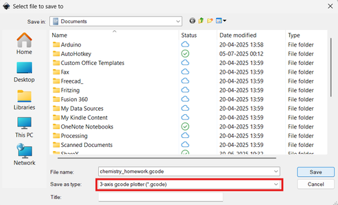

Step 32: Exporting to G-code
Once the drawing is ready we can export it to G-code.
Export the G-code using GcodePlot:
  1. With your drawing prepared and selected, go to "File" -> "Save As".
  2. In the "Save as type" dropdown menu, select "3-axis gcode plotter (*.gcode)".
  3. Choose a filename and click "Save".

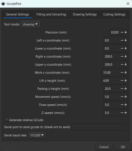

  4. The "GcodePlot" settings window will appear.
Step 33: Configuring G-CodePlot Settings
As a final step before outputting your G-Code, you need to adjust a few settings within the GcodePlot extension. While you're encouraged to fine-tune these settings later for optimal results, for now, you can simply use the recommended values below.
Don't worry if this feels a bit overwhelming at first; it's a one-time setup that won't require frequent modification and most settings are to be left in their default states. As you work more and more with the pen plotter, generating and streaming G-code will become much easier. You might be wondering if your plotter will actually work at this point – rest assured, it will, provided you've carefully followed and, more importantly, understood the concepts of each step so far. Understanding "how things work" is crucial for effective troubleshooting.
Configure GcodePlot Settings:
General Settings Tab:
  1. Tool mode: Select "drawing" from the dropdown.
  2. Precision (mm): 0.020 (This improves the approximation of curves.)
  3. Left x-coordinate (mm): 0.0
  4. Lower y-coordinate (mm): 0.0
  5. Right x-coordinate (mm): 200.0 (This is for paper width.)
  6. Upper y-coordinate (mm): 200.0 (This is for paper height.)
  7. Work z-coordinate (mm): 15.00
  8. Lift z-height (mm): 4.00
  9. Parking z-height (mm): 20.0
  10. Movement speed (mm/s): 5.8 (This is your plotter's maximum reliable feed rate, e.g., 350 mm/min, divided by 60 for mm/s.)
  11. Draw speed (mm/s): 5.0 (Set this slightly slower than your Movement speed for better line quality. Adjust as needed.)
  12. Z-speed (mm/s): 5.0
  13. Serial baud rate: 115200 (This must match your GRBL baud rate.)
Note: Leave the Z-axis settings as it is, since we don't have a Z-axis like a typical CNC machine.

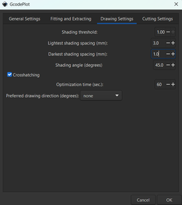

Drawing Settings Tab:
  1. Shading threshold: 1.00
  2. Lightest shading spacing (mm): 3.0
  3. Darkest shading spacing (mm): 1.0 (Adjust this value to control the density of shaded areas. 1.0 mm works well for this example.)
  4. Shading angle (degrees): 45.0 (This sets the angle of the shading lines.)
  5. Crosshatching:
  6. Optimization time (sec.): 60
  7. Preferred drawing direction: none

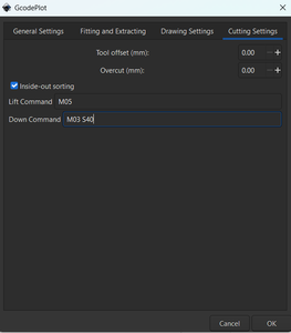

Cutting Settings Tab (CRUCIAL for Servo Control):
  1. Tool offset (mm): 0.00
  2. Overcut (mm): 0.00
  3. Lift Command: Type M05
  4. M05 is the GRBL command to stop a spindle. In the modified GRBL firmware for our plotter, M05 is repurposed to command the servo to lift the pen.
  5. Down Command: Type M03 S40
  6. M03 is the GRBL command to start a spindle. In our modified GRBL firmware, M03 SXX (where XX is a value) is repurposed to command the servo to lower the pen to a specific position. You will need to adjust the XX value to fit your pen plotter. Ensure that the value is such that it lowers the pen to the extent that it touches the paper properly. One way to do that is to reposition the servo's horn. Another way is to directly experiment with these values to find the right value. For this, you can send M05 and M03 SXX commands repeatedly using different values of the XX to the pen plotter using the UGS console.
