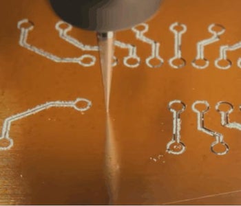

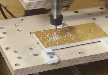

I have tested this machine on acrylic, PCB, wood and it works fine.
I haven't tested it on aluminum yet, but yes, for shallow engraving with a high-quality end mill, we can definitely get good results on aluminum as well.

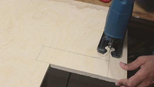

  1. design CNC machine dimensions
  2. cutting
  3. drilling

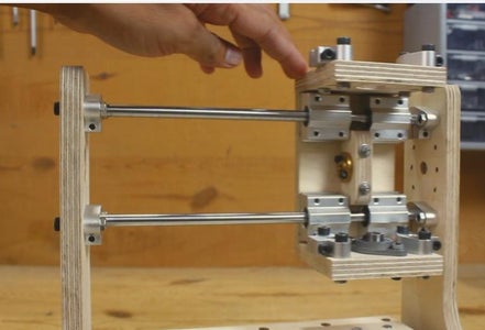

Step 2: Assembly

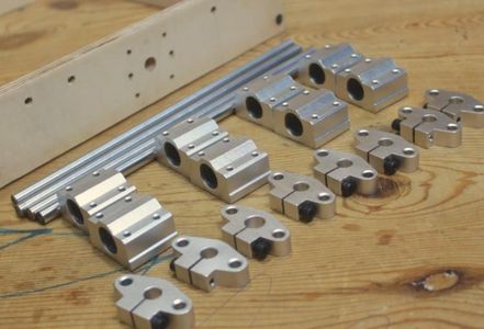

1. After cutting and drilling the 12mm plywood, I clamped it to a right angle jig to drill the screws into the edges.
2. Drill holes for screws on the CNC frame

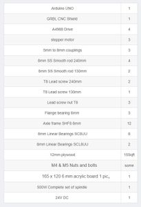

3. Here I use 240mm 8mm smooth rod and 8mm 240mm lead screw
4. Linear bearing and shaft frame quantities are available in the Material Requirements section

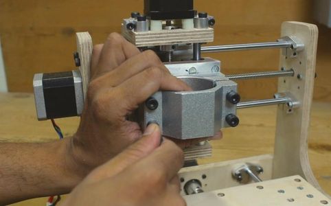

5. Here I also installed the Z axis

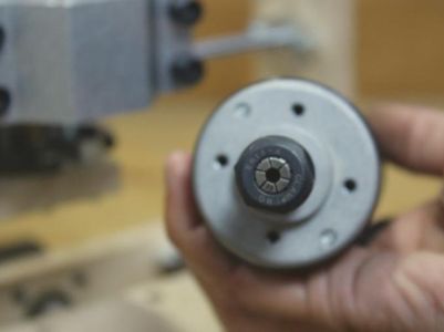

6. Install 500W spindle motor

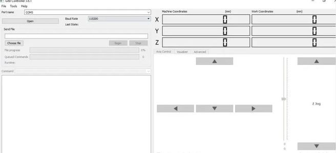

8. Use the GRBL Controller software to send gcode to the machine
