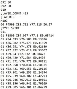

The machine was able to cut metal and wood. At this point I decided to make a dedicated table for this CNC machine that has a hole under the machine with a tub so that coolant can be used. I also added 3 slide-in walls that keeps sawdust off the floor, and side of the table where my computer sits. Also for speeds and feeds, I used Fusion 360 to generate the tool paths. I used 500 mm a seconds for wood and aluminum. You can cut 2 mm deep on wood and for aluminum 0.3 to 0.5 mm. To conclude, I set out to make this CNC machine with the goal to design and make parts not only out of wood but also metal. I believe that I have succeeded in that goal.
