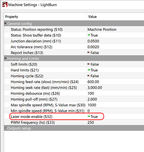

First of all, thanks to the GRBL-based solution, it's very easy to switch from CNC mode to Laser mode with just a single parameter setting. This can be done by setting the value of parameter 32 from zero to one. As you can see in the first picture. From this point on, the control program will turn off the laser light while changing positions.
In this simple way I have kept the possibility to just switch back to Cnc mode and use the machine for engraving with bits.

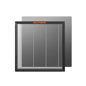

The head unit operates with an air blow assistant for cleaner cutting. This tube was also attached to the frame of the CNC machine. Another condition for cleaner cutting is a honeycomb lattice underlay tray, which helps to remove the smoke formed underneath, thus aiding in achieving a cleaner cut.

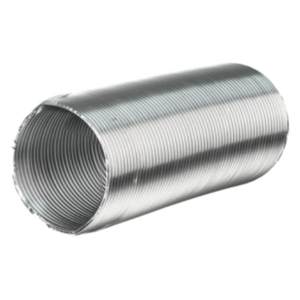

I also made a smoke extraction device, as inhaling the formed smoke is not healthy. For this, a 110 mm diameter flexible air duct was installed, with a bathroom fan placed at one end and the other end leading out of the room.
For operating the laser cutting machine, I used the Lightburn software, which I used before, with which the modification of parameter 32 mentioned earlier can be easily done and then written back to the Arduino program memory.
