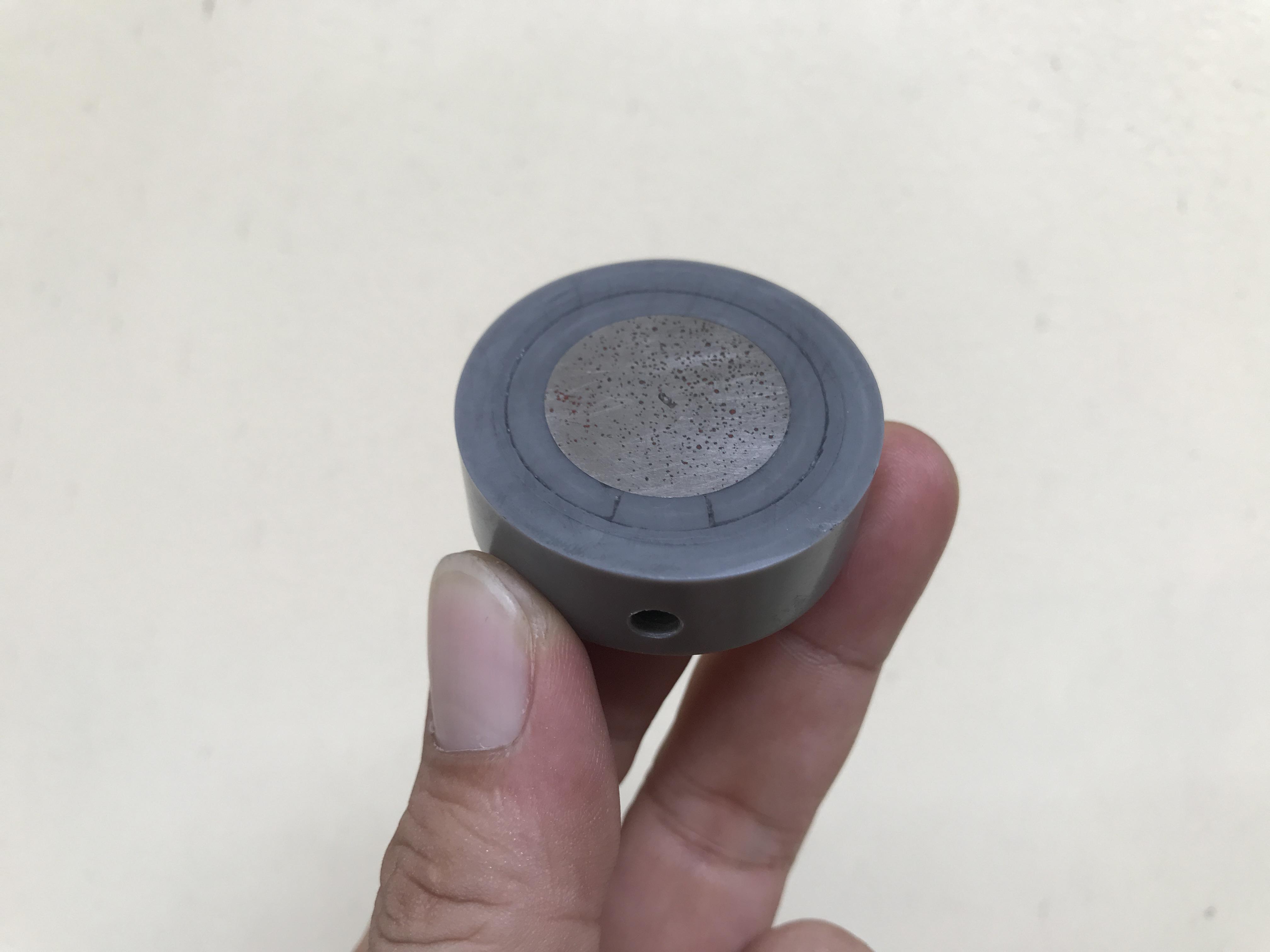

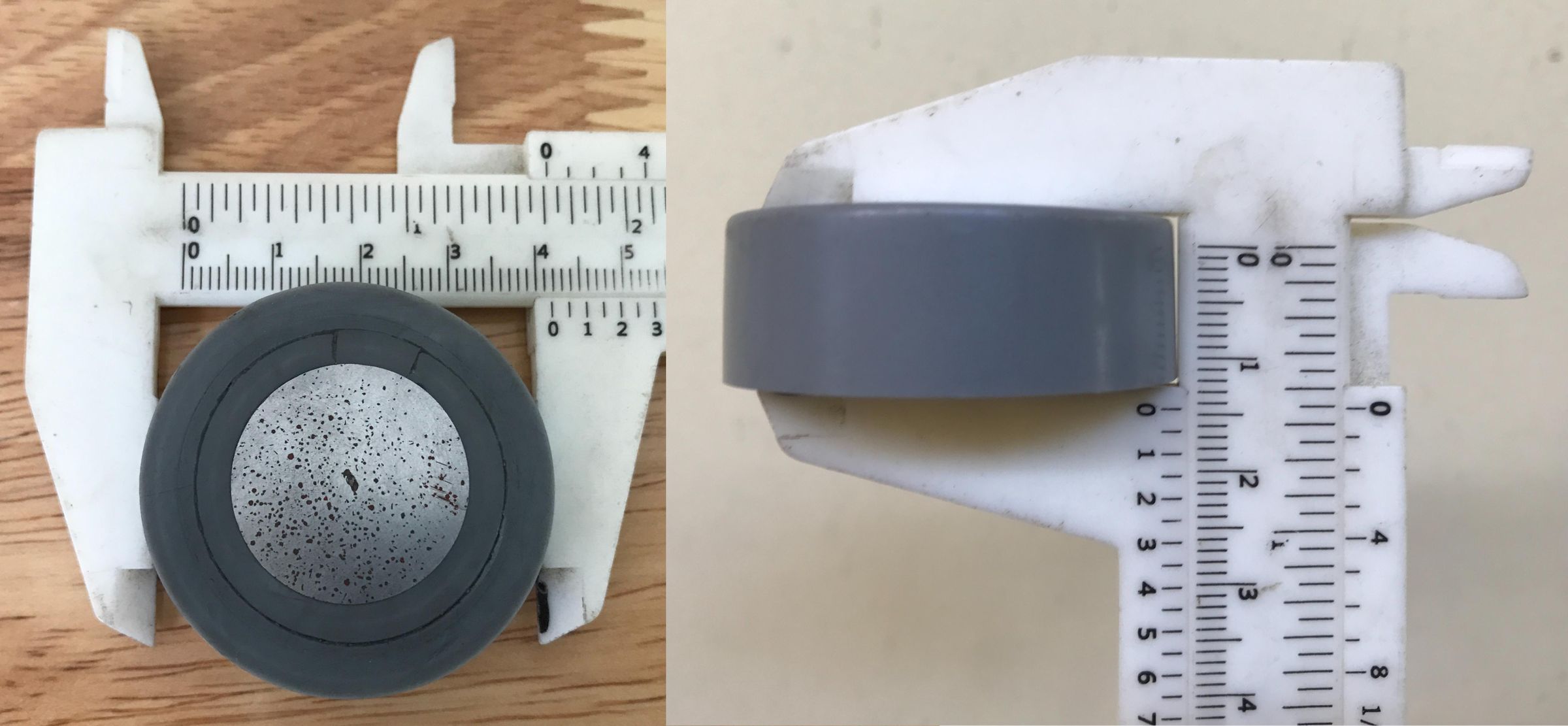

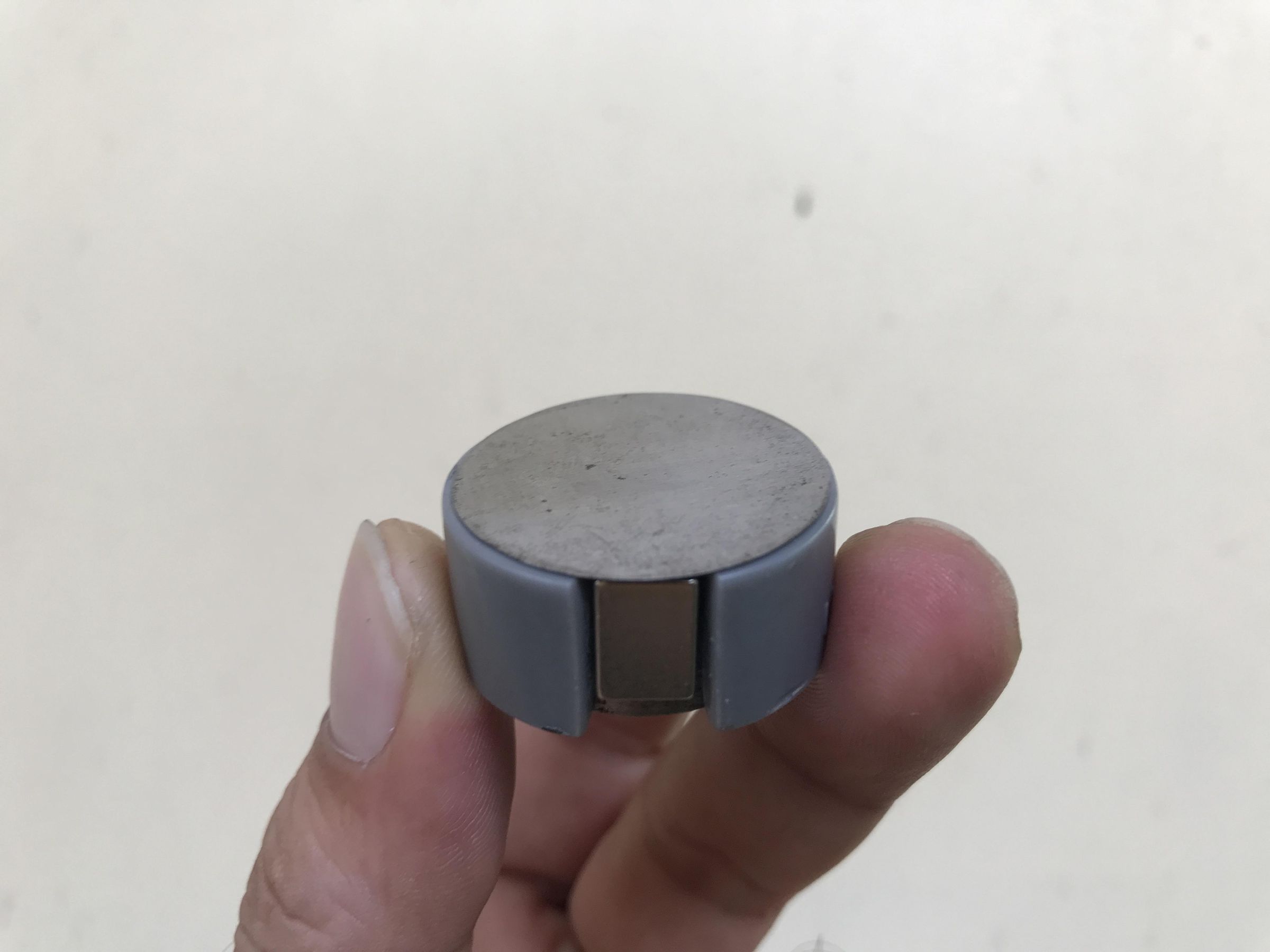

My round steel plate has a diameter 25mm, thickness 14.5mm. I cut a piece PVC fitting, 22mm inner diameter to wrap around the round steel. There is also a space left on the side to attach a magnet.
I continued to wrap two more layers of PVC fittings.
Two small neodymium magnets from DVD/CD drive were inserted into the hole.
I used super glue to cover the hole at bottom, sanded it flat then drilled a hole 4mm in the side.
Trial testing with banana male connector. At the same time, I also used a multimeter to check the contact between the touching plate and banana connecter via magnet.
Dimensions of Z touching plate are as follows

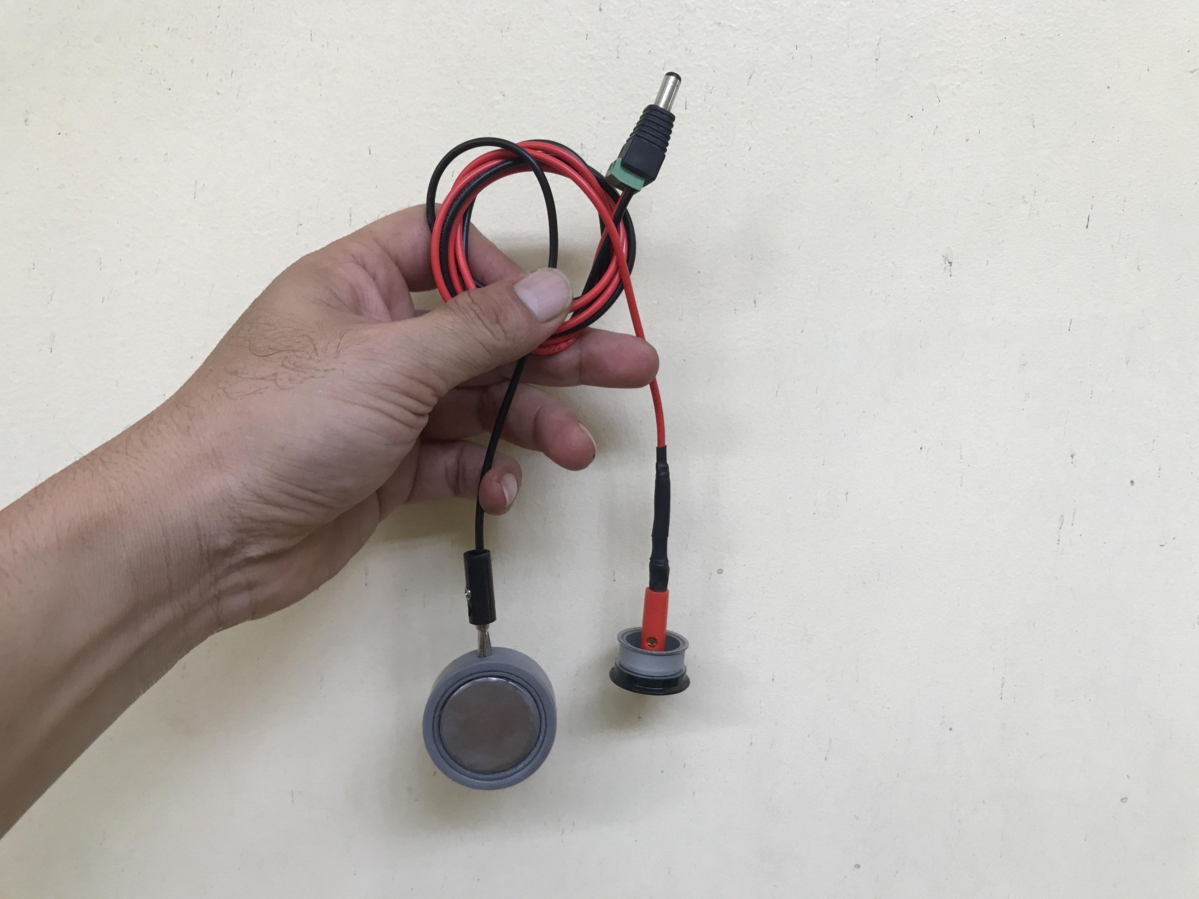

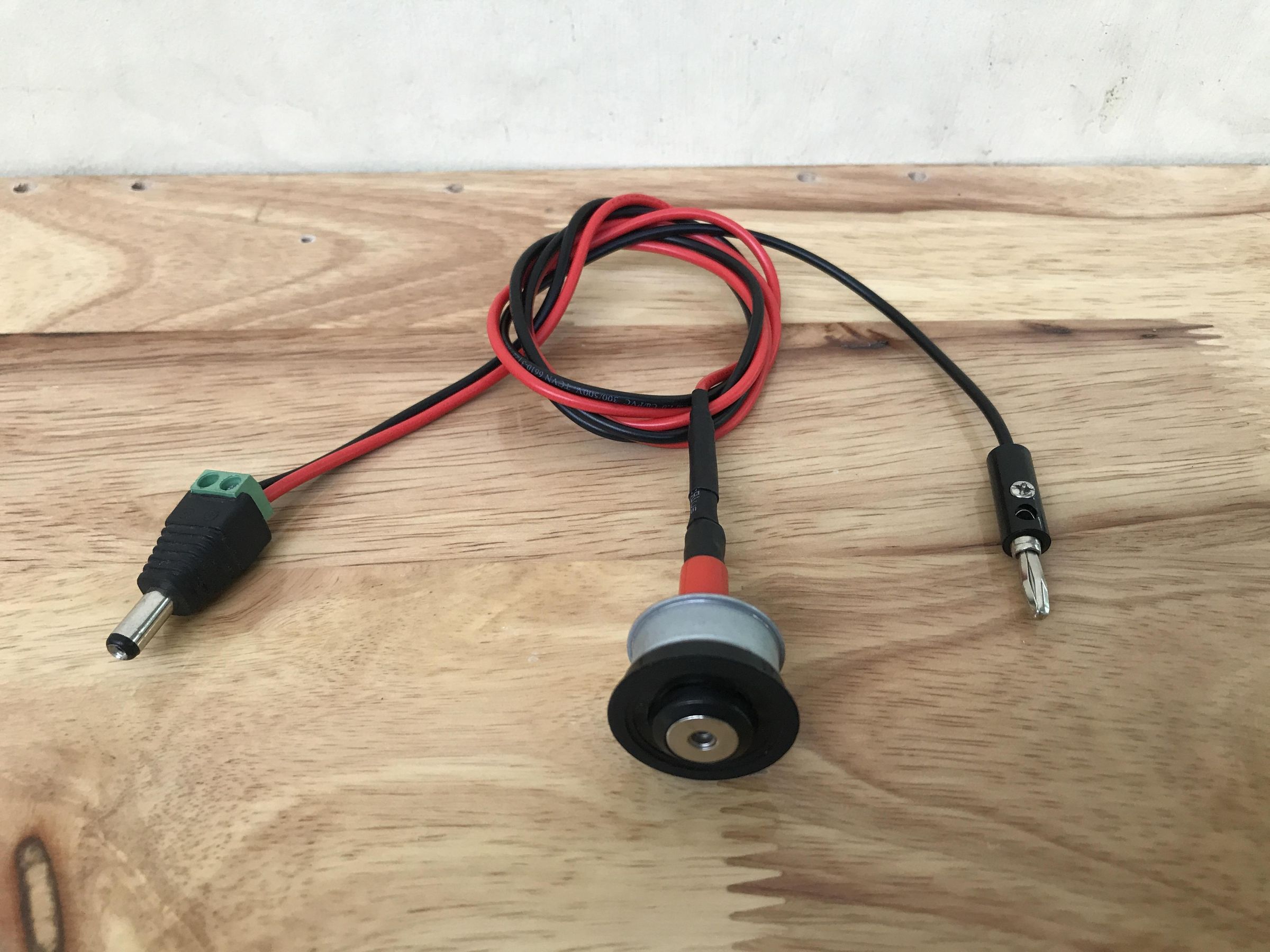

Step 2: Build Magnetic Wire and Connectors

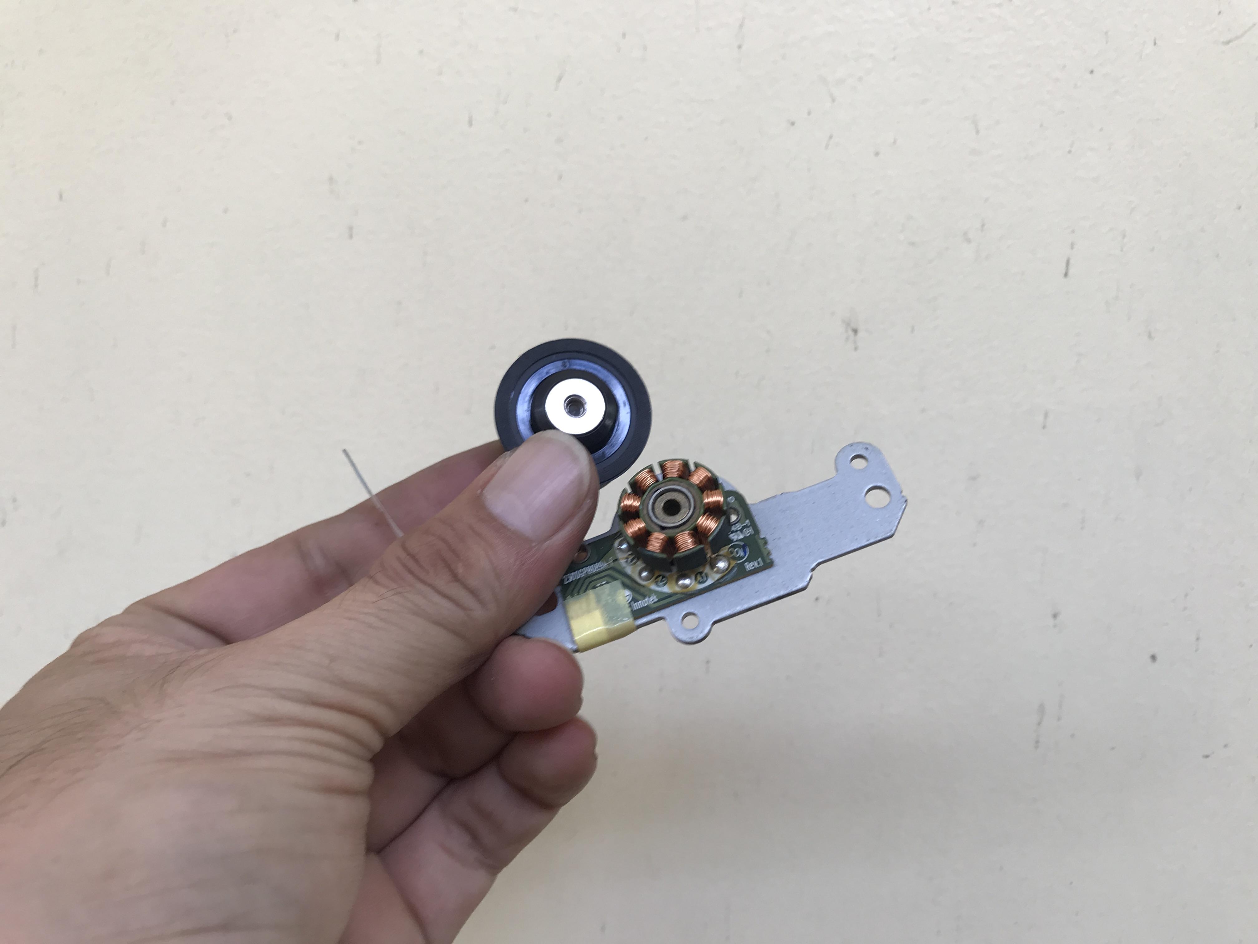

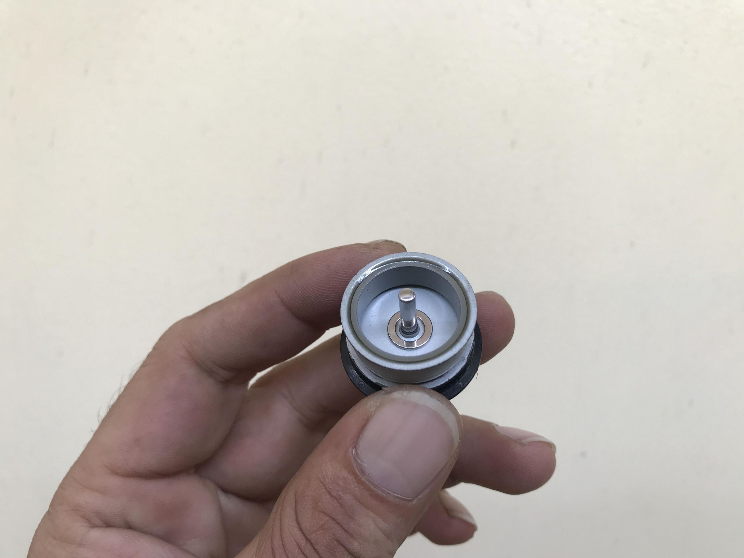

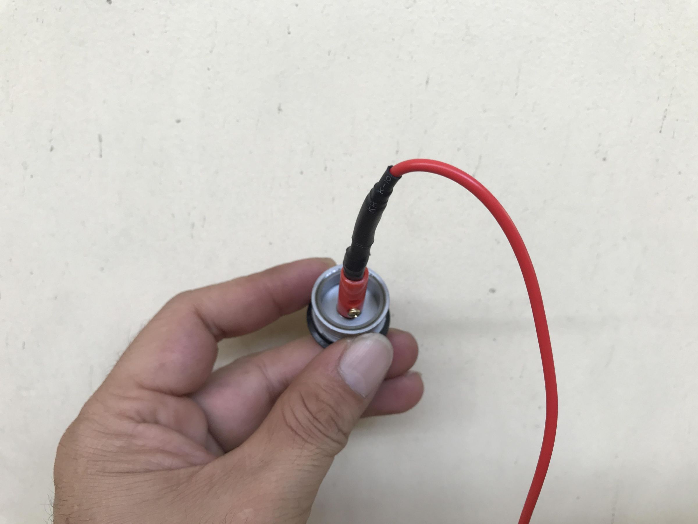

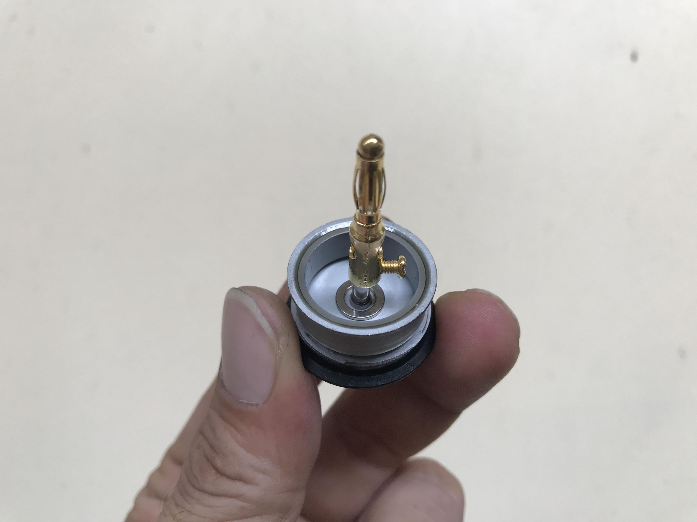

I found a spindle brushless DC motor inside a DVD/CD ROM with its body, which maybe called a "rotor", having very strong magnetism at outer metal plate (silver color in the picture below).
Inside this rotor, there're a shaft diameter 3mm connected to this outer metal plate. There are many types of spindle brushless DC motors in DVD/CD ROM, you should check whether this outer metal part is connected to the shaft before making this magnetic wire.
I connected a banana male connector to this shaft and tightened the screw on one side.
The other end was soldered to the red wire.
A black wire was connected to another banana connector on one end. Finally at the other ends, two wires were connected to a DC power male plug.
Done and we can test it with touching plate!

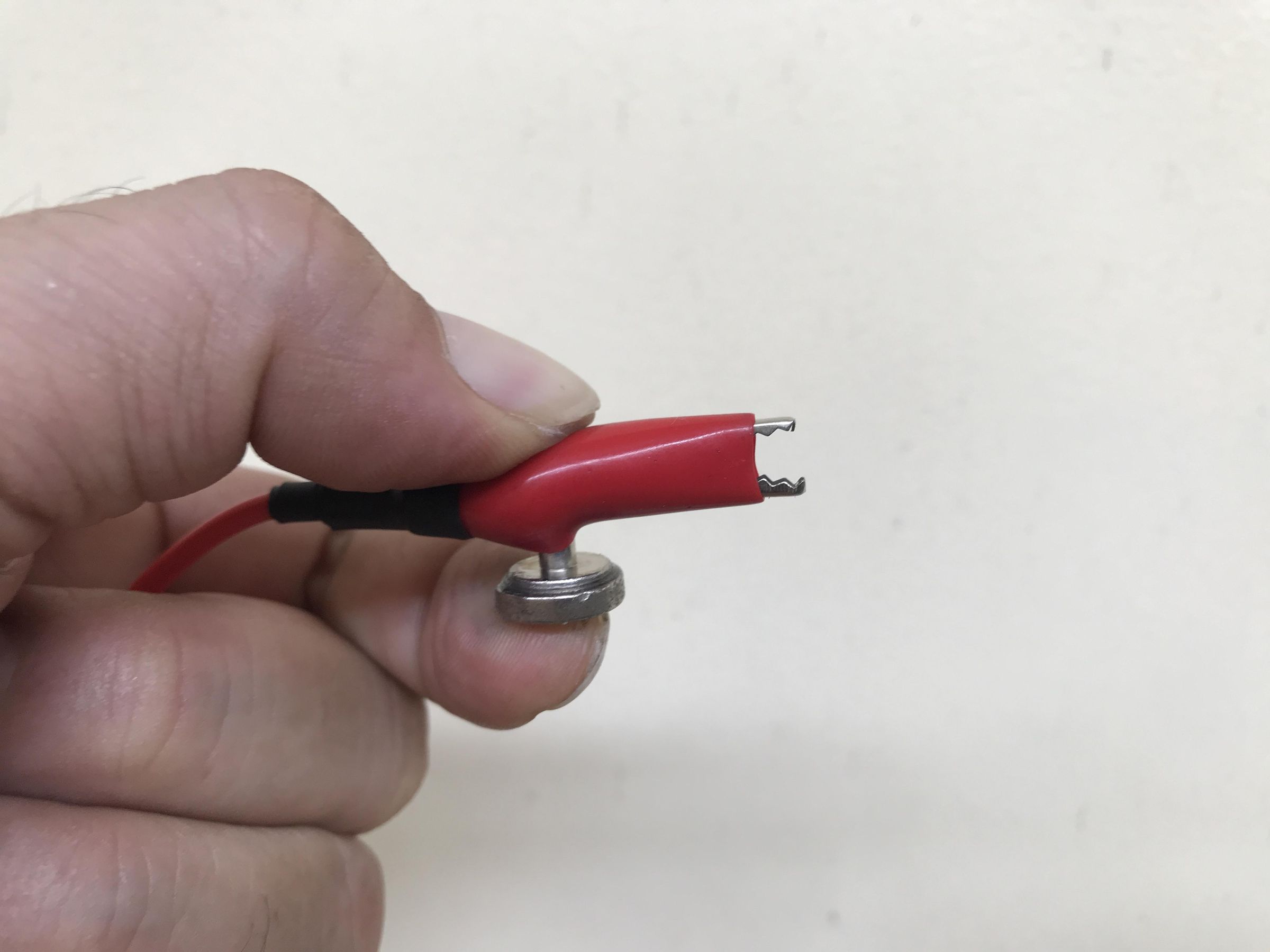

Step 3: Build Two-In-One Connector: Alligator Clip and Magnetic Contact

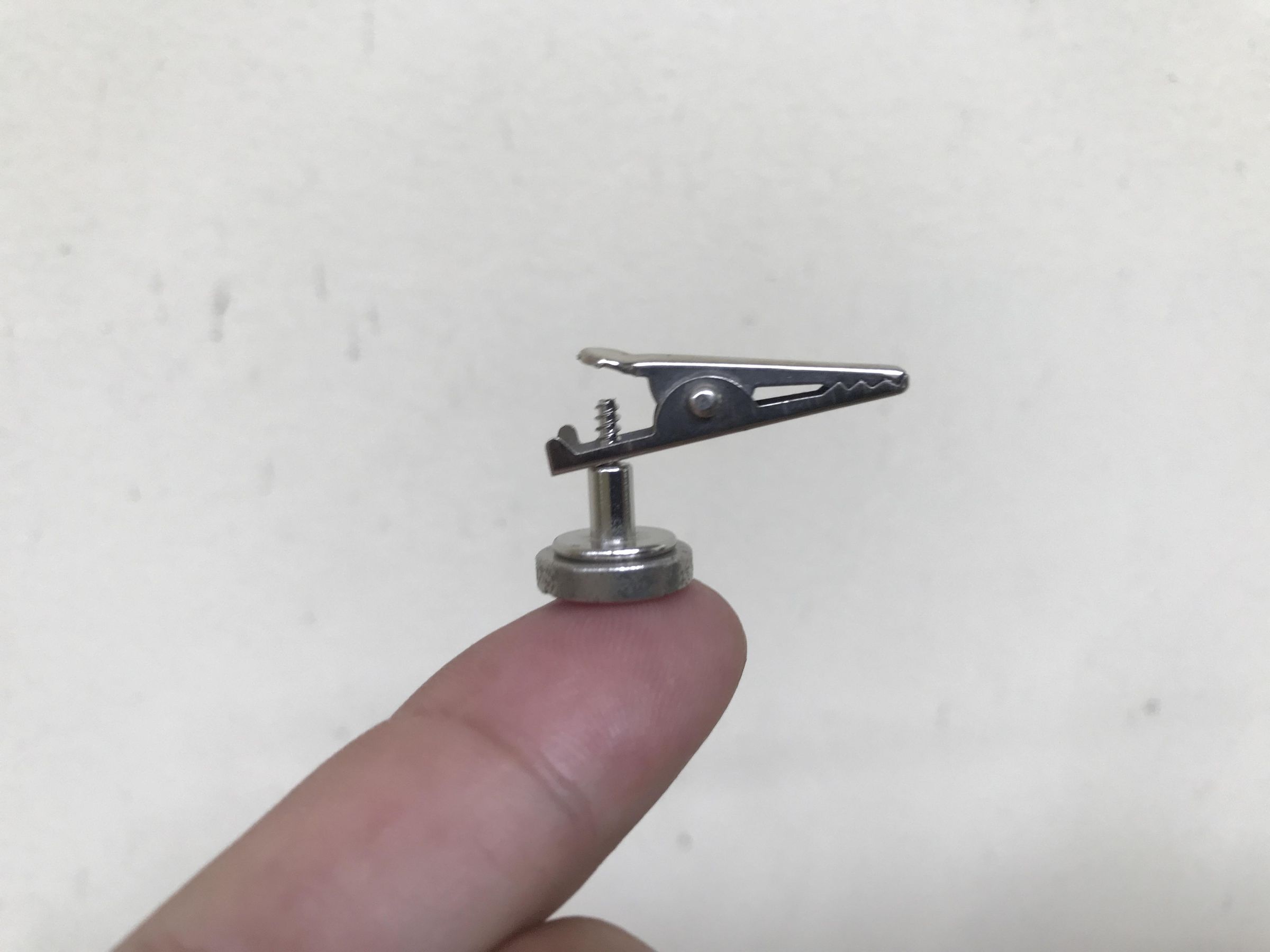

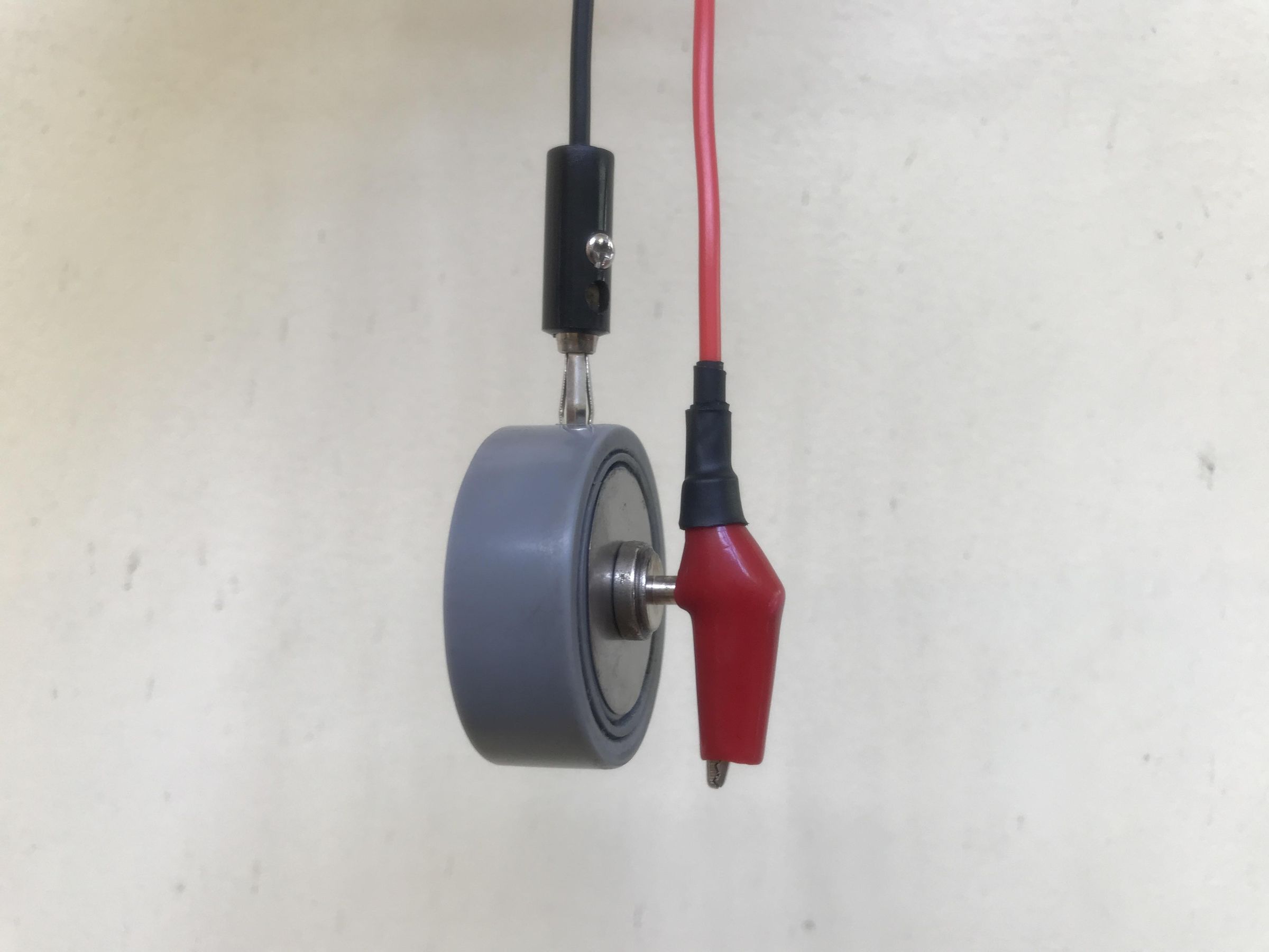

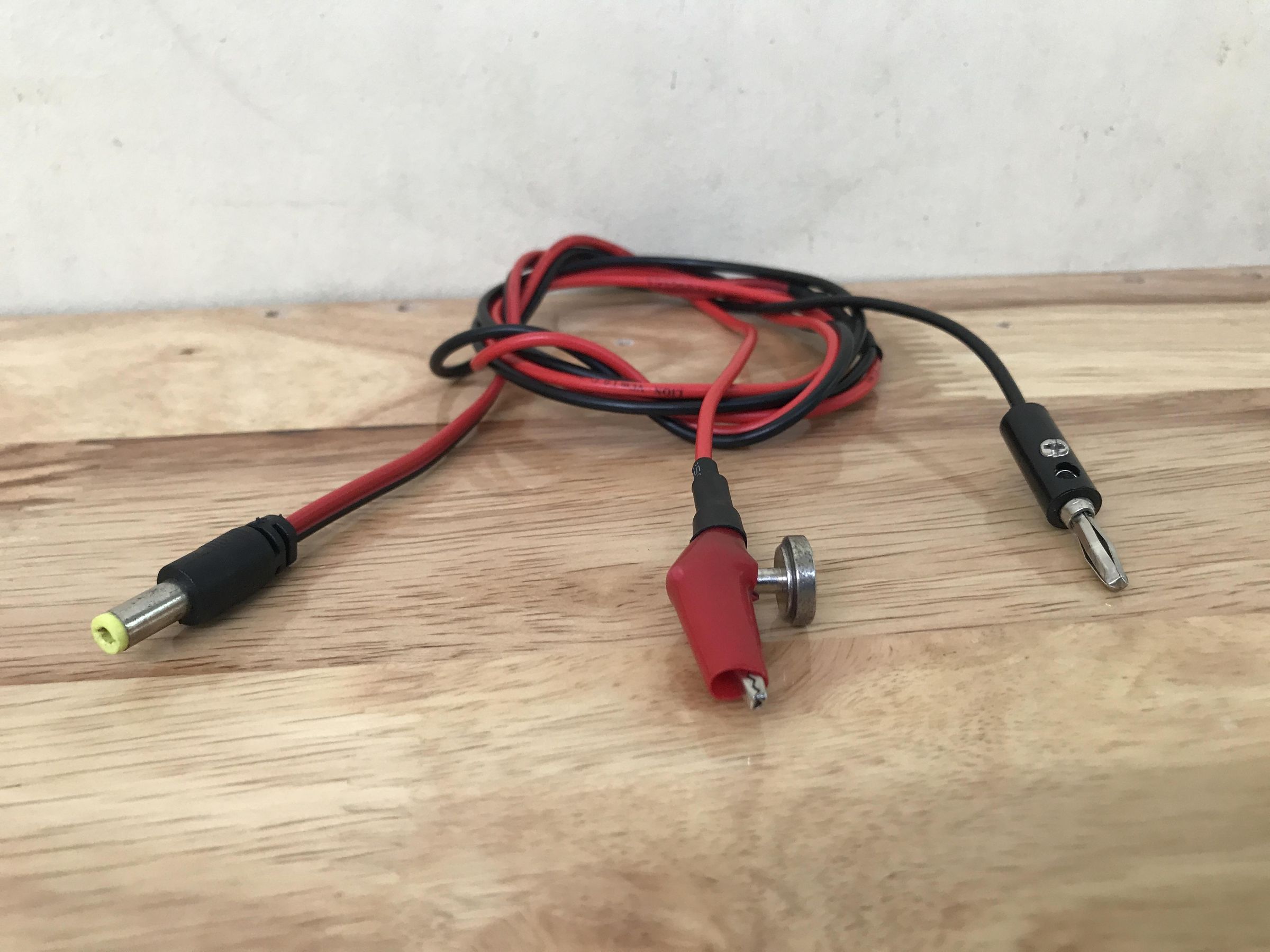

This is the second one I made, it is more compact, can be clipped or used with magnet.
Firstly, I found a screw that could be fitted into the alligator clip hole and tightened it. This screw has a flat surface, round shape with a diameter roughly the same as a magnet.
I soldered this alligator clip to the red wire and covered it. Since neodymium magnets can lose their magnetic ability due to soldering, I had to carefully glue a magnet onto the screw head using super 502 glue. Note that this may cause an electrical insulation between screw surface and magnet.
A black wire was connected to another banana connector on one end. At the other ends, two wires were connected to a DC power male plug.
Done!

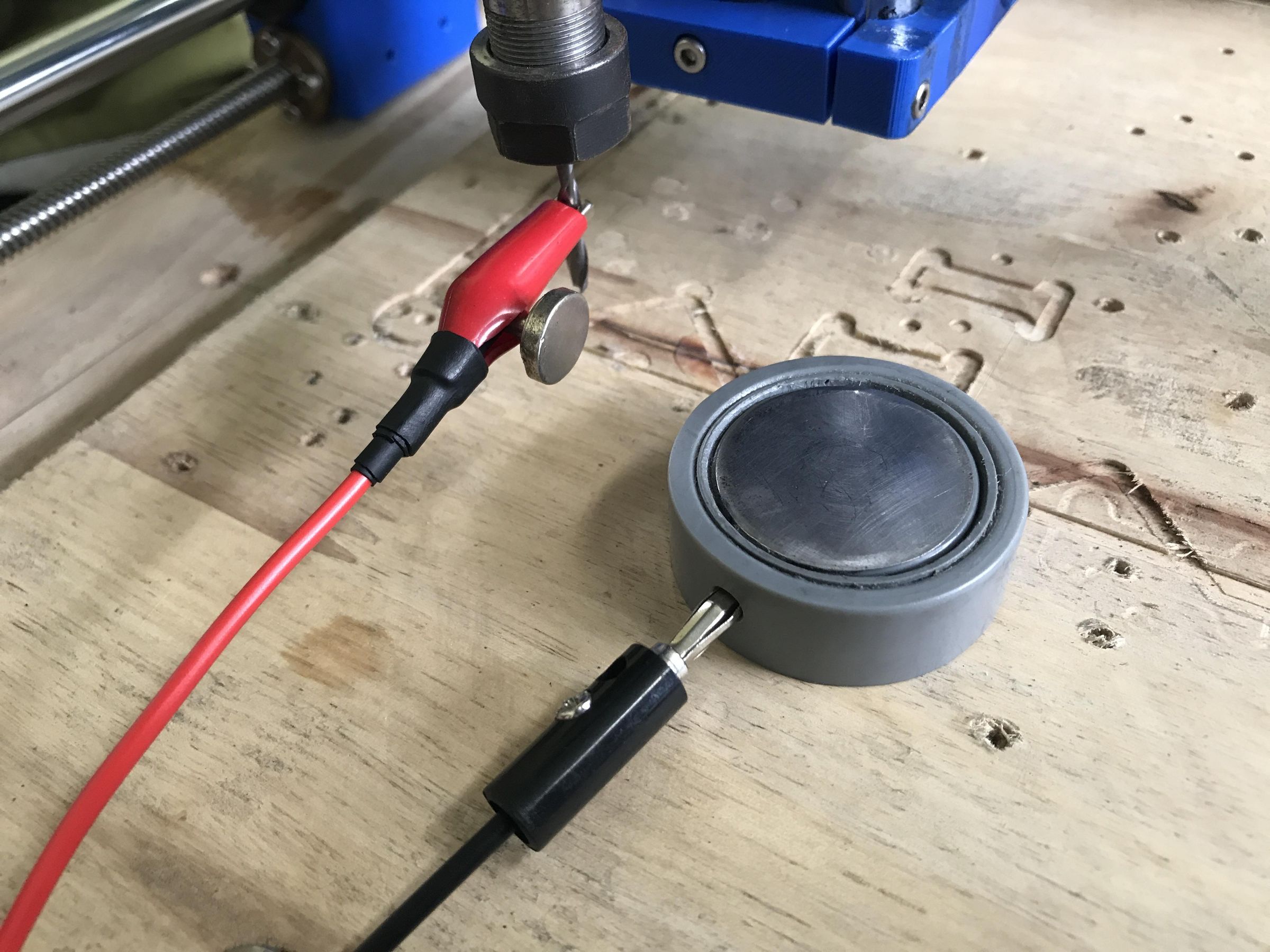

I tried using 2 versions of Z probe on my Dremel CNC machine.
Version 1:
Version 2:
⦾ Magnet
⦾ Clip
