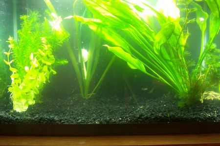

Introduction: DIY CO2 Reactor for a Planted Aquarium
This instructable will show you how to make your very own cheap and effective CO2 Reactor for a healthy, green planted aquarium.

Step 12: STEP ELEVEN
Have a beautiful planted tank.
At night, when your lights are off, run an airstone to prevent pH swings.
