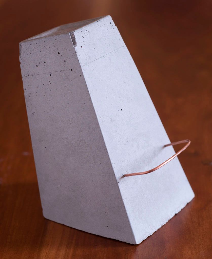

Step 5: Sand, Grind + Make the Concrete IPad Ledge
5.1 Flatten the base by sanding the bottom surface with a rough 120 grit hand-held diamond polishing pad. Alternately use a belt sander and ideally a 5" wet polisher with diamond pads suitable for concrete.
5.2 Using a hand saw, band saw, or tile saw, cut a ledge that fits in the groove created by the knockout. The easiest thing to do would be to start with a piece of wood that is the same thickness as the knockout (½" in this example). Softer woods will be easier to cut with hand tools if you don't have access to a band-saw. You don't really need power tools for something like this. Check out the episode Sawing Secrets from the Woodwright's Shop on PBS for some tips on working wood with hand tools.
5.3 Finish the concrete with CHENG sealer and CHENG wax before gluing the ledge in place with two-part epoxy.
