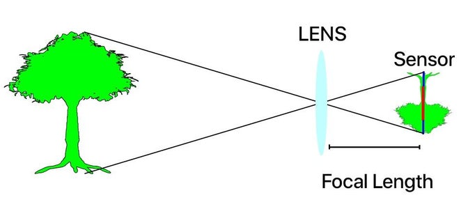

Step 2: How a Lens and Sensor Work Together
Quick Explanation:
A camera lens focuses light from the scene onto the camera's sensor.
The sensor is the digital equivalent of film—it records the image.
Key things to know:
  1. Focal Length of the lens affects how “zoomed in” the image appears.
  2. The sensor size determines how much of the image is captured.
  3. A smaller sensor (like in most compact cameras) gives a more zoomed-in view from the same lens. This is due to the crop factor.
Example:
A 200mm lens on a compact camera with a 5x crop factor behaves like a 1000mm lens!
So, by using a high-quality lens with a small sensor, you can get:
  1. Super zoom
  2. Nice bokeh (background blur)
  3. More light gathering for night shots
