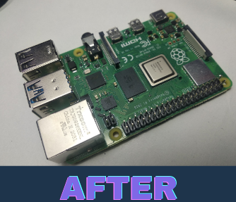

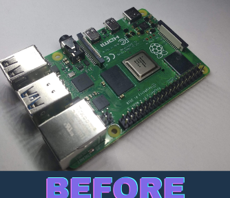

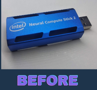

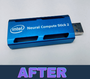

Step 9: Final Test
I am using this lighting for Macro Photography of my projects and electronic builds.
You can see the difference directly ,after using the light and before.
Before I had used Normal LED Strip Lighting so there are interference Shadow Patterns Generated in my photos which is much Annoying,
After using the Light ,all shadows was gone and it got a uniform Lighting.
This DIY Photography Hack costs less than 5 Dollars, and Using household items like Aluminium Foil and Cardboard one can build it easily.
