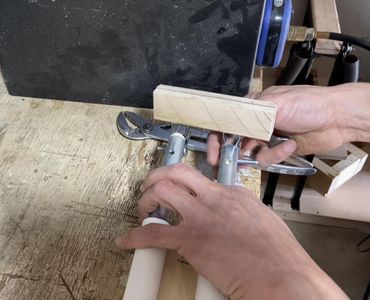

I cut the 10-foot conduit in half, leaving (2) 5-foot sections(pics 1-3). Next, I took some sand paper to smooth out the metal. Usually the metal conduit has letters/numbers stamped that can cause some areas to be raised.
I cut the PVC pipe in (2) 4-inch pieces and slid those on the conduit to act as the slide (pic 4). I used 2-part epoxy to attach a piece of scrap wood to the top of the PVC pieces and let that dry overnight (pic 5).
TIP: if you leave the stick & leftover mix on the workbench, it will give you a feel of the dryness of your project. If you leave it overnight, it is kind of a moot point but still a good thought if it is cold and/or humid.
With that piece dry, I screwed on 2 other pieces of wood to keep my phone loosely secured from falling over. Kind of like a barrier.
I added some felt pieces (pic 6) to the inside of the PVC so that they would ride smoother on the conduit, attached the (4) 1/2-inch conduit hangers to a couple of pieces of spare blocks (pic -9), and called the slider carriage good.

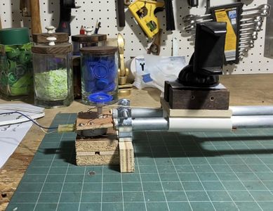

I tried various DC and AC motors but wound up using a 34 RPM asynchronous motor that I salvaged from an old microwave. This speed is right in a sweet spot that I was looking for. In my testing, I had a 6 RPM motor since those are the more common ones to scrap, in my experience. However, using the 6 RPM one lead me to have to speed up my footage in the final edits.
I secured the motor (pic 1) to one end of the carriage using a piece of scrap wood that was screwed in place (At first I prototyped using a piece of double sided tape and even Velcro but those slipped every time, too flimsy). I then tethered the motor with twine to the cameral slider. I simply stapled it in place under the wood plank holding the camera (as seen in previous step). This acts only in one direction, however. One thing I would like to do is to attach pulleys at both ends so that it may slide in both directions without me having to unwind it every time.
The shaft of the asynchronous motor was plastic and in my experience they generally are. This helped me to drill a hole for the string but also to tap the shaft (pics 2-4). That way I could put a cap on the end to keep the wound twine from slipping, again, making for less than smooth footage.
