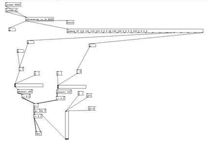

  • to read sensor data and manipulate the data on your computer for controlling graphics or audio

  • Software : Arduino IDE, Processing IDE, Pure Data (all free software)
