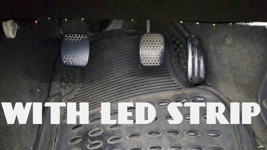

Many People Drive late at night,Because of this there is not sufficient light To see the Brake,Clutch & the Gas pedals,But with This Hack You Can Prevent All These Things And Drive Safer.
It Looks Cool As Well!

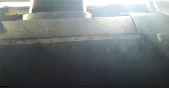

Step 2: Placing the LED Strip!
Now We Need To Place The LED Strip Under The Steering wheel I Found A Good Spot Under The Steering Column.
Since The LED Strips Are Self Adhesive We Don't Need To Apply Any Kind Of Glue To it!

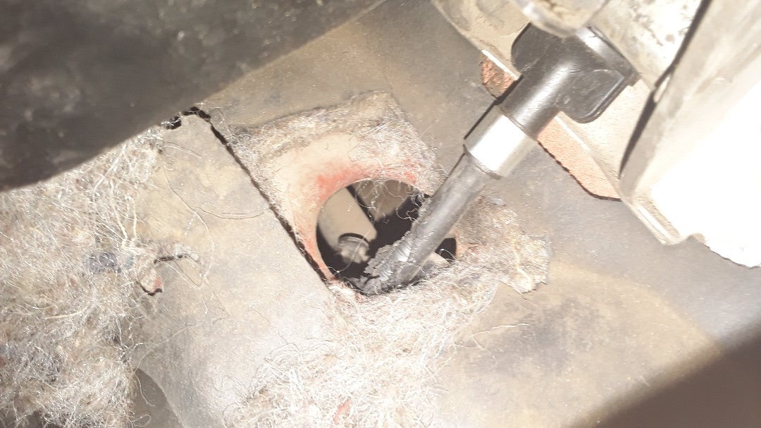

Step 4: Finding the Firewall!
Now To Connect The LED Strip With The Car Battery We Need To Find The Firewall of The Car.
In case You Don't Know What a Firewall is. It Is the part of the bodywork that separates the engine from the driver and passengers.
I Found Mine Near The Clutch,We Need To Pass Two Wires Through it.
One For Positive & One For Negative!

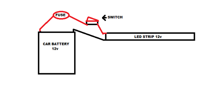

Step 5: Wire Everything Up!
Now Its Time To Wire Everything Up.
Positive from LED STRIP>Switch
Switch> Fuse Holder

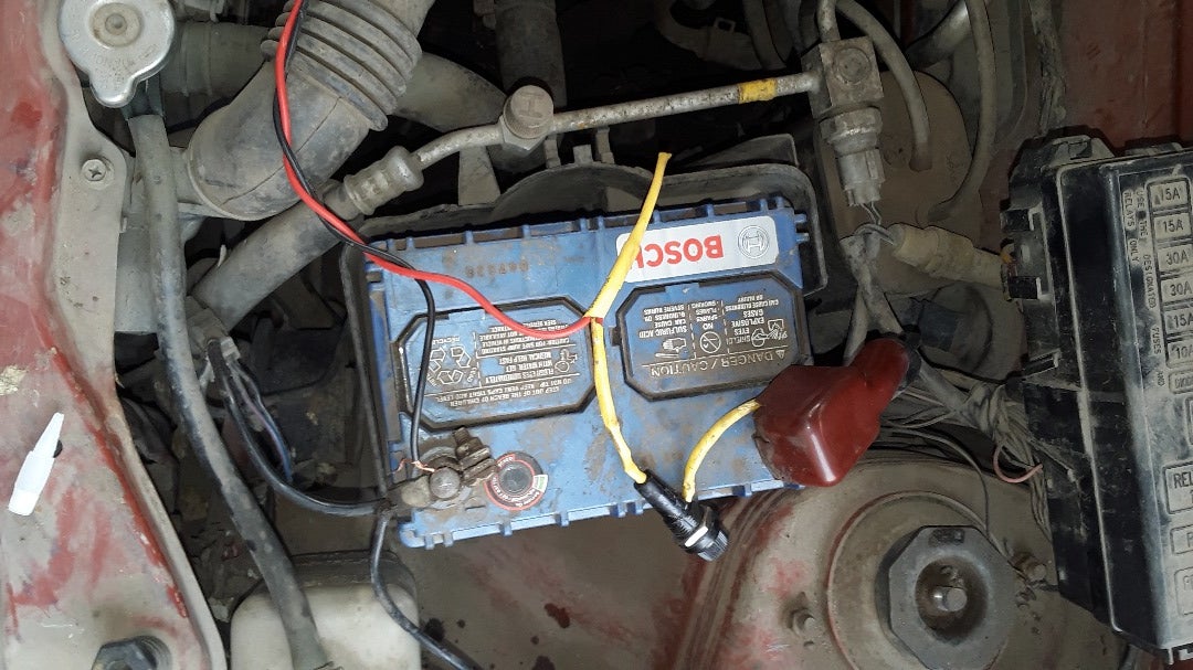

Fuse Holder > Car Battery
LED Strip Negative> Car Battery Negative!
