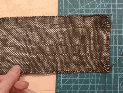

Carbon fiber is an undeniably cool material. It's fire resistant, in case your pocket or purse regularly bursts into flames, and carbon fiber is often used to block RFID signals. It has an incredible strength-to-weight ratio, so it results in a wallet that's thin and durable. It has an amazing space-age graphite look, and fortunately you can get small amounts of carbon fiber fabric on Amazon. (As an Amazon affiliate I earn a small commission from purchases made through these links.)
The woven carbon fiber material that I am using produces a thin, flexible folding wallet. If you prefer a more rigid wallet, perhaps with a money clip attached, then this isn't the tutorial for you. But here are some really nice-looking ones on Amazon.
If the carbon fiber look isn't your thing, I have also used my same basic wallet pattern to make wallets out of treadmill belts and other offbeat-yet-sturdy materials. Wallets require such a small amount of material and effort, that it's worth experimenting with whatever zany supplies you've got on hand. I could see this wallet working really well in a metallic fabric, or an outdoor oilcloth like you'd use for a tent.
At least 1 yard of 4" wide woven carbon fiber material (such as this twill weave or this honeycomb weave)

You can cut all of your materials separately, but I recommend cutting the Heat 'n Bond to the correct size, fusing your materials together, and then trimming the carbon fiber and lining fabric to the edges of the Heat 'n Bond. This method works very well because once the material has been bonded, it cannot unravel. So you won't have to worry about the edges of the carbon fiber fraying after it's been cut.
You will notice that I used 3 different widths of carbon fiber for the wallet, but I didn't want to trim the carbon fiber lengthwise to get the narrower pieces. That would reduce the strength and increase fraying as I cut into the selvage. So, I just pulled the carbon fiber on the bias (check out the .GIF to see this process in action) to reduce the width. I fused the 8" x 4" piece for the pockets without pulling it at all, to use the full 4" width. Then I pulled it a little bit to fuse my 3.75" wide piece, and pulled it a little harder to bond it to the 3.5" wide piece of Heat 'n Bond for the wallet front. Reducing the width this way does result in some triangular scraps of material (because you are angling the edges when you pull the material, and then later cutting them straight again). But I still had enough material to work with.
