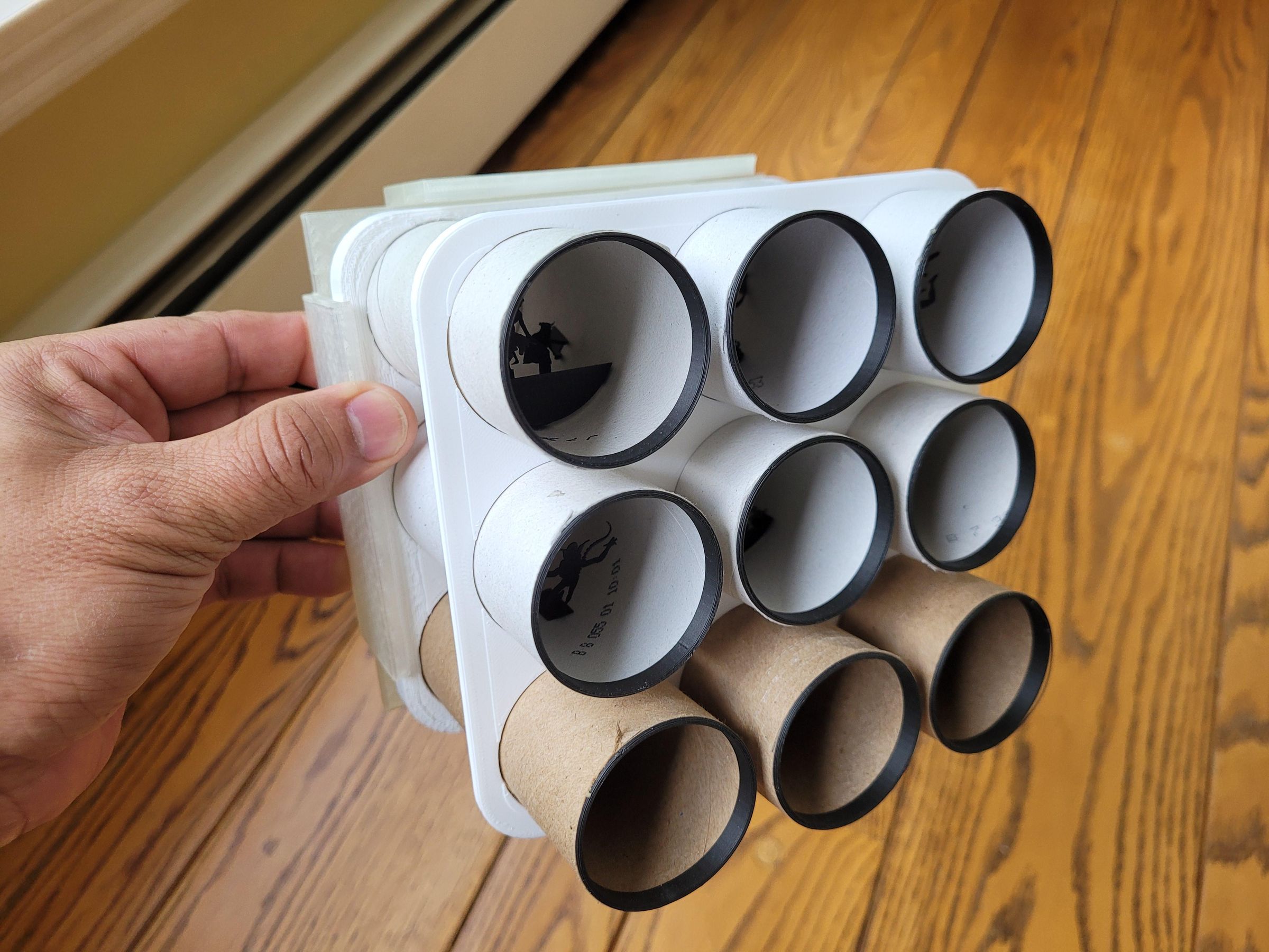

Attached are some pictures of projects my kids and I worked on to give a sense of what you can do with this cool machine. Also, some pictures of my son, and other kids using it. We had an exhibit at the Bergen Makerspace (Hackensack) on New Jersey Makers Day (March 25, 2023).
