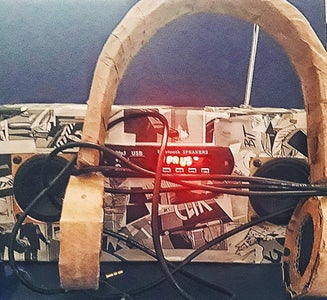

Before you start building the frame prepare a small piece of wire (or something springy), this wire will be inside of a cardboard frame and she is there simply to make the frame more springy and durable. In my case, I took about 1 meter of small diameter wire and I cut it into smaller pieces (about 33cm each) and then I twisted them together. Before you start making the frame measure your head :D, from ear to ear, and use those dimensions for the length of the cardboard strip (make 2 of these) that would become the frame (mine strips were about 3 cm wide).
Before you glue the wire onto the cardboard strip make some splits in it, the reason for this is simply to make it easier to bend into reversed U shape. Once you make some slits on a cardboard strip glue a previously prepared piece of wire onto it and start bending it into U shape.
Step 2: Making Frame 2/3
To complete the frame make two smaller strips and glue them onto the U strip one from each side of the wire ( so it is a small strip of cardboard then wire then again a small strip of cardboard). Before you complete the frame place in the frame two wires ( these are for speakers) and glue the strip of cardboard onto those two small strips you made before.
This maybe looks confusing at first but it is a really simple process once you look at the photos explaining them.
Step 3: Making Frame 3/3
To complete the frame I wrapped mine with paper (this cardboard paper was inside of the cardboard box). I was planning to paint these headphones, but later I dropped that idea.
You can skip this step this is just for aesthetics At this point you should end up with a completed frame with two wires coming out of each end, once again these 2 wires are for speakers.

Before you start assembling earbuds solder two wires on the speaker (those are the same 2 wires that you prepared in the frame). The Schematic is simple Speakers have two contact points (+ and -) each, solder minus points together, and then attach GND from the audio cable. Then on the + pole of the right speaker connect the right wire of the headphone jack, and on the + pole of the left speaker connect the left wire of the audio jack. ( I explained this in one of the previous steps if you don't know which is left and which is right you can easily check it with a multimeter or by trial and error).
In step before you made 6 circles (3 for each side L and R). Start by gluing one circle on the back of your speaker, and then glue one circle without a hole on the speaker magnet, and then the last circle goes on the front side of the speaker. Repeat this process for another earbud.
