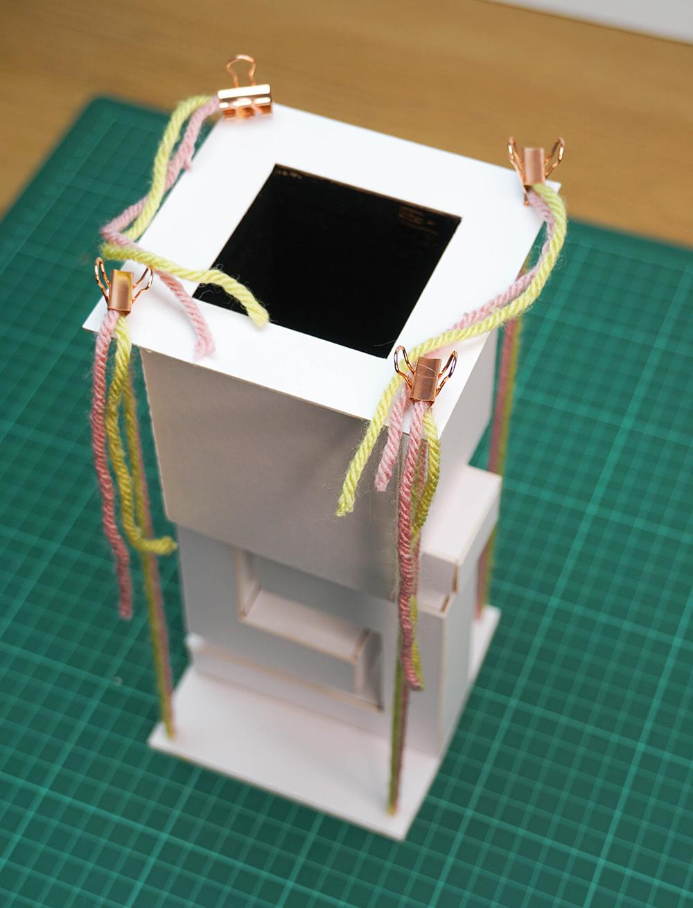

Step 11: Balance
Once the glue has dried, you will need to feed the strands of yarn leaving the base into a yarn needle, and then take this needle through the corresponding hole in the pen holder lip.
Then do you best to add clips to the yarn strands at the top so that they are all as equal in length as you can get them.
Place this entire piece the right way up and keep adjusting the clips until the pen holder is even and balanced.
Then twist these clips in one direction to twist the yarn strands together. Try and have them all twist roughly the same amount.
Use a pen to now mark the yarn strands where they now sit just above the mountboard top.
Remove the clips and knot the pairs of yarn strands together, trying to get the knot to sit where you just made the pen mark.
If everything is still even and balanced, you can now glue these knots in place and add another knot on top.
If it's a little wonky, you can twist the knots to tighten the yarn strands in order to balance everything out again. Then glue the knots in place.
Lastly, once you're happy with it you can cut off the excess yarn.
