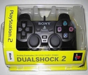

The RC transmitter is mainly based on pic 16F84 microcontroller and an old PS2 joystick. Hence, the transmitter sends 6 bytes of control, i.e. Throttle, Pitch, Roll, Yaw, and two other bytes for the PS2 buttons status. Moreover, the radio transceiver nRF24L01+ has been used to send data, while the Nokia 5110 LCD has been used to print the current values of Throttle, Pitch, Roll and Yaw. All different modules are interfaced with the 16F84 via the SPI protocol using a bitbanging method, because the basic 16F84 does not support the SPI hardware.

- PS2 joystick

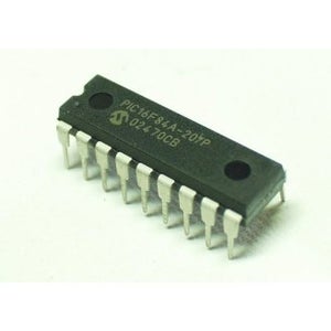

- Pic 16F84

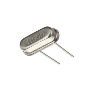

- Crystal 4Mhz
- 2 x capacitor 27pf

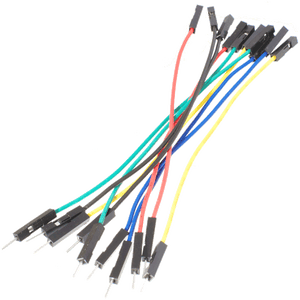

- Wires for the connection

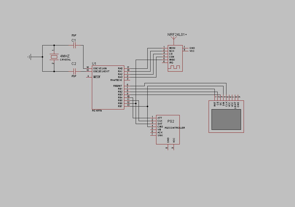

Step 2: Schematic and Source Code
The three modules (i.e. nRF24L01+, Nokia 5110 and PS2 joystick) are interfaced using a bitbanging SPI protocol.
The source code is written in assembly language and is available from the below github repository.
