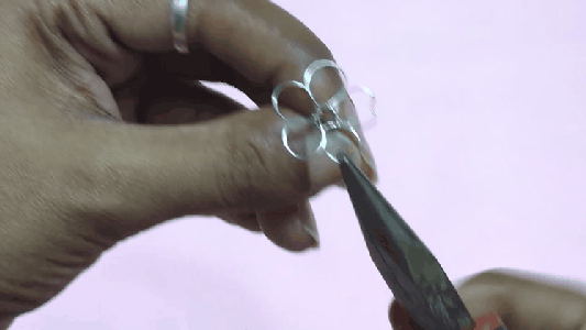

Step 4: Petal Spread
we are making five petal, keeping real cherry blossom flower as inspiration. Spread it, turn it and twist the last petal to first petal using vertical wire.
Step 5: Shaping
For making cherry blossom, use flat nose plier with slightly pinch in each petal, two ways. shape all five petals.
