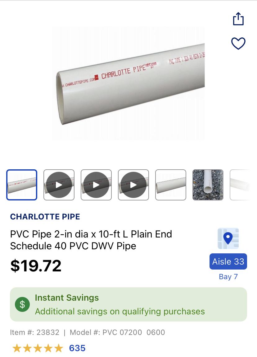

1 5-ft section 2” PVC pipe

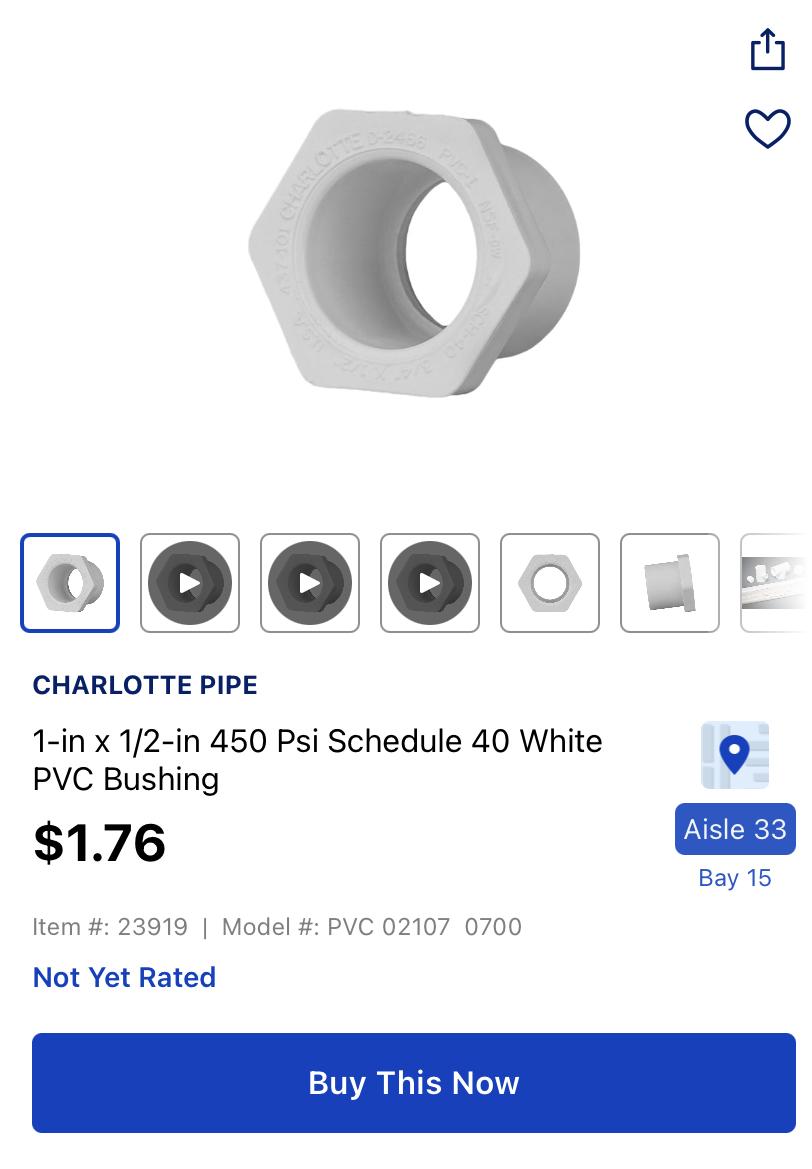

2 1.5”x1” White PVC Bushing (smooth NOT threaded)

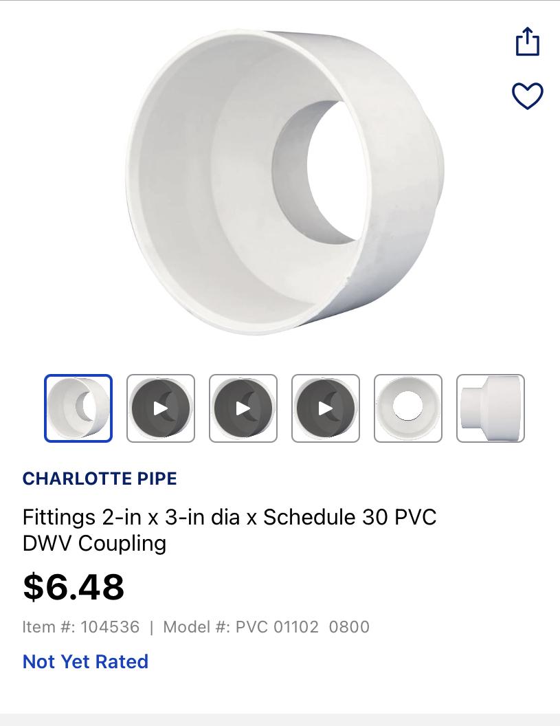

1 3” x 2” PVC pipe Reducer

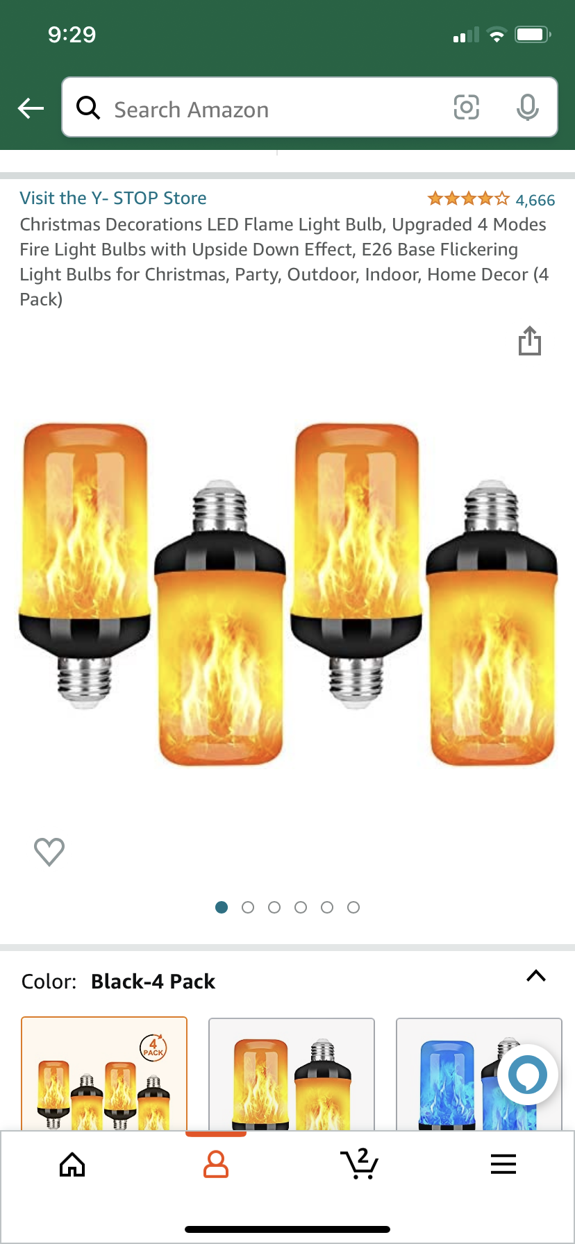

1 LED Flame Light Bulb

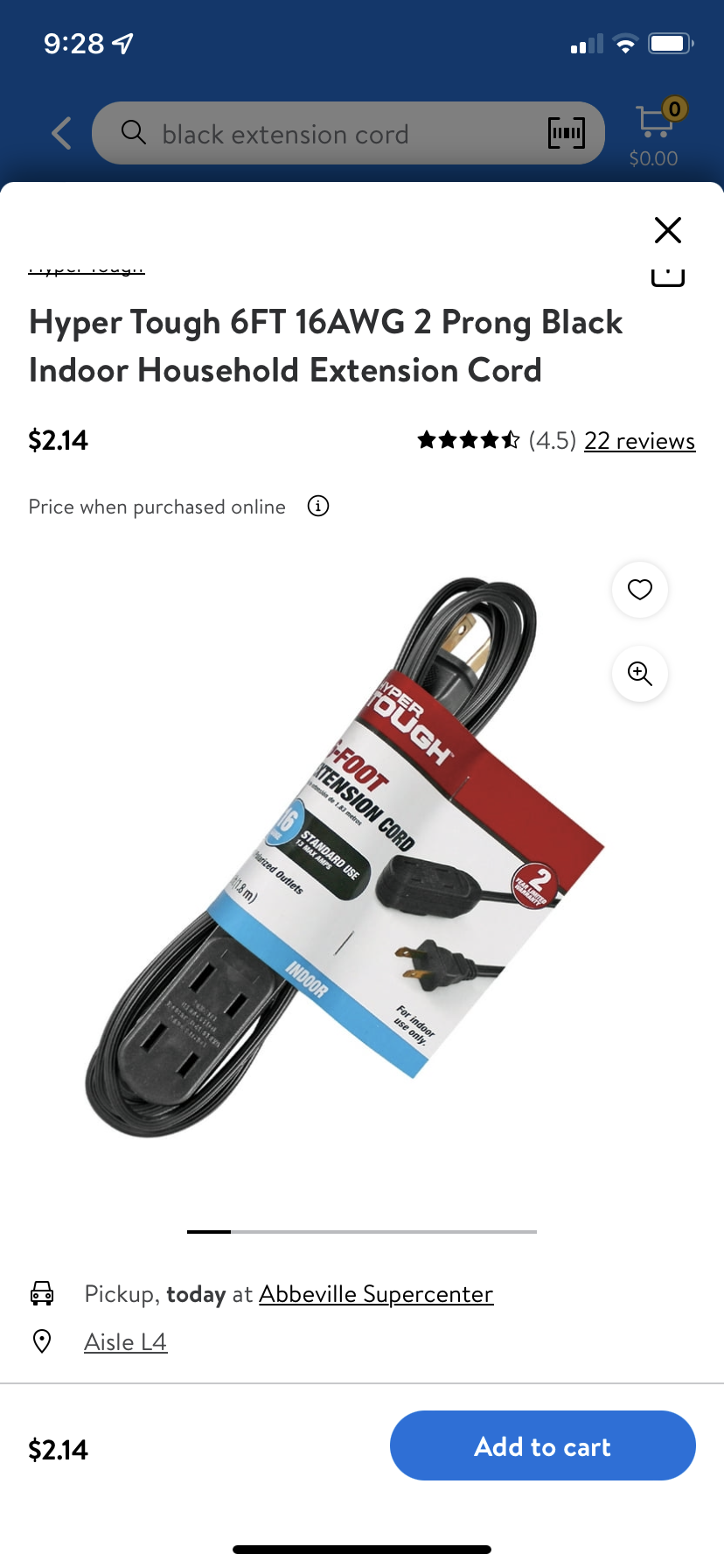

1 6’ extension cord

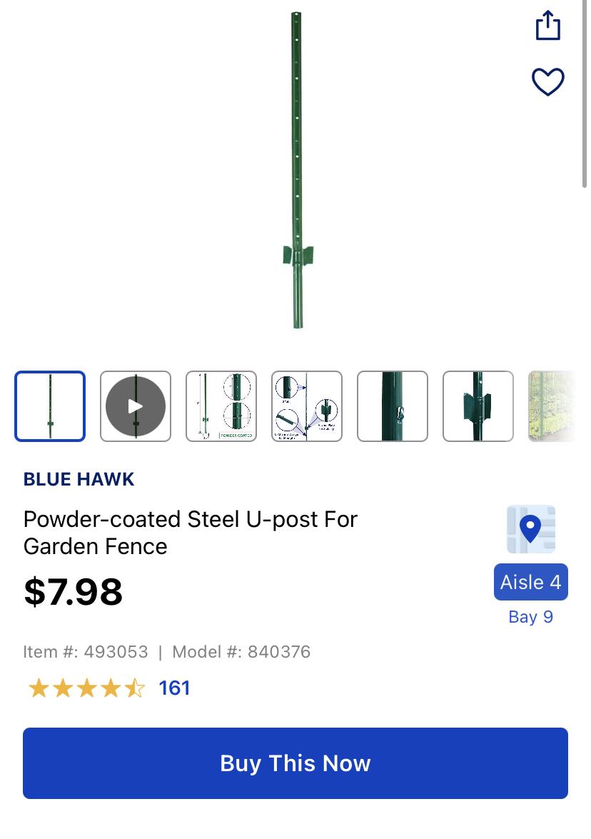

1 5-6 ft T-post (optional but recommended)

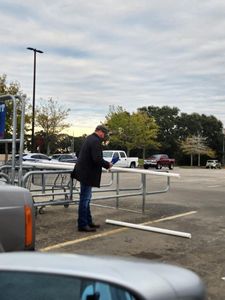

The first thing is to cut the PVC pipes to length. I found that it was much cheaper to buy longer PVC pipe and cut to length than buying the exact lengths AND you’ll need to cut the 2” pipe anyway so you may as well save some $$$.
I went to my local big box store and bought 2 10’ length of 2” PVC and 1 10” length of 1” PVC. I was making 5 lampposts so this met most of my needs. Obviously if you’re making less, just buy what you need.
Side note: I don’t own a truck and I’m not driving around with 5 feet of pvc pipe hanging out the window, so I brought my 2” pvc pipe cutter, bought the 10’ lengths and just cut it in the parking lot!
Using your pvc pipe cutter (or hacksaw/miter saw) cut your 2” PVC pipe into 5 ft sections. Then cut 6” from either end of the 5 ft section.

Using your 5/32” drill bit, screw three evenly spaced holes in the 3” section of the 3”x2” pvc reducer.

First, insert the 1.5” x 1” PVC bushing into the east and west portions of the hub. This will allow you to insert the 1” PVC sections into the hub.

Finally, insert the 2” portion of the 3”x2” PVC reducer onto the top of the north leg of the cross and secure with mallet.

Screw in the flicker light bulb. i got the lamp and bulb pictured on Amazon. The bulb is plastic, so don’t worry about breaking it.

Side note: I know the plug and the extension cord are not rated for outdoor use but they will be enclosed in the pvc pipe with very minimal (if any) exposure to moisture, so I’m not going to worry about it.

Thread the 6 ft extension cord through the north and south legs of the lamppost.
Run the male plug of the wreath lights through the 1.5” hole in the north leg of the post and thread it out the top.
Plug the lamp and the wreath into the extension cord. Temporarily plug the extension cord into a power source to make sure the lights are functioning then unplug from power source.
Stuff the wiring into the 2” pipe then insert the neck portion of the lamp into the 3” section of the 3x2 reducer.
Insert a 32x1 machine screws just into the three 3/32” holes you screwed into the 3” section earlier.
Next, SLOWLY tighten the screws to secure the lamp to the post. You will want to go back and forth between screws tightening a little at a time to ensure you keep the lamp straight.

Step 8: The Base
Obviously, you will have a top-heavy structure once assembled and will want to protect against the wind.
I purchased a 4' t-post, drove it about 10" feet into the ground, put the lamppost onto the t-post and then secured it by drilling a 2" inch screw into the lamppost and into the t-post (it doesn’t actually go “into” the t-post, it’ll push up against the post and keep the lamppost from moving). Depending on wind conditions in your area, you may need to put 2-3 securing screws in place.
In my case, I didn't need to secure it. Once it was put on the t-post, it wasn't going anywhere.
