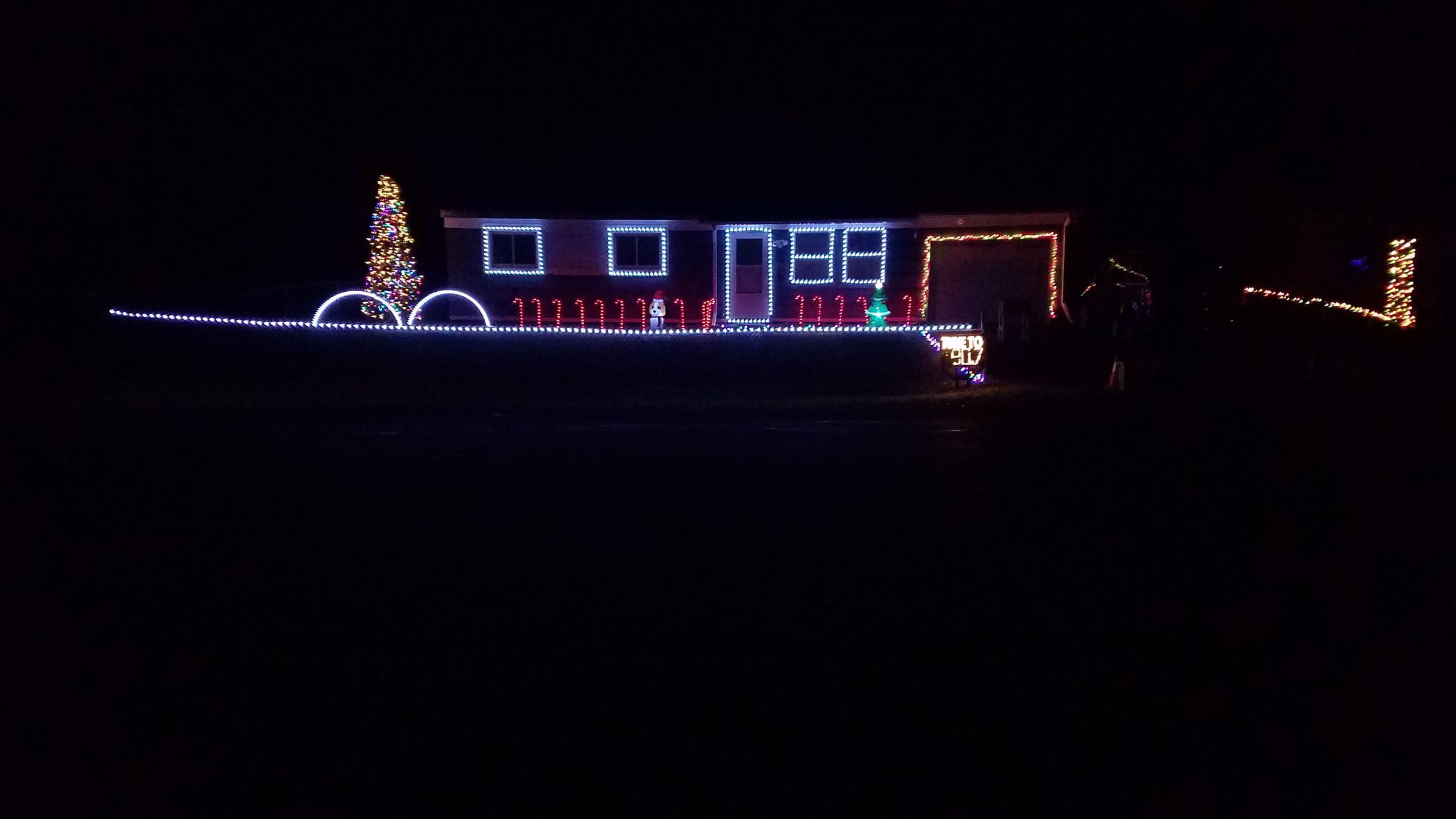

You have probably seen Christmas lights before. You plug them in and they turn on right? BORINING!!! Have you ever wanted to build a Christmas light show? If you don't know what these are, well, the way they work are you drive to a persons house with these lights shows. They have lights that can turn on and off making patterns. More advanced light can turn each led on and off with any color to make very neat patterns. Lots of people also have music that go with there lights. Well in this project, I'm going to show you how to make a small but cool Christmas light show. Now, I do have a video of how mine turned out. It was actually pretty cool. It did have music with it. Now this project cost around ~$50. Now if your reading this when it was published it's not Christmas time! But you can still build it. The video of the lights is above or here if the video doesnt work.
