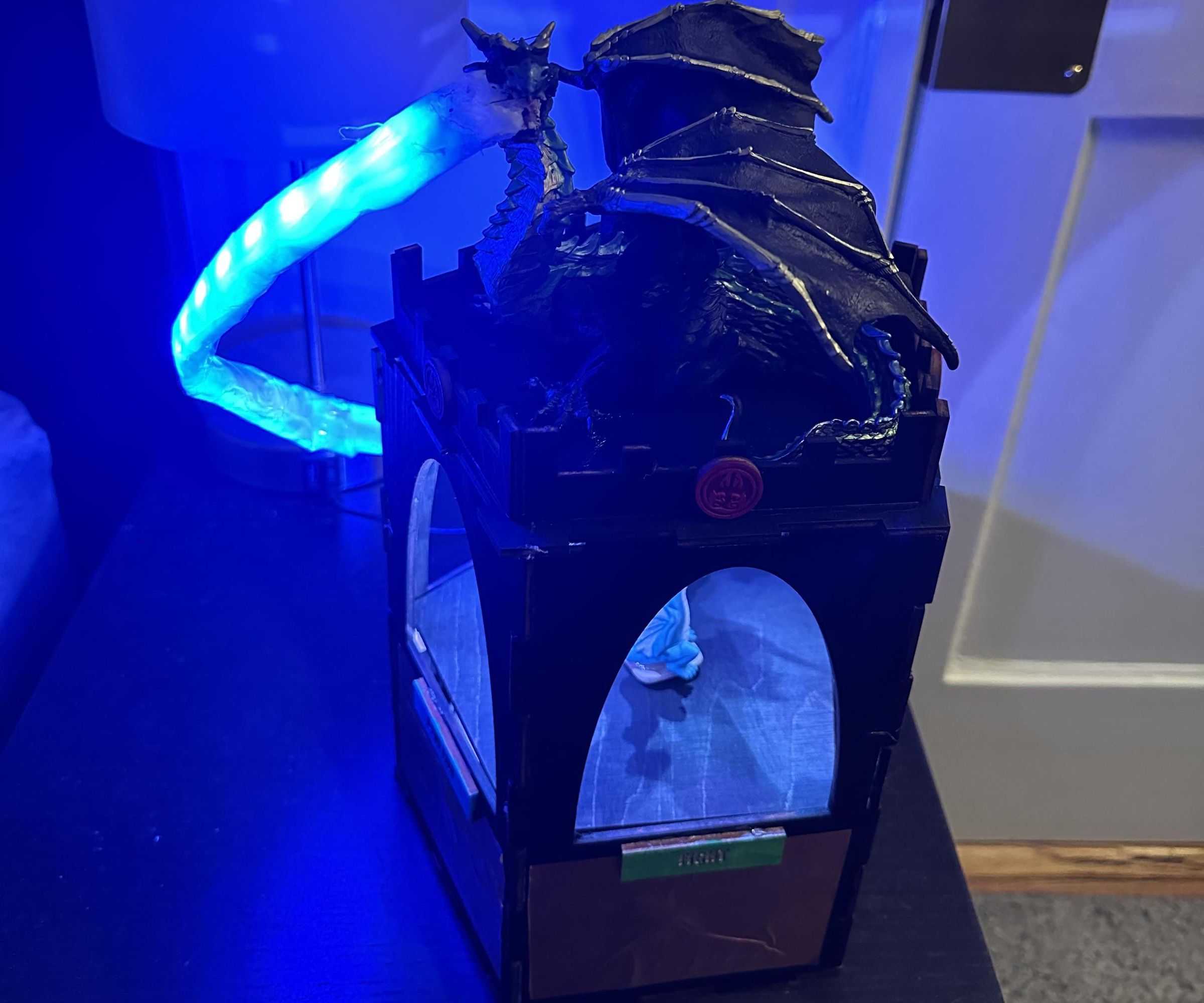

Introduction: DIY Clap Reactive Night Lamp
This project is a DIY soft-light lamp that also plays a selection of relaxing ambient noises to help fall asleep. Additionally, it has an option to set alarm if you need an alarm for the mornings. For easy convenience, the lights are toggled on and off by a clap or really any loud enough noise. The calming sounds are toggled on and off with a tap of the copper tape on our laminated piece of paper.
The lights are coded to be the color of warm-white, a yellow-white that is great for nighttime and early morning since it has limited blue light, which is better for your eyes. Calming sounds found help provide a relaxing atmosphere when you are trying to fall asleep.

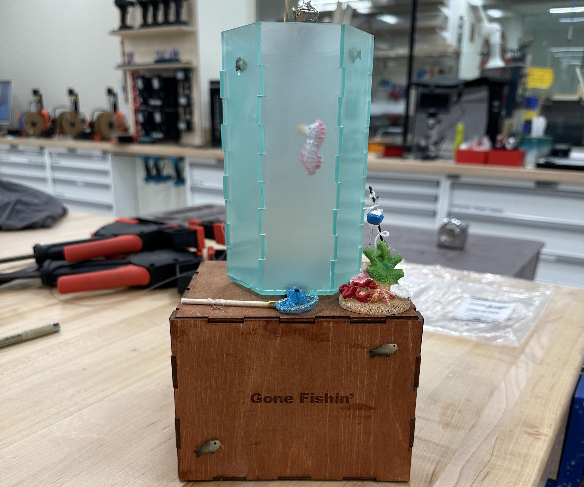

Step 5: Assembling the Lamp
1-    Carefully place the CPB in the center of the lamp, perhaps where the lightbulb should be.
2-    Using your adhesive of choice, stick the LED strips to the inside of the lamp shade. Make sure it is secure and stable.
3-    This is an optional step: you can wrap the LED in some sort of parchment or tissue paper to diffuse the light.
4-    Open the bottom part of the lamp to get a better view of the hollow inside.
5-    Place the Pico W inside the hollow lamp, making sure the wires to the paper and the speaker have a place to easily be placed outside.
6-    Make sure the power to your power source is on.
7-    Enjoy your night lamp!
