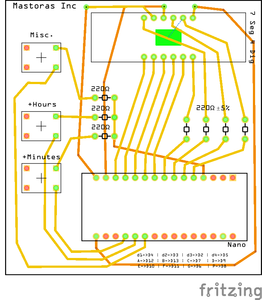

I am sharing some basic code with you. You can make the Misc. Button (A2) do anything you like. I have it adjust the brightness in this example, but other options could be resetting the clock, starting a timer, changing the time format etc. Also, on the PCB you can see the connections on the lower left corner for the display.

Step 3: Fabricate PCB
You can use my design as is, or you can make any changes you like. Try adding shapes and logos, or changing the size and shape of the board. I suggest moving the Nano a bit lower as it is very close to the Minutes Button.

Step 4: Assmble PCB
Once the PCBs arrive, and you have all of the required components for the assembly, power up your soldering iron and start putting everything together. The PCB is annotated so everything should be straightforward.
