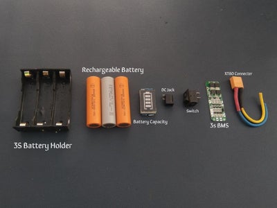

Components

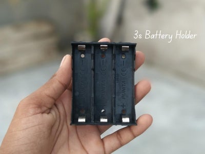

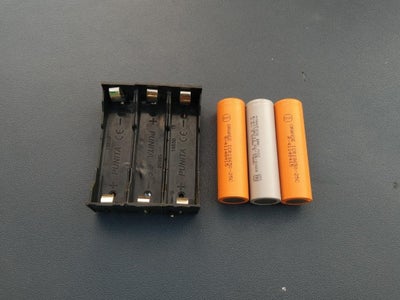

  1. 1*3s Battery Holder
  2. 1*SPDT on/off Switch

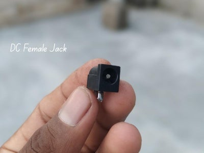

  3. 1*DC Female Jack
  4. 3*18650 Reachable Battery

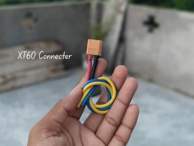

  5. 1*XT60 Female Connecter
  6. 1*XT60 Male Connecter
  7. 1*26 awg Silicon Wire

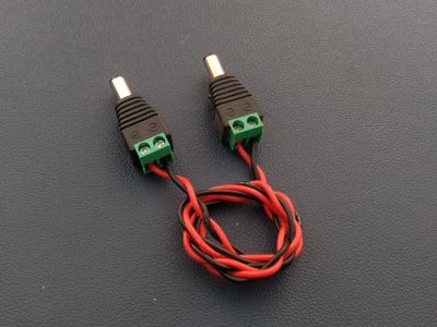

  8. 2*DC Male Jack With Screw
  9. 1*3s Lithium Battery Capacity Tester

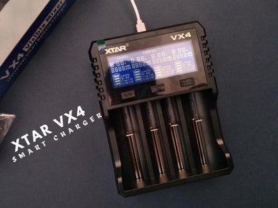

  4. Xtar VX4 Battery Charger

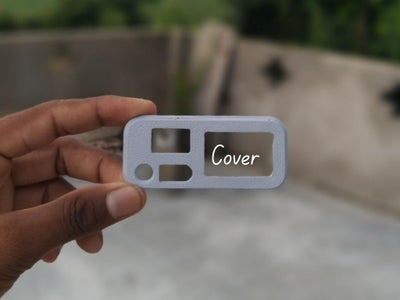

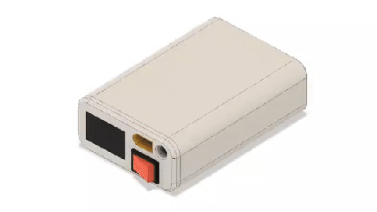

Step 1: CAD & 3D Printing
To start this project, I designed this diy mini WiFi UPS CAD using Fusion 360. It’s a simple and compact design that’s easy to print and assemble. If you’d like to view or edit the model, you can open it directly in your browser using the Fusion 360 web viewer. Feel free to customize it however you like.
For 3D Printing, You can directly download the required STL files below:
  1. Body.stl
  2. Cover.stl
For 3D printing, I Recommend PCBWay, a professional 3D printing service known for its high precision, affordable pricing, and wide range of material choices. They support advanced technologies like SLA, SLS, MJF, and FDM, delivering smooth and durable parts that are ideal for both prototypes and final builds.

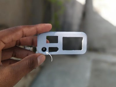

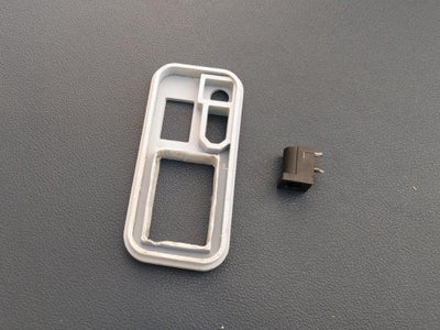

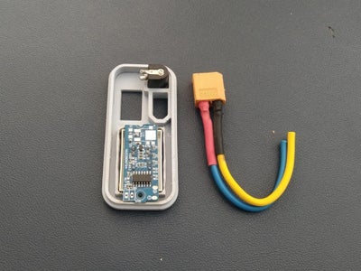

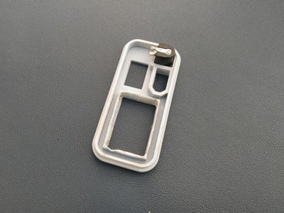

Step 2: DC Jack Assembly
Insert the DC 5525 female jack into its dedicated slot on the cover and secure it with a small amount of super glue, making sure the orientation is correct.

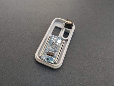

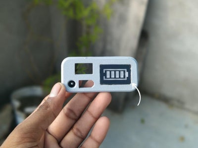

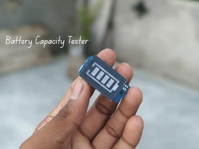

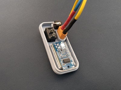

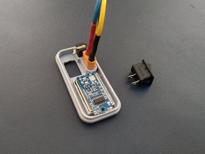

Step 3: Capacity Indicator Assembly
Place the battery capacity indicator module into its slot on the cover and fix it with a small amount of super glue, ensuring it sits flush and aligned.

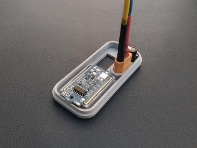

Step 4: XT60 Connector Assembly
Insert the XT60 connector into its slot on the cover and secure it firmly with a small amount of super glue, keeping the orientation correct for easy connection later.

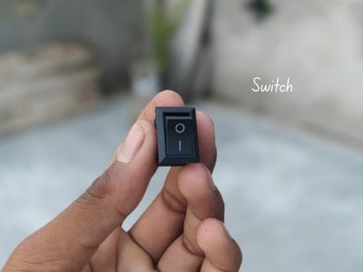

Step 5: Switch Assembly
Place the switch into its slot on the cover and fix it securely with a small amount of super glue, making sure it is properly aligned for smooth operation.

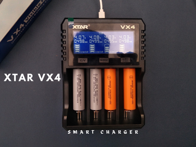

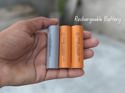

Step 6: Charging Battery
Before assembling the 3S pack, it’s important to fully charge each 18650 cell. This ensures all the batteries start at the same voltage, which is critical for safety and long-term performance. I used my XTAR VX4 smart charger to charge the cells individually before wiring them into the pack.

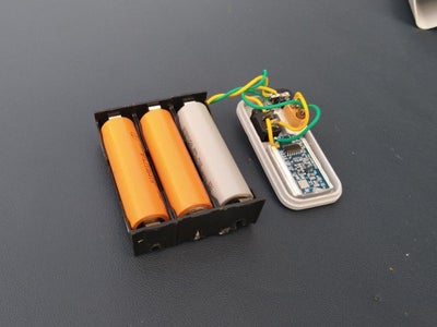

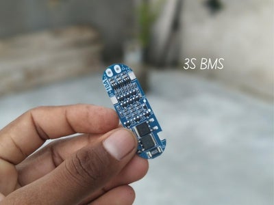

Step 7: 3S Battery Pack

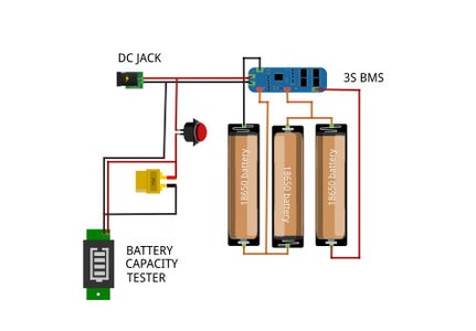

Connect the three 18650 cells in series to form a 3S battery pack (11.1V nominal). Follow the wiring exactly as shown in the diagram:
  1. Cell 1 (-) → B– of BMS
  2. Cell 1 (+) → Cell 2 (–)
  3. Cell 2 (+) → Cell 3 (–)
  4. Cell 3 (+) → B+ of BMS
  5. Junction between Cell 1 (+) & Cell 2 (–) → B1 of BMS
  6. Junction between Cell 2 (+) & Cell 3 (–) → B2 of BMS
Use the P+ (red wire) as the positive input/output and the P– (black wire) as the negative input/output.
⚠️ Safety Note: Always verify polarity twice before soldering, and keep connections insulated to avoid shorts or overheating.
Step 8: Connection
Once the battery pack is complete, Now it’s time to wire everything together carefully. Follow the sequence to avoid mistakes, you can also check the provide circuit Diagram for clear understanding.
  1. DC Jack positive (+) → Switch → XT60 connector + Battery Capacity Indicator
  2. DC Jack negative (–) → Direct to BMS negative (P–)
  3. BMS output (P+ / P–) → Goes to XT60 connector and Battery Capacity Indicator
This ensures proper charging through the DC jack, balanced protection via the BMS, and safe output through the XT60.

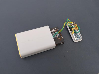

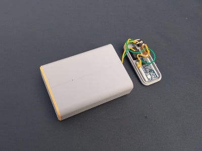

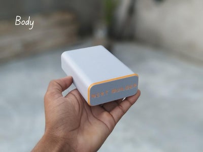

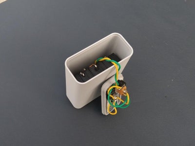

Step 9: Battery Assembly in Case
Insert the 3S battery pack into the 3D-printed case carefully, making sure it fits in the correct orientation. Once positioned, apply hot glue around the edges to secure the pack firmly in place and prevent movement inside the case.

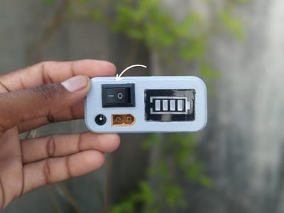

Step 10: Final Assembly
Place the cover onto the case and secure it with super glue. Before sealing, carefully double-check all wiring connections to ensure everything is correct and secure. Once confirmed, close the case firmly for a clean and durable finish.

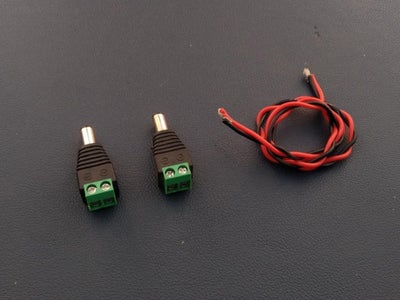

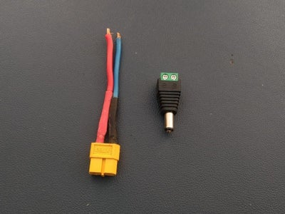

Step 11: Prepare Connecter
To make the UPS more versatile, I prepared two connectors: one DC-to-DC connector for direct input/output use, and another XT60-to-DC connector for connecting the battery pack or powering external devices. I used 26 AWG wire, which is flexible and suitable for the current requirements.
  1. DC-to-DC connector → Direct input/output
  2. XT60-to-DC connector → Battery pack or external device
These connectors make it easy to switch between charging and power delivery, adding more flexibility to the UPS.

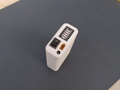

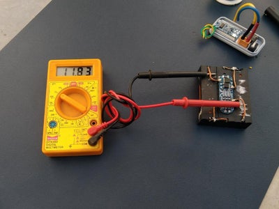

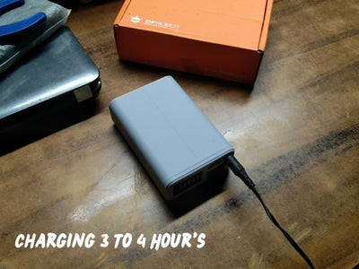

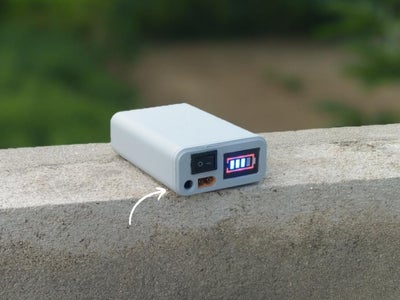

Step 12: Testing

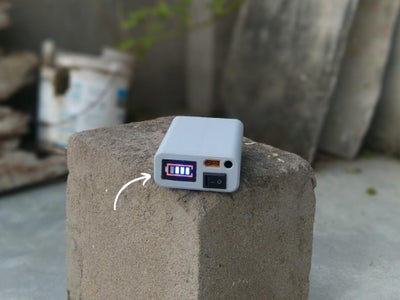

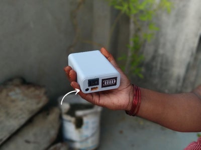

After assembly, make sure to fully charge the Mini UPS with a 12V adapter for optimal performance. Once charged, Connect it to your WiFi router to ensure it runs smoothly during power cuts. The system can also be used as a 12V power supply, or as a 12V battery pack for powering external devices.
  1. UPS Mode → Powers router during outage
  2. Power Supply Mode → Works like a 12V adapter
  3. Battery Pack Mode → Acts as a portable 12V source
This makes the mini UPS not only a backup solution but also a multi-purpose power tool for different applications.
