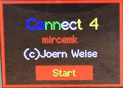

Now let's see how the device works in reality. First, when turning on, the message for calibrating the touch screen appears.
We need to touch the indicated corners to calibrate. After calibration we need to press the Start bitton to start the game.
The first player plays with red tokens and the second with yellow ones.
When the game is over, the winner's color is shown on the display. Now, by pressing the Start button again starts a new game.
