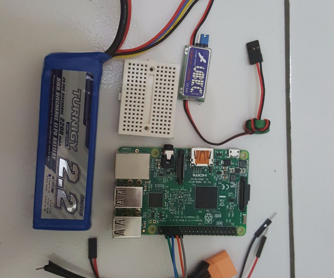

Step 2: Powering Raspberry Pi With Lipoly Battery and BEC
As RasPi 3B works as Lego car controller, it needs power supply with specification 5V and 2.5 to function normally (read for more detail: https://www.raspberrypi.org/documentation/hardware/raspberrypi/power/README.md). IMO UBEC 3A 5V or 6V would be fit in my case to convert a single Lipoly battery 3S to 5V. Besides, UBEC as switch regulator keeps the power more efficient instead of linear one (with 85% efficiency percentage). Even it's a little bit expensive, it avoids damaging your raspberry as it keeps voltage amount very still and I recommend you very strongly to use BEC. Furthermore, please ensure the output voltage range with multimeter digital and it must be in range 5V - 5.3V or it can fry your RasPi. Then, Plug the output BEC into GPIO Pin 4 and 6 (Board Mode). Wait for a while until your raspberry pi blinks green signal and lastly you might check to login to RasPi through router (wont be discussed in this topic)
