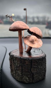

Copper can be left as is, polished, patinaed, enameled, or flame colored like the mushroom sculpture I shared here.
You can make home decor, wall art, garden and yard art, light fixtures, candle holders; and practical items like cups and bowls. The possibilities are almost endless.
