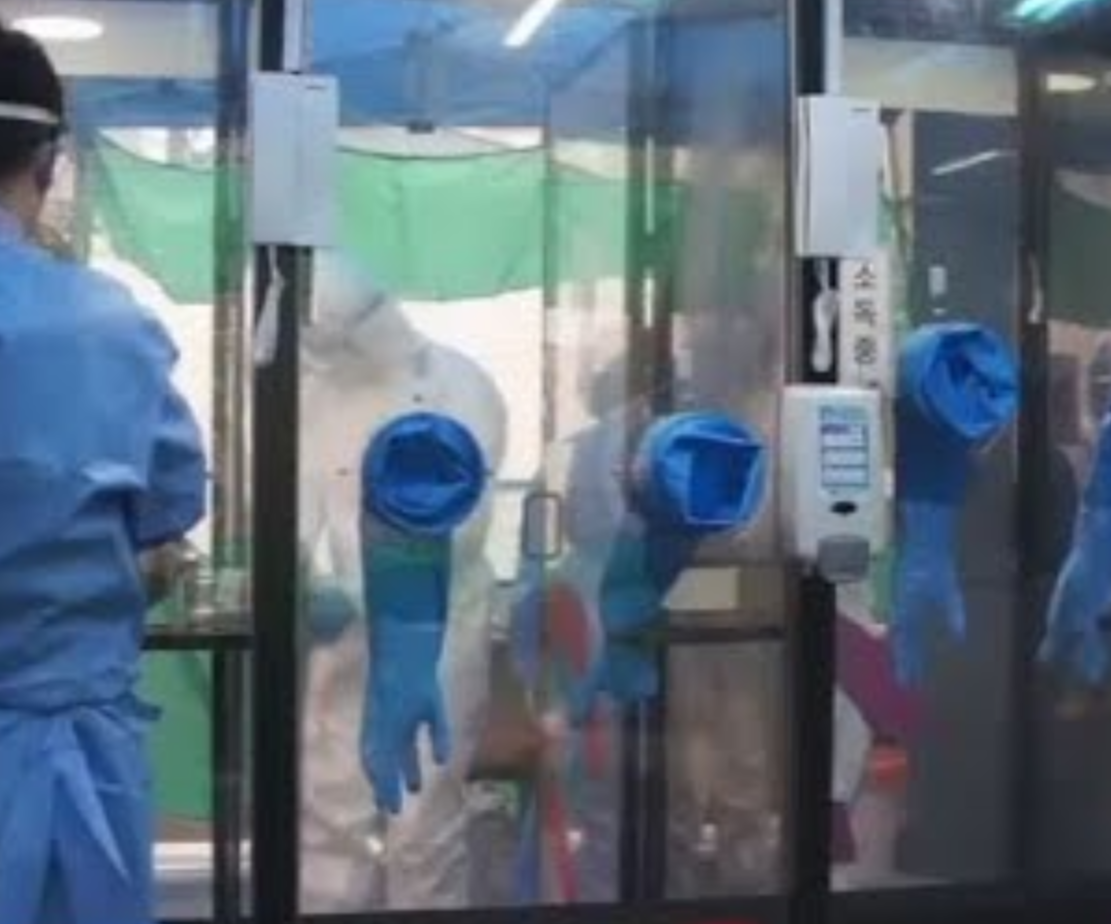

Introduction: DIY Covid-19 Test Booth. Part 4. Positive Air Pressure in the Booth
The purpose of this instructions is to provide a solution to those interested to make a "phone booth" for Covid-19 test with commonly available materials. One of the critical component is a ventilator that allow positive pressure from inside the booth.
This instruction is part 4 of DIY Covid-19 Test Booth.

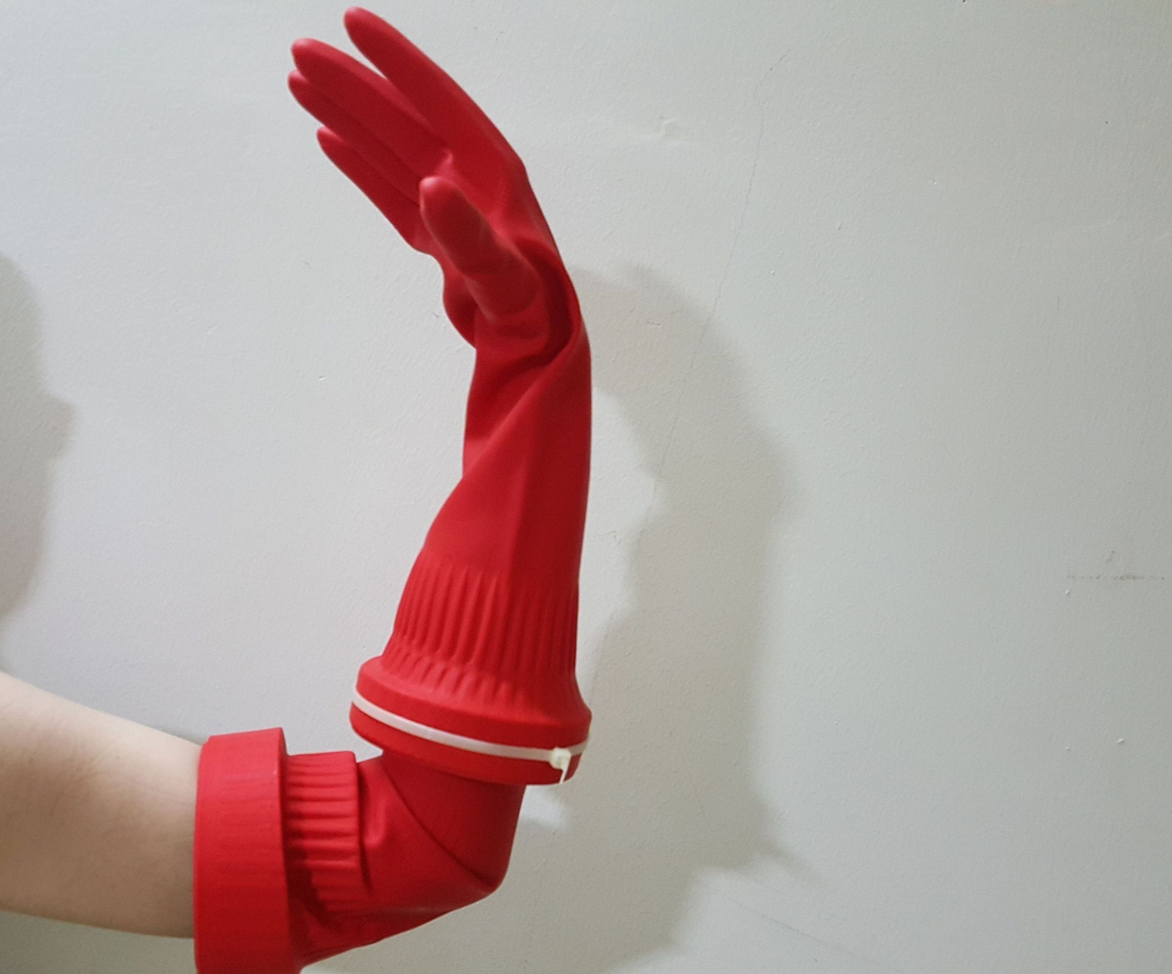

Part 1. How to Make a Long Cuff (Sleeve) Latex Gloves From Two Short Gloves

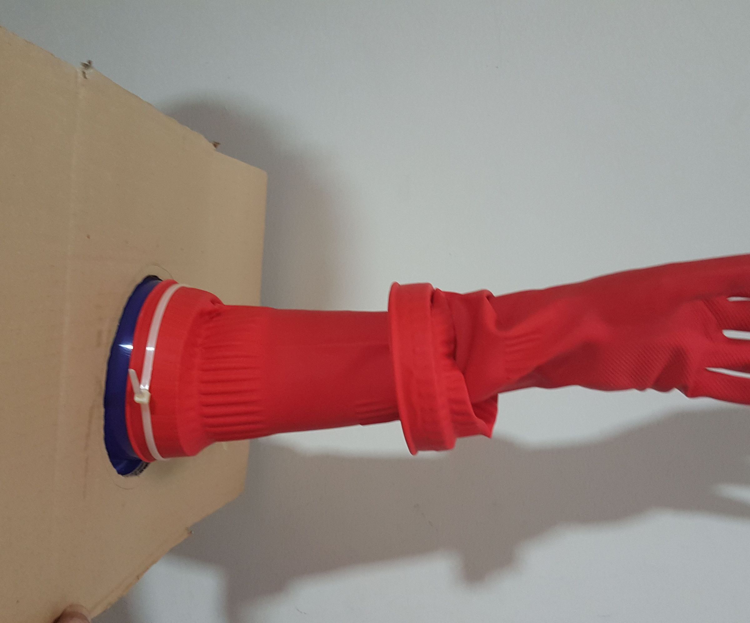

Part 2. How to make an adapter to connect the Booth to gloves
