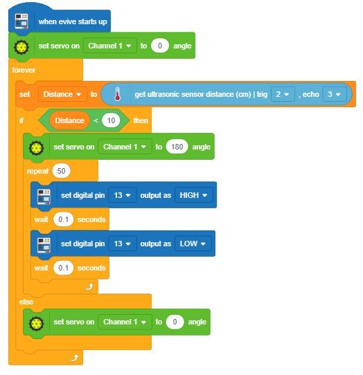

Step 12: Writing the Code
To make the programming of the code even simpler, we will write the code in PictoBlox.
- The program starts executing as soon as evive starts up.
- By default the innocent face will be facing us, thus set the default angle to 0 degrees.
- Now, if the distance measured by the ultrasonic sensor whose trigger and echo pin are connected to Pin 2 and 3 of evive is less than 10.Then the servo should turn 180 degrees and the scary face should be facing us.
- We will blink the LEDs 50 times with a small delay time.
- Then for by default, it should set the servo back to normal.
