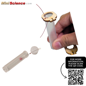

Step 1: INDUCTOR
Remove the diode from its container and place it in a safe location. The container will be repurposed to create the inductor.

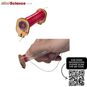

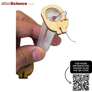

Step 2: INDUCTOR (coil Holder)
sing the container and the coil holder,
a. insert a long piece of wire (about 4 inches) into the holes of the coil holder, starting from the open section of the container.
b. Leave 3 inches of wire inside the container as extra, and then use the other end of the wire to start wrapping it tightly around the container to form the inductor.
Step 3: INDUCTOR (Wrap the Wire)
Wrap the wire around the cylindrical container as tightly and neatly as possible until the entire coil is wrapped. Don’t worry if it’s not perfect. Leave about 4 inches of wire at the end to secure it in the coil holder.

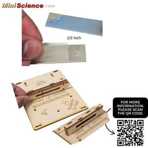

Step 4: VARIABLE CAPACITOR
Using the 2 aluminum electrodes, remove the blue protective film, and then use tape to cover both sides of the electrodes, leaving about 1/2 inch exposed to connect the alligator clip
Assemble and attach the variable capacitor structure to the base as shown in the pictures. Sand the wood if necessary to ensure a proper fit..

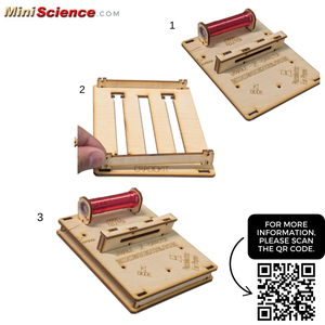

Step 5: ASSEMBLE THE STRUCTURE
Place the inductor in the designated area and then assemble the radio support structure as shown in the images

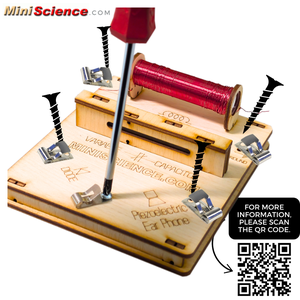

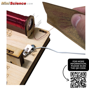

Step 6: ASSEMBLE THE CIRCUIT (Screw the Fahnestock Clips)
Screw the Fahnestock clips into the designated holes. You can attach the antenna and ground wire either to the screws or directly to the clips.

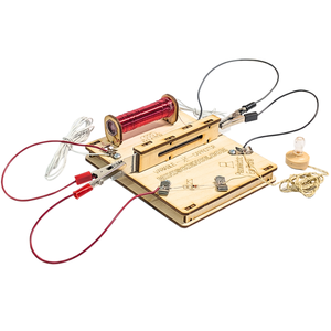

Step 7: ASSEMBLE THE CIRCUIT
Sand the terminal ends of the inductor coil wire and attach them to the antenna and ground Fahnestock clips. If desired, the antenna and ground can also be secured directly to the screws of the clips for better adjustment.

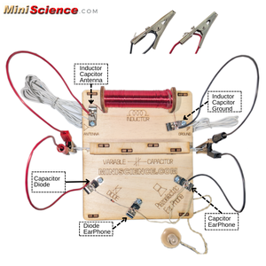

Step 8: ASSEMBLE THE CIRCUIT (end)
Connect the 2 black wires and 2 red wires to their respective alligator clips. Attach each alligator clip to the 1/2-inch non-insulated section of each aluminum electrode. Place the electrodes inside the variable capacitor box, and finally, follow the connection diagram in the pictures to complete the circuit.
