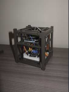

Step 4: CubeSat Structure Prep
For the CubeSat structure, I 3D printed an open-source 1U CubeSat model from Thingiverse:
🔗 CubeSat 1U Model by RobotFreak
I printed the parts using standard PLA filament with 15% infill and a 0.2 mm layer height for a solid yet lightweight frame.
Post-print Adjustments:
The printed holes for the standoffs were slightly undersized, so I used a small drill bit to widen the holes on the top and bottom plates. This allowed the M3 standoff tips to fit properly.
Step 5: CubeSat Structure + Assembly
Assembly Steps:
  1. Mounted the Breadboard: I placed the breadboard directly on the bottom plate, ensuring it sat flat and stable
  2. Installed the First Layer of Standoffs: Using M3 screws and standoffs, I built up the height above the breadboard to make space for the next layer of components.
  3. Added the Inner Mounting Plate: I placed one of the inner support plates above the standoffs and mounted the Arduino on it.
  4. Built the Top Layer: After wiring everything, I added a second set of standoffs and then attached the top plate, completing the layered cube structure.
  5. Attached the Side Panels: I snapped the two side walls into place and secured them using screws and nuts from the inside to ensure a tight, durable fit.
  6. Organized the Wiring: I gently wove the sensor wires through the frame openings, keeping all connections within the structure for a clean, contained design.
