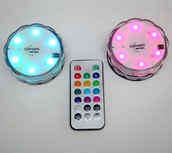

  • One of the Kan-Jam Illuminate lights. If you can't get a hold of one get a LED puck light (preferably 7cm in diameter)

Slide in lithophane and light. You can use the remote to control the colors.
