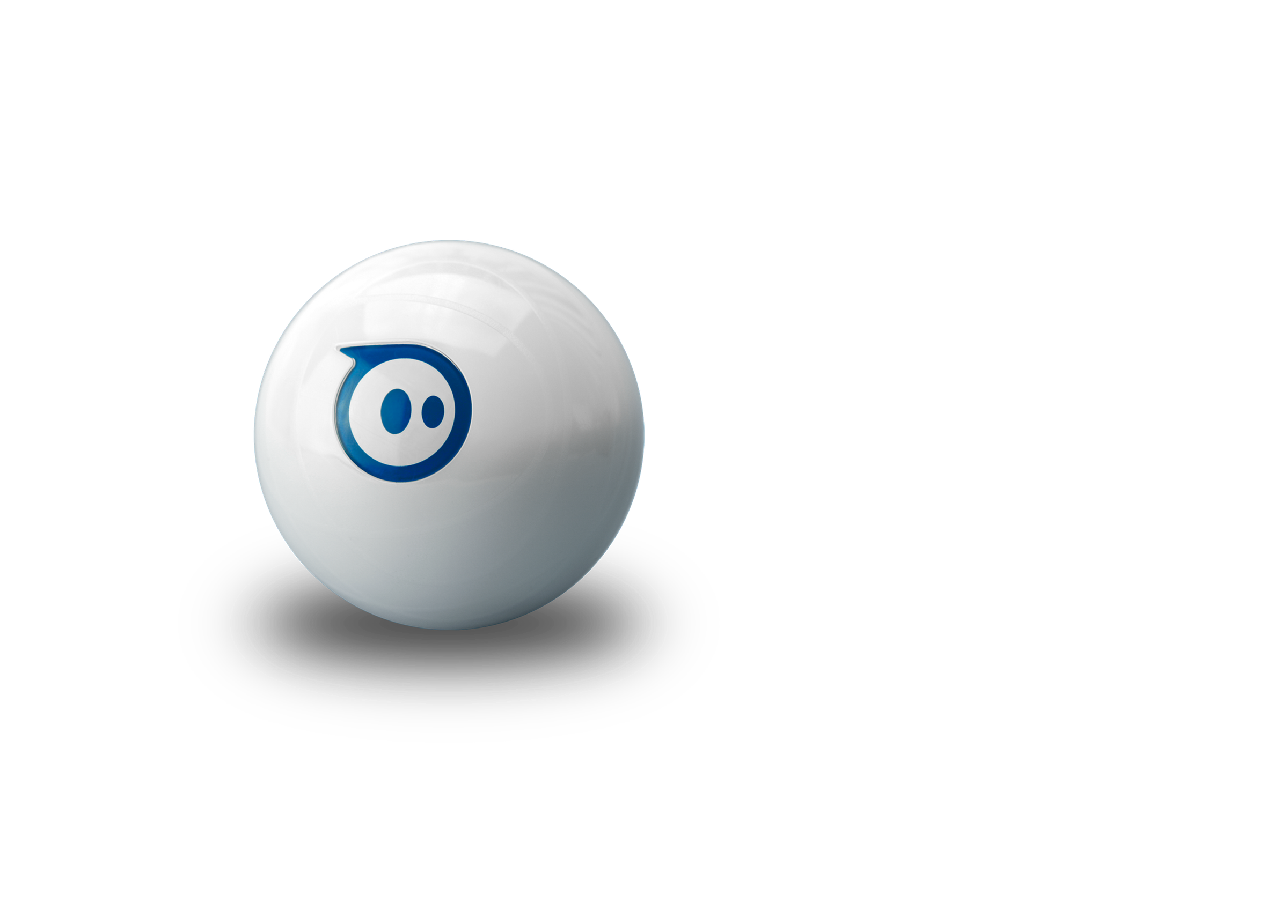

Step 1: Step One: Get on Your Gloves and Grab Your Sandpaper
Possibly the easiest step here. This step is to make the paint "bite" or stay into the plastic shell of the ball. All you need to do is sand the surface of your Sphero. You have accomplished your goal when the gloss of the original is now dull or flat. It will look similar to the picture here. Now that that is done, wash the Sphero to remove any sanded debris, then dry and move to the next step.
