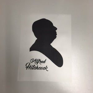

Step 3: Load the Transparency
I placed the transparency film in my printer so that the image would print on the textured side (textured side allows the ink to absorb and dry on the transparency). These transparencies are included with the EZScreen kit.
Step 4: Super Dark Transparency
You want to make sure the transparency is as dark as possible. I printed mine on high quality settings. I let the transparency dry completely for about 2 minutes.

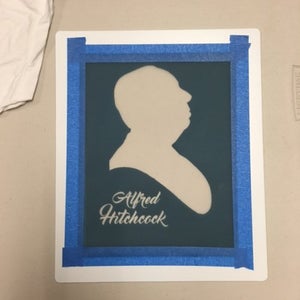

Step 12: Attach to Plastic Frame
I bought the plastic frame from EZScreenPrint, and attached the stencil using blue painters tape.
Step 13: Align
After inserting a piece of cardboard inside the shirt (to prevent the ink from seeping through), I aligned the stencil on the t-shirt.
