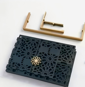

Step 2: Laser Cutting
Place your 3mm plywood sheet securely in the laser cutter. Align the design file precisely on the material. Set the parameters for cutting: Speed: 450mm/min, Power: 90%, Air Assist: On.
Run the job to cut out all pieces—the base, four side walls, and the lid. If your machine's work area is smaller, divide the file into multiple passes to avoid errors.

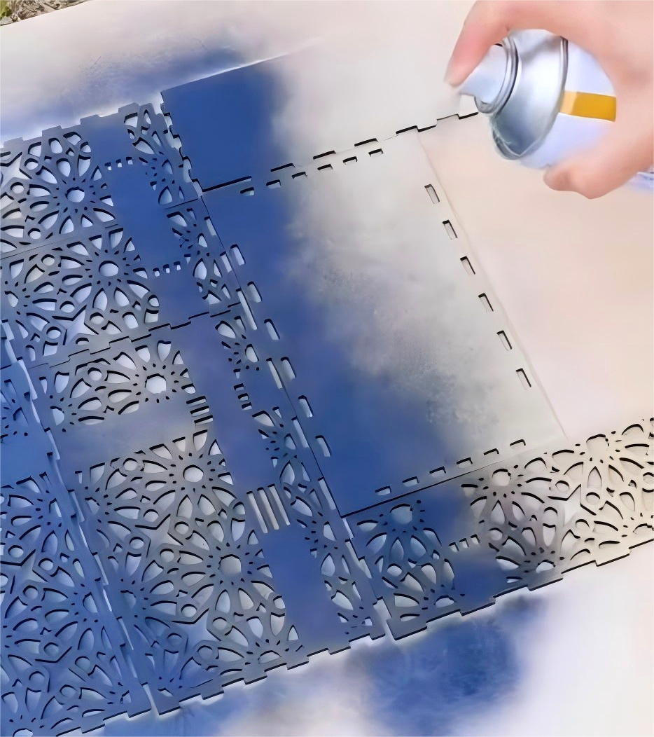

Step 3: Coloring
Once cut, lightly sand any rough edges with sandpaper for a smooth finish. Paint the pieces before assembly to keep things neat: Apply a base coat of natural black wood stain or light color to the exterior. Let everything dry completely (about 1-2 hours) to prevent smudges during handling.

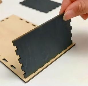

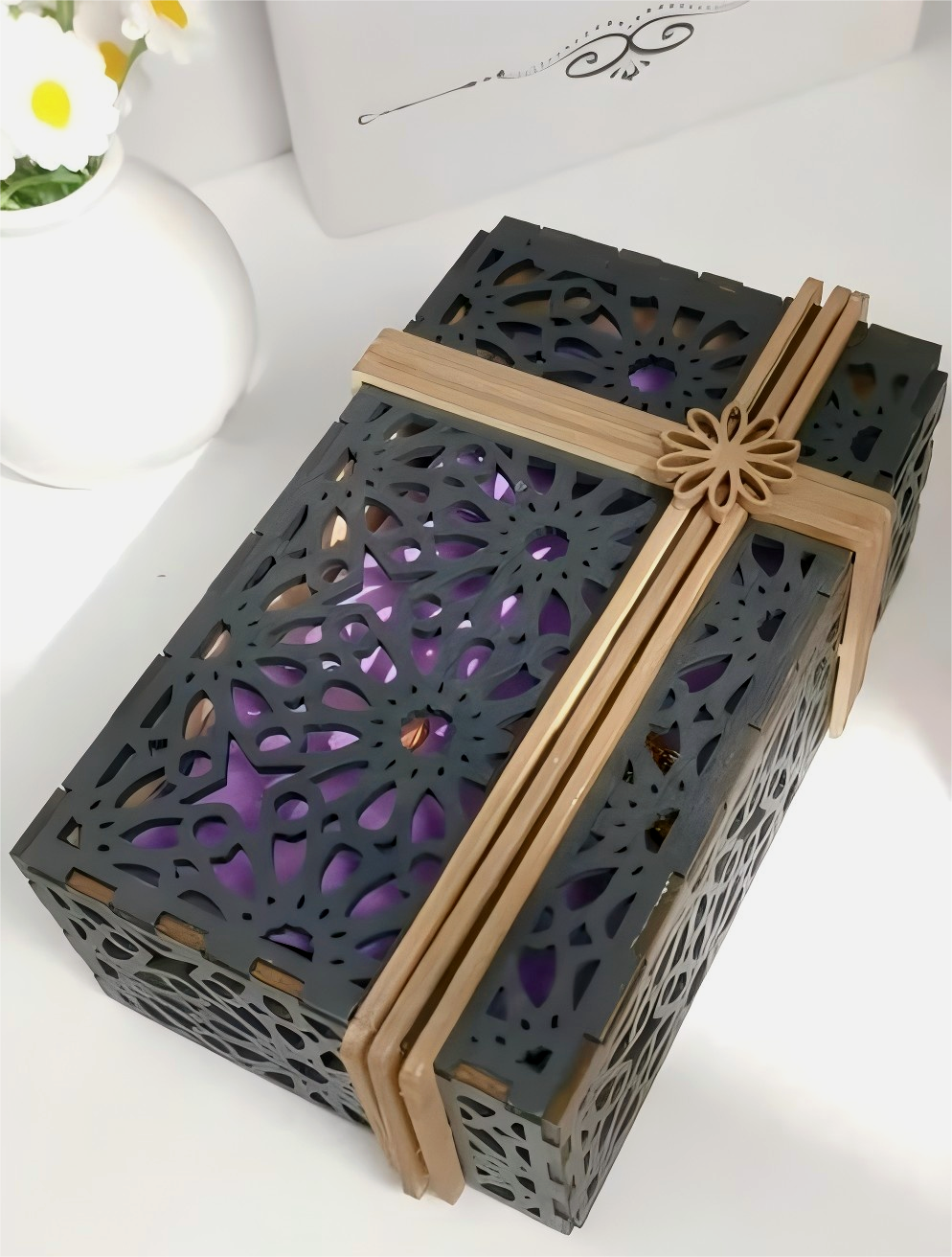

Step 4: Assembling
Begin by gluing the side walls to the base, forming a sturdy rectangular structure—ensure the grooves for the sliding lid align perfectly. Use wood glue sparingly on joints for a clean look, and clamp lightly while drying for about 30 minutes. This creates a seamless, functional box ready for gifting.
