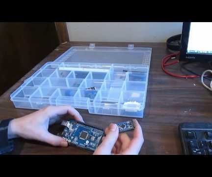

Step 1: If You Prefer a Video Here It Is
text
Step 2: Get All the Parts
You need,
1 Arduino board, I used the pro mini
1 dht sensor I used the dht 22
1 10k resistor
1 SD card or micro SD card with matching board
3 feet on wire
3 wire cable (you will use this to connect your dht sensor to the arduino)
if you are using a pro mini you need the stuff to program it, I have a video on how to program one with out a usb to serial adapter you can find it here or you can check out my Instructable on it
Stuff to solder
