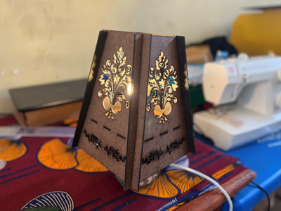

Transform a simple sheet of hardboard into a beacon of intricate beauty with this comprehensive guide to creating a laser-cut Arabesque Lantern. This project is a perfect marriage of modern fabrication and timeless design, resulting in a stunning decorative piece that casts a warm, ambient glow through its ornate, gilded patterns.
More than just a lamp, this project is an exploration of technique. You will learn how to turn a precise digital design into a physical object, elevate a humble material with shimmering metallic and colored inlays, and master a clever fabric hinge technique that ensures a clean, professional assembly without complex joinery.
Whether you are a seasoned maker looking for your next captivating project or an ambitious beginner ready to create something truly impressive, this instructable will guide you through every step. Prepare to turn a flat board into a three-dimensional masterpiece of light and shadow.

Step 1: DESIGNING IT!
  1. Create the Panel Shape: The lamp consists of four identical trapezoidal panels. Design one panel in your vector software. The angle of the sides will determine the final taper of the lamp. A slight angle, as seen in the image, creates an elegant, stable base.
  2. Incorporate the Decorative Patterns:
  3. Find or create a vector file of an arabesque or floral pattern. The design in the image is a symmetrical, ornate floral motif.
  4. Position the main pattern in the upper-middle section of your panel.
  5. Add the lower horizontal detail—a simple vine or leaf pattern works well.
  6. Add Assembly Slots: Notice the small rectangular slots near the bottom of the panels. These are for a base plate to lock into. Design a square base plate with corresponding tabs that will fit snugly into these slots. Remember to account for the laser's kerf (the amount of material removed by the laser) for a tight fit. Add a central hole in the base for the lamp cord.
  7. Finalize the Cut File: Arrange the four panels and the base plate on your artboard, color-coding the lines for cutting and (if desired) engraving. Ensure all paths are closed and there are no overlapping lines.

Please export your file from the CAD software to the laser cutting software and ensure it is properly prepared. I am utilizing a 60W C02 laser cutter, and the settings I have configured are as follows: Power set to 55% and Speed set to 7 mm/s.

Step 4: ASSEMBLING IT!
1. Prepare Your Workspace: Begin by clearing a surface where you can work comfortably. Make sure you have all necessary tools within reach, including a mallet, the side panels, and the middle piece.
2. Secure the First Three Sides Panels: Take the first three side panels and position them securely in their designated spots. Use screws or brackets to attach them, ensuring that you leave one end open for the insertion of the middle piece. Double-check that the panels are level and aligned properly.
3. Insert the Middle Piece: Once the first three panels are secured, carefully take the middle piece and line it up with the open end. Gently slide it into position, making sure it fits snugly but not too tightly. It should be seated properly without forcing it in.
4. Use a Mallet to Tap into Place: With the middle piece in position, take your mallet and gently tap around the edges of the middle piece to secure it further. Use light taps, being cautious not to apply too much force. The goal is to ensure it seats evenly in the opening without distorting the shape or putting stress on the panels.
5. Insert the Last Side Panel: Now that the middle piece is loosely in place, it's time to fit the last side panel. Carefully insert it into the remaining open end, ensuring it aligns correctly with the first three secured panels and the middle piece.
6. Evenly hammer the Middle Section: With the last side panel in position, return to the middle section. Take the mallet again and start tapping it from all sides—top, bottom, and sides. Do this evenly to avoid any uneven pressure, which can lead to misalignment. Maintain a consistent, gentle force to ensure everything remains secure without being overly tight.
7. Final Check: Once all panels are in place, take a moment to inspect the entire structure. Ensure everything looks aligned and securely fastened. If necessary, make minor adjustments before finalizing the installation to achieve the best results.
By following these detailed steps, you’ll ensure that the assembly process goes smoothly and the structure is both secure and stable.
