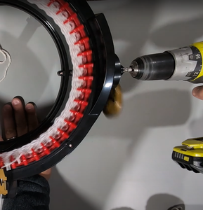

Once you get the first row done and the yarn secured into the machine, you can start cranking away to create the shape. I usually do a few rows by hand and then switch to a crank attachment and use a low powered drill to spin it around. I've made several fully by hand also and it's pretty quick.

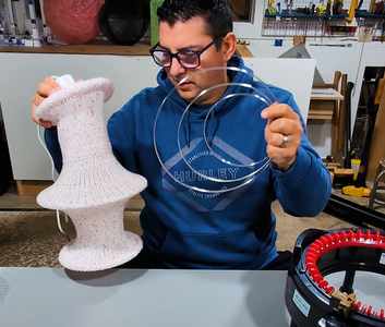

So the final product off this machine is basically a large sock shape. I knew that I could create some kind of inner form and stretch the knitted "sock" over it to create a cool shape. I used AutoCAD to mockup a variety of shapes and to figure out the approximate finished size of the pendant I wanted. I found some metal macrame rings that I thought I could use to insert into the tube and help create the final shape. I ended up using a 6" ring on top, 10" ring in the middle, and 8" ring on the bottom. The top and bottom rings were glued in with hot glue and the yarn was just rolled over the ring to hide it. The center ring was inserted into the middle before gluing the final end and is held in place by the tension of the fabric alone.
