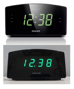

I started this project because my Philips AJ3400 FM Radio Alarm Clock stopped working. Initially I wanted to repair it but because of the integrated hardware this was not possible. Instead of throwing it away I decided to reuse the housing and some of its hardware to build my own Digital FM Radio Alarm Clock. I tried to keep the control for most functionality the same as the original Philips AJ3400 FM Radio Alarm Clock. Deviations from the original control was done because it felt more logical to change it.

I decided to reuse the following hardware from the original AJ3400:
  • Housing
  • Keyboard
  • Loudspeaker
  • Power Supply
The display of the original Alarm Clock is made with LEDs using a frame that separates the LEDs. These LEDs are – like the IC – integrated on the PCB. The following pictures show this. Initially I wanted to reuse the LED frame and create a 7-Segment display using separate LEDs but because of the non-standard spacing this was not an easy task to do so I decided to use standard – large – 7-segment displays. The design was initially made on a breadboard.
