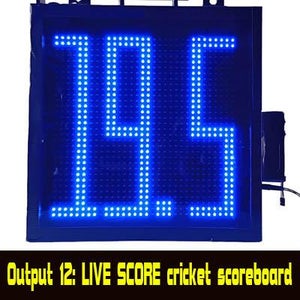

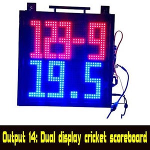

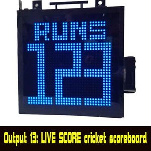

  2. Real-Time Cricket Scores Integration: For cricket enthusiasts, Scoreduino offers real-time integration with popular platforms like cricclubs.com and playhq.com(uses API). This means your scoreboard will automatically display live scores, eliminating the need for manual updates. Keep your audience engaged with up-to-the-minute scores, enhancing the overall experience.
The Scoreduino module is designed with adaptability in mind. It facilitates the creation of various scoreboards effortlessly, making it perfect for a wide range of sports and events. From general scoreboards featuring timers to specialized boards tailored for cricket, football, and tennis, the possibilities are endless.

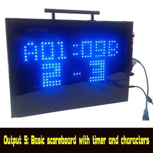

This tutorial shows how to build a basic scoreboard. This is just one example. Depending on the size, you can purchase the display modules and accessories to build other types of scoreboards as well.

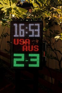

This tutorial is for basic single display soccer scoreboard. There are more than 30 possibilities, this is just one of them.

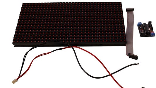

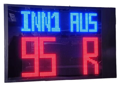

  1. 1 x P10 dot matrix display
  2. 1 x 16x2 pins IDC cable (included with the dot matrix display)
  3. 1 x Power cable(included with the dot matrix display)

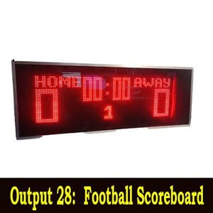

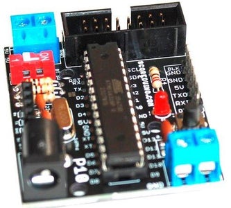

  4. 1 x Fully assembled SCOREDUINO-DMD module. 1 module-1 output, meaning each module provides only one output. Choose the output while placing the order. Option 2: Scoreduino module using Arduino Pro Micro
  5. 1 x HC-06 Bluetooth Module
  6. 1 x 5V 4A power supply
You will need one Android phone to operate the scoreboard. If you want unlimited operation range, then, you will need two Android phones, one works as a transmitter and the other works as a receiver.

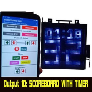

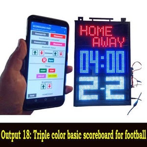

Step 1: PREPARE THE SCOREBOARD DISPLAY UNIT
You will see arrows at the back of the display: 1 or 2 arrows pointing upward and 1 or 2 arrows pointing to your right. Place the display on your table exactly as shown in the image.
  • Connect the 16x2-pin IDC cable to the LEFT IDC socket.
  • Connect the power cable to the VCC and GND terminals on the display board. The RED wire goes to the VCC pin, and the BLACK wire goes to the GND pin.
Step 2: CONNECT THE SCOREBOARD UNIT TO THE SCOREDUINO-DMD
  • Use a screwdriver to connect the power cable to the screw terminal of the SCOREDUINO-DMD module.
  • Plug the IDC cable into the IDC socket on the SCOREDUINO-DMD board.
  • Attach the HC-06 Bluetooth module to the SCOREDUINO-DMD board.
Step 3: Power Up the Scoreboard Display and Scoreduino Using 5V-4A Power Adapter
After the IDC cable and power cable are connected to the scoreboard, you can power up the SCOREDUINO-DMD module. You will see the output that you have selected while ordering the module.

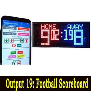

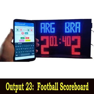

Step 4: Operate Using Scoreduino App for Soccer Scoreboard
To operate the scoreboard, follow these steps:
  1. Download the app. There are more than 20 apps built for different scoreboards. Users will be given a link to the correct app to operate the scoreboard of their choice.
  2. Go to your phone's settings and pair your phone's Bluetooth with the scoreboard's Bluetooth.
  3. Open the app and navigate to SCORE4 Basic.
  4. Connect your phone to the scoreboard's Bluetooth through the app.
  5. You can now operate the scoreboard. When you send commands, the scores will increase or decrease accordingly.
