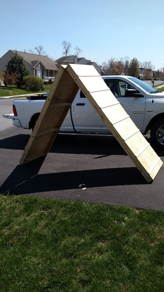

Step 3: Building the Box
The first step is to build a box.
Follow these directions twice, we're making 2 boxes.
Find a reasonably flat surface to build this on (just find anything that is "good enough"). I used my garage floor.
Step 1:
Take the 2 2x4s that you didn't cut and lay these parallel to each other. These 2x4s are 3" short of 8 feet, the world of wood measurements is not very intuitive! Anyway, lay the 36" boards above and below the 8' boards. Lay the 33" boards 32" from either end.
I used 2 1/2 inch deck screws to secure them. These should hold up to the elements, but feel free to use nails if you'd like.
with a pencil, mark the 8' board on the side in the middle of the 33" boards. This will be used to know where to screw the plywood to the cross members.
Step 2
Lay the 3'x8' plywood sheet on top of the frame you just built. I first drilled, then countersunk each hole, then drilled in a 2 1/2 deck screw into each hole. I could have used smaller screws but this allowed me to use one box. I did this about every 6 inches or so.
We had 2 drills setup, one with the drill bit the other with a hex plug so we could quickly drop in the countersink bit and then the drill bit. This made a tedious job more tolerable!
You can optionally fill the wholes with wood putty to prevent the dogs paws from getting caught, we just filed them with sandy paint (see next page).
Step 3
Sand! At this time we sanded down the corners and any chips from the screw holes. We did this before installing the molding as it was easier.
Step 4
Molding.
Measure about 4" in from one end and lay a piece of molding. Repeat this every foot. I used wood glue and then tacked each strip of molding down with 1 inch nails. The nails act like a clamp for the wood glue.
At this point, I made sure the molding didn't have any sharp edges but bringing out the sander.
Congratulations, if you repeated these instructions, you should have 2 halves of an A-Frame!

Step 5: Hardware
Now that our two sides are made, we need to join them, and secure them when they're spread out.
Step 1
Lay the sides so that the rough panel sides are on the bottom and top. Picture opening the A-Frame and seeing only the frames inside. If you do this backwards, it won't be a very successful A-Frame!
Step 2
Shim a gap between the top of the A-Frame. This will give the hindges/frame space to open and close. I just used scrap wood for this.
Step 3
Fasten the two hinges to the A-Frame. This one I used some 1 inch screws that I had laying around. Feel free to use the 2 1/2 if that's all you have, note that they'll be poking through the frame side of the A-Frame and won't impact the dog in any way.
Step 4 Adding the chain bolts
At this point, I kept the frame laying on the ground while I drilled the holes for the bolts. I drilled the whole, opened the frame like an alligator's mouth, and put the bolts on. I suppose I could have used washers at this point. Feel free to do that if you so choose.
Make sure you put the hook side of the bolts on the interior of the frame. Don't worry about the leftover bolt length, we'll take care of that later.
Step 5
Measure out both chains and attach them to the hooks, one on each side. I did this as we stood up the frame. Standing up the frame/moving it is definitely easier with 2 people. Make sure whatever angle you want to achieve, the chain is pretty taught. You don't want the frame moving/giving as the dogs jump on it.
Step 6
All important! Dremel the excess bolt! The last thing you want to do is catch yourself or the dog's leash (if you're just starting out, you'll probably have the leash on for a couple runs) on the extra bolt. Once that's cut off, there is very little overhang of the bolts.
At this point, the frame is almost done!
