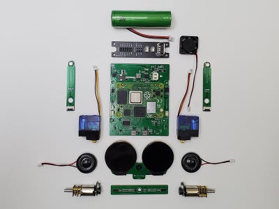

Hardware components
  • Raspberry Pi Compute Module 4×1
  • Custom Motherboard
  • Custom Eye module
  • Custom Bumper module
  • Arm module
  • Charge module
  • 270 degree servo
  • N20 motor
  • Speaker 2W 23mm x2
  • Fan 2006
  • 3D printed parts
  • M1.6 x 3mm countersunk head screw ×4
  • M2 x 5mm countersunk head screw ×2
  • M2 x 5mm flat head screw ×2
  • M2.5 x 16mm pah head screw
  • 2 x 5 mm self tapping countersunk head screw ×6
  • 2 x 10 mm self tapping countersunk head screw×2
  • 2 x 20 mm self tapping countersunk head screw×2
  • 1.7 x 4 mm self tapping countersunk head screw×4
  • 1.7 x 4 mm self tapping washer head screw
  • 2 x 6 mm self tapping pan head screw×9
  • 2 x 4 mm self tapping pan head screw×1
  • 2 x 10 mm self tapping pan head screw×2
  • ID4mm OD8mm 0.5mm washer×4
  • M2 x 4 x 8mm round spacer×2
  • M2 x 4 x 8mm hexagon spacer
  • 0.5 pitch 8 pin 110mm FPC×2
  • 0.5 pitch 8 pin 40mm FPC×2
  • 0.5 pitch 40 pin 80mm FPC×1
  • 0.5 pitch 20 pin 60mm FPC×1
  • 0.5 pitch 12 pin 50mm FPC×1
  • Phosphor Copper Sheet C5191 0.2mm×1
  • Screen protector 35mm×2
  • Neodymium Magnet 5mm x 2mm×1
  • IMX219 Camera×1
  • 18650 Battery×1
  • Round LCD 240x240×1
  • Encoder magnet OD 7.65 mm, ID 1.0 mm, 12 CPR×4

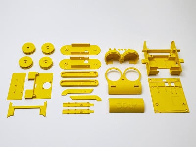

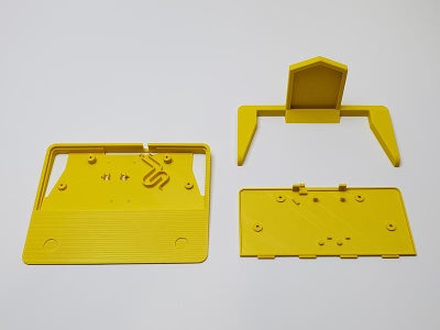

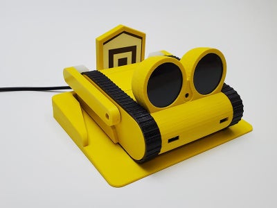

Step 1: 3D PRINT
All STL files are located in here. An FDM 3D printer is required for files that begin with "FDM". An SLA 3D printer is required for files that begin with "SLA".
It is easy to print with PLA, however I recommend printing a heat-resistant filament like PETG or ABS for the bottom lid.
Preferring a translucent resin for hands will give better results for hand lights.

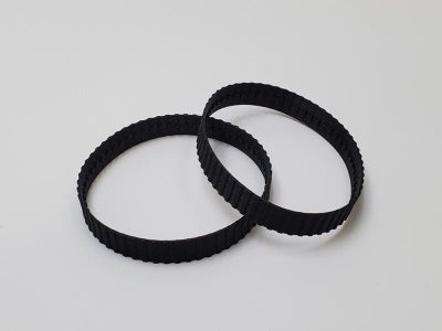

Tracks printed with NinjaFlex 85A TPU

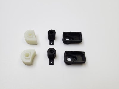

Step 2: PREPARE PARTS

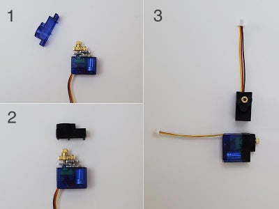

Customize servo
  1. Remove bottom lid.
  2. Desolder cables.
  3. Solder 3 pin 1.0 mm pitch 60mm length cable.
  4. Close bottom cover.
  1. Remove top cover
  2. Secure SLA printed cover with screws
  3. Customized servo completed

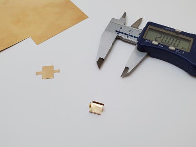

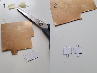

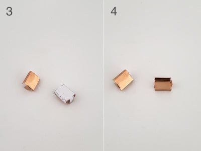

Charge Connectors
  1. Print attached connector drawing with 1:1 scale
  2. Paste printed paper to Phosphor Bronze sheet with double sided tape
  3. Cut from outer edges
  4. Bend edges as shown
  5. Remove tape and paper

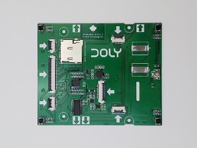

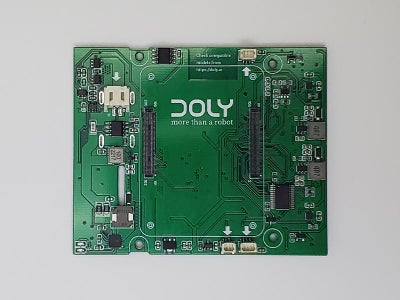

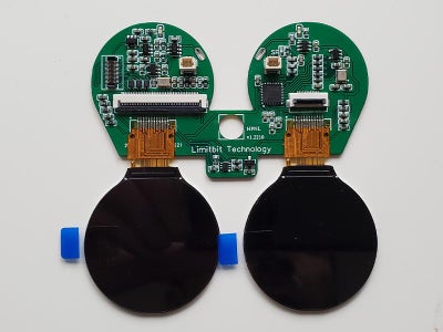

PCB Design
Designing electronics was not easy due to chip shortages. There is a high chance that you can find listed electronics. However, sometimes you will find components with a different package. If you would like to do it by yourself, you can access the schematics, Gerber files and BOM files from link.

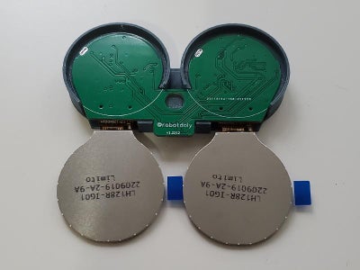

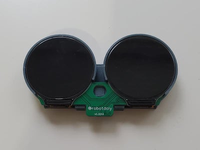

After electronic components are placed on PCB you have to align LCD to Eye PCB with help of 3D printed aligner which is located at link as "LCD_aligner.STL".
* Place eye PCB into aligner as shown.
* Bond LCD to PCB with a double sided tape.
* Remove LCD cover plastics.
* Apply screen protector glass.
Step 4: ASSEMBLY
This video series will show you how to assemble the DIY Doly robot.

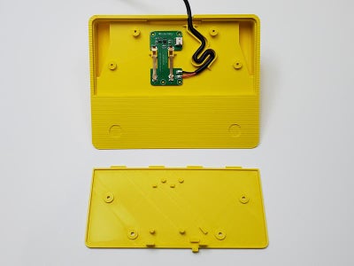

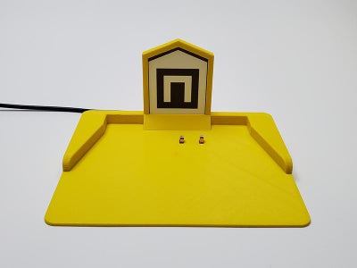

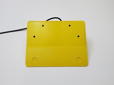

Step 5: CHARGING DOCK
3D Print & Assemble
Once you have printed the 3D parts, you will need to assemble the charger board. The schematics and component list (BOM) are located at this link.
When all 3D printed parts are ready,
  • Apply glue carefully to both the top and bottom surfaces.
  • Make sure the glue is kept away from the edges.
  • Ensure that the part is aligned properly.
  • Secure the top side to the bottom side.
  • Install the charger module and secure the bottom lid with four screws after a few minutes.
