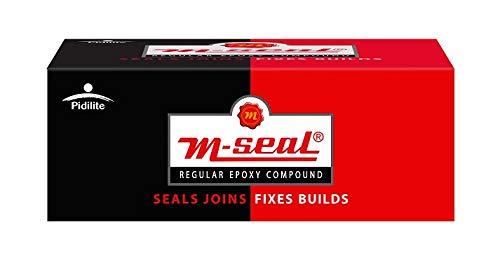

- M-seal epoxy

Step 3: Epoxying ...
Using m-seal epoxy, the nut [from the VGA connector] is glued in its place.
With this, our drag knife cutter is complete. Now we only need to fasten a cutter blade onto it with the help of screws and finally attach it to a CNC machine.
